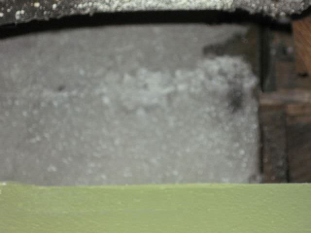

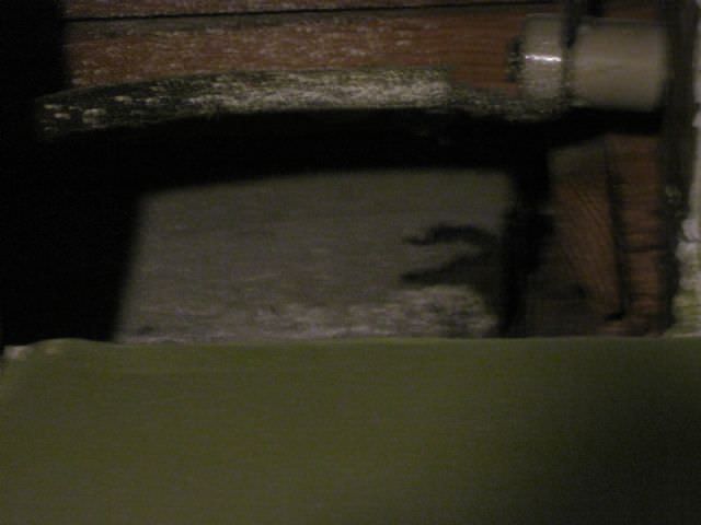

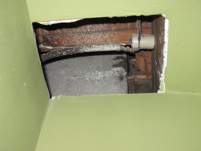

greyboy39 Posted May 5, 2010 Report Share Posted May 5, 2010 Wondering if this asbestos? Its wrapped around a heating duct in a house built in 1914? Click to Enlarge 29.62 KBif thi Click to Enlarge 27.63 KB Click to Enlarge 38.01 KB Click to Enlarge 30.87 KB Quote Link to comment Share on other sites More sharing options...
Stephen D. Gazo Posted May 5, 2010 Report Share Posted May 5, 2010 You gotta get give some better pics...The only true way to know is sending it to a lab. Do not disturb it. are there any concerns with that old Knob and Tube shown... Quote Link to comment Share on other sites More sharing options...
caryseidner Posted May 5, 2010 Report Share Posted May 5, 2010 I can't tell from the photos either, but I have seen asbestos wrapped around supply ducts many times in houses that age. Quote Link to comment Share on other sites More sharing options...
Bill Kibbel Posted May 5, 2010 Report Share Posted May 5, 2010 Asbestos, possibly? Asbestos, likely. Quote Link to comment Share on other sites More sharing options...
Les Posted May 5, 2010 Report Share Posted May 5, 2010 Asbestos usually. ps: asbestos is always possible. Quote Link to comment Share on other sites More sharing options...
greyboy39 Posted May 5, 2010 Author Report Share Posted May 5, 2010 What are the best ways to seal this stuff in, as you can see in the pics there are some spots where it has peeled away over the years and those areas are likely friable.A spray paint possibly? My concern is when the heating or cooling is rolling up through ducts it might be creating a vacuum to where it is sucking the friable material into the duct and distributing the fibers throughout the entire house.These old heat ducts aren't exactly air tight, and show small gaps to where you can see the material from the inside of the duct. The ducts in the basement are new, it looks like the old ducts in the walls of this two story are the ones wrapped with this stuff.Are there any insertable sleeves that can be retrofitted into the ducts to seal them up tight? The duct runs look to be straight shots from the basement to the top floor, if that helps. No, there is no concern with the knob and tube the house was completely rewired in 2005. Quote Link to comment Share on other sites More sharing options...
