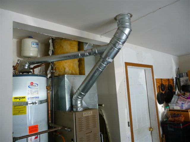

Robert Jones Posted August 2, 2010 Report Share Posted August 2, 2010 This water heater flue pipe looks a bit flat to me. It does have a slight rise to meet the furnace flue, but just seem's flat. Opinions? Click to Enlarge 39.42 KB Quote Link to comment Share on other sites More sharing options...
Jim Katen Posted August 2, 2010 Report Share Posted August 2, 2010 Looks fine to me. - Jim Katen, Oregon Quote Link to comment Share on other sites More sharing options...

Jim Katen Posted August 2, 2010 Report Share Posted August 2, 2010 The minimum slope is 1/4" per foot. Quote Link to comment Share on other sites More sharing options...
Marc Posted August 2, 2010 Report Share Posted August 2, 2010 Isn't there supposed to be a minimum rise of 1' above the draft hood on the water heater vent before the first offset? Marc Quote Link to comment Share on other sites More sharing options...
Bill Kibbel Posted August 2, 2010 Report Share Posted August 2, 2010 For a cat I vent connector, the minimum slope is 1/4" of rise for each foot of length. Isn't there supposed to be a minimum rise of 1' above the draft hood on the water heater vent before the first offset?It's suggested by some water heater manufacturers, but not a requirement. Quote Link to comment Share on other sites More sharing options...
Brandon Whitmore Posted August 2, 2010 Report Share Posted August 2, 2010 Isn't there supposed to be a minimum rise of 1' above the draft hood on the water heater vent before the first offset? I've made the decision to write up the lack of a 12" rise before the first elbow, which we recently discussed on another thread. Read this: http://www.inspectionnews.net/home_insp ... _elbow.pdf Quote Link to comment Share on other sites More sharing options...
hausdok Posted August 2, 2010 Report Share Posted August 2, 2010 My memory of that rule is that there is a minimum 12-inch to first bend requirement when the flue is going to discharge into a masonry flue but that there is no such requirement if it's a contiguous metal flue from bottom to top. What is Harper's code cite? ONE TEAM - ONE FIGHT!!! Mike Quote Link to comment Share on other sites More sharing options...

Jim Katen Posted August 2, 2010 Report Share Posted August 2, 2010 Isn't there supposed to be a minimum rise of 1' above the draft hood on the water heater vent before the first offset? I've made the decision to write up the lack of a 12" rise before the first elbow, which we recently discussed on another thread. Read this: http://www.inspectionnews.net/home_insp ... _elbow.pdf What would you use as a reference if challenged? Manufacturers' instructions, as far as I can tell, vary widely on this particular point. Oregon hasn't adopted the National Fuel Gas Code. We use the IRC tables (which come from the old AGA tables) and they don't mention the initial rise above the draft hood. Am I missing something? - Jim Katen, Oregon Quote Link to comment Share on other sites More sharing options...

Jim Katen Posted August 2, 2010 Report Share Posted August 2, 2010 Am I missing something? I don't remember, because it has been a while since I looked into this one. I don't quote code on this specific issue, so I don't have a specific cite. I debated this one over on IN several times, looked into it myself, and formed my own opinion. It just seems like there is less chance for exhaust spillage if there is some rise before an elbow............. I could be wrong. You're clearly correct in that there will be less spillage if there is an initial rise. However, just about every water heater will produce some spillage just after ignition. So it becomes a matter of degree. If there are signs of chronic long-lasting spillage, and chronic long-lasting spillage always leaves signs, then it's an easy call to recommend improving the venting to eliminate the spillage. (Though I wouldn't identify the initial rise as the source of the problem. The entire venting system would need to be considered.) However, if there are not signs of spillage, why recommend a change if there's no standard to back you up? What will be the benefit? To reduce the initial spillage from 8 seconds down to 5 seconds? Indeed, if increasing the initial rise decreases the angle of the vent connector, the prescription might make things worse. The only time I might mention it is when the installation is brand new and there aren't signs of past performance. Then I might suggest that they check the manfuacturerer's instructions to make sure that an initial rise isn't required. I might also recommend improving it if the water heater were *in* the living space -- a rarity in our area. - Jim Katen, Oregon Quote Link to comment Share on other sites More sharing options...

Hearthman Posted August 3, 2010 Report Share Posted August 3, 2010 The 12" vent rise minimum is referring to the GAMA tables, which are used in both NFPA 54 and the IFGC tables. These vent tables start at 12" because that is the generally accepted minimum vent rise recommended. You still need to run the calculations for sizing the vent connector as well as the common vent. Is that 4" B-vent on a 3" collar? All B-vent *should* have draft hood connectors to single walled pipe or appliance collars & draft hoods, though it is rarely done. The B-vent in this example is improperly supported: elbow off the draft hood, the horizontal run to the manifold, the run from the furnace to the manifold and the common vent elbow before the ceiling firestop assy. The ANSI Stds allow up to 10 min. of flue gas spillage. Doesn't make it smart but that is the std. Are the WH and furnace rated for an alcove installation? The air being disturbed from cars and activities in that garage can cause considerable flame distortion> CO production. I would not laugh at CO in a garage. Since most houses are under depressurization in winter, the CO will infiltrate into the home. This happens through gaps in the walls but it can also permeate drywall. All this was proven back in the '90s in Minn. using tracer gas studies and blower doors. Is the return properly sealed using a mastic listed to UL 181 a/b-FX for the first 10 feet back from the appliance? Anymore pics? HTH, Quote Link to comment Share on other sites More sharing options...

Hearthman Posted August 3, 2010 Report Share Posted August 3, 2010 Sorry Marc, no you can attach B-vent 'directly' to an appliance collar but having said that, you really should use the listed draft hood connector instead of trying to screw a std. section of B-vent to the collar. I see them all the time where the collar or B-vent get damaged or deformed. Much less likely with the draft hood adapter that was made for that purpose. Hope that clears it up. Quote Link to comment Share on other sites More sharing options...

Jim Katen Posted August 4, 2010 Report Share Posted August 4, 2010 Thanks for a most informative post. I am converted. Jim, Will you start writing this up all of the time, or just under certain circumstances? I don't like being the only one writing this stuff up......... I'll be looking at it every time. What I write will depend on what I see. If I see that it's a fairly recent water heater, I'll recommend a proper connector and a proper connector rise along with full review of the venting. If it's a fairly recent water heater and there's no room for a proper initial rise, I'll recommend relocating the water heater so that it can be properly vented. If it's an old water heater, and there are no signs of spillage, I'll recommend installing proper venting when the water heater is replaced. If it's an old water heater and there are signs of spillage, I'll just recommend replacing the entire water heater as well as the venting right away. While I agree that CO spillage in a garage is not a good thing, I believe that CO spillage inside the house is a worse thing. In general, my recommendations will be more conservative when the water heater is located inside the house. Of course there are probably several other parameters that might pop up to affect how I report it. - Jim Katen, Oregon Quote Link to comment Share on other sites More sharing options...
