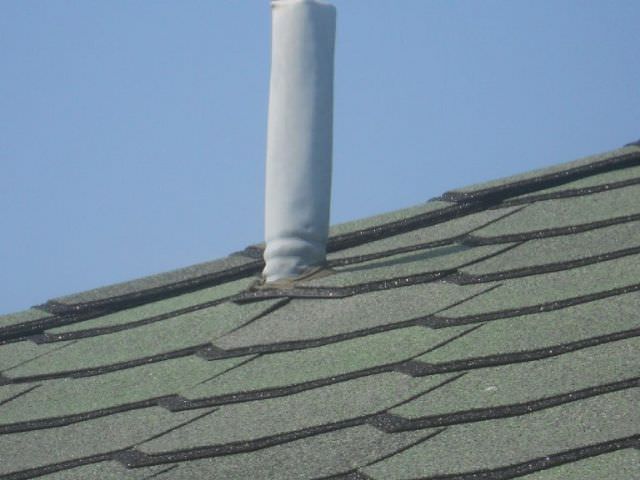

mgbinspect Posted August 18, 2010 Report Share Posted August 18, 2010 Greetings earthlings. Got a question for the TIJ brain-trust: Did a beauty of a home on the the Chesapeake Bay today Click to Enlarge 50.89 KB with a priceless master bedroom balcony view: Click to Enlarge 47.68 KB But, the roofing shingles completely surrounded the plumbing vent collar. Usually I write this up as amateur work. In this case, however, I find myself wondering if this isn't a deliberate practice in hurricane prone coastal areas. Anyone familiar with this setup? Click to Enlarge 41.58 KB I'd prefer not to write it up if it's actually a good thing. I'll be working on this one for a while. All insights welcome and appreciated. Got another to post regarding the roof as well. Quote Link to comment Share on other sites More sharing options...

mgbinspect Posted August 18, 2010 Author Report Share Posted August 18, 2010 There's a class of roofing contractor that believes that flashing is ugly and that there's no harm in completely covering all flashing with shingles and sealing it with roofing cement. I write these up because flashing is often galvanized steel and if you don't allow for water to escape and evaporate quickly, it will begin corroding in just a few days. I learned this long ago when I left some newly purchased V-crimp roofing in an open trailer for a few days before starting the job. It had rained early on and when I removed the first sheet, the one below it had the beginnings of rust. The lumber yard confirmed this when I related the incident to them. Marc The waviness of this pipe has me thinking it's copper and may actually have flashing soldered right to the pipe under the roofing. Anyone seen that? Quote Link to comment Share on other sites More sharing options...
Chad Fabry Posted August 18, 2010 Report Share Posted August 18, 2010 It's lead and if I did the roof it's how I would do it...you don't need to see the flashing for it to be lapped properly. I think this is the only point on which Jim Katen and I disagree. Quote Link to comment Share on other sites More sharing options...
mgbinspect Posted August 18, 2010 Author Report Share Posted August 18, 2010 It's lead and if I did the roof it's how I would do it...you don't need to see the flashing for it to be lapped properly. I think this is the only point on which Jim Katen and I disagree. Thanks, Chad! Am I right to assume it may have flashing soldered to the pipe under the roofing, or is it simpy depending on sealant? Quote Link to comment Share on other sites More sharing options...
Brandon Whitmore Posted August 18, 2010 Report Share Posted August 18, 2010 It looks like a one piece lead flashing jack, and there will be flashing placed beneath the shingles. It's wrong............ It's not as wrong if the flashing is just barely lapped by the shingles below as a decorative cover. So basically, if the shingles are trimmed the way they should be, the flashing should look just right. Quote Link to comment Share on other sites More sharing options...
Chad Fabry Posted August 18, 2010 Report Share Posted August 18, 2010 See...Brandon disagrees with me too. My contention is if the flashing is properly lapped, why must I be forced to look at it? Quote Link to comment Share on other sites More sharing options...
mgbinspect Posted August 18, 2010 Author Report Share Posted August 18, 2010 See...Brandon disagrees with me too. My contention is if the flashing is properly lapped, why must I be forced to look at it? I agree with you, Chad, as long as there is a soldered flange on there so the sealant isn't the Achilles heel of the affair. Quote Link to comment Share on other sites More sharing options...
Brandon Whitmore Posted August 18, 2010 Report Share Posted August 18, 2010 See...Brandon disagrees with me too. It's not that I disagree with you Chad, it's that the manufacturers do......... OK fine, I do as well. I don't like to see water trapped between the layers. A good plumber could always just join most, if not all of the vent pipes, and run the stack through at/ near the ridge. Then, I wouldn't care much what was done at the termination. Quote Link to comment Share on other sites More sharing options...
inspector57 Posted August 18, 2010 Report Share Posted August 18, 2010 Thanks, Chad! Am I right to assume it may have flashing soldered to the pipe under the roofing, or is it simpy depending on sealant? It is a one piece lead flashing that is not dependent on sealant, the lead is simply folded down inside the top of the stack and lapped properly under the shingles for a proper installation. NO SEALANT is needed except maybe a dab on exposed nail heads on the down hill side unless they are covered by shingles. http://www.alibaba.com/product-free/291 ... readcrumbs Quote Link to comment Share on other sites More sharing options...
mgbinspect Posted August 18, 2010 Author Report Share Posted August 18, 2010 Thanks, Chad! Am I right to assume it may have flashing soldered to the pipe under the roofing, or is it simpy depending on sealant? It is a one piece lead flashing that is not dependent on sealant, the lead is simply folded down inside the top of the stack and lapped properly under the shingles for a proper installation. NO SEALANT is needed except maybe a dab on exposed nail heads on the down hill side unless they are covered by shingles. Thanks, Jim! Based upon the look of it, that makes sense. I'm comfortable with that. Quote Link to comment Share on other sites More sharing options...

John Kogel Posted August 18, 2010 Report Share Posted August 18, 2010 Googled 'lead roof jack' and got this. Click to Enlarge 19.98 KB Done right, the lower part of the lead apron laps over the lower shingle so it is visible. No nails go into the lower portion of the jack. Then any water that gets in around the stack should stay up on the surface and flow out onto the shingles below. The way they did it is pretty but not correct. They don't know jack. [] Will it leak? Probably not, provided there are no nails in the area below the stack. Can't see if there are any nails through those lower shingles into the jack. That would be potential leaks. So my vote -Keep it caulked or fix it. Quote Link to comment Share on other sites More sharing options...
mgbinspect Posted August 18, 2010 Author Report Share Posted August 18, 2010 I was a little late adding the link that has a pretty good picture of the raw product. Hey thanks all! This has been very educational. I've seen this setup on tons of flat roofs in the city, (and actually didn't make the connection) but have never seen the product before installation. I'm satisfied that it's fine - in fact, in this environment, beyond fine - smart. Quote Link to comment Share on other sites More sharing options...
Jim Katen Posted August 18, 2010 Report Share Posted August 18, 2010 It's lead and if I did the roof it's how I would do it...you don't need to see the flashing for it to be lapped properly. I think this is the only point on which Jim Katen and I disagree. Huh, what? When did I disagree about that? In terms of function, as long as the shingles overlap the flashing uphill of the pipe and the flashing overlaps the shingles downhill of the pipe, I don't care if they lay an intermediate course of shingles over the flashing to make it disappear. My objection to doing it that way is that it looks as if you're embarassed about the fact your roof has to have flashings on it, and you're trying to hide them. I prefer the way it looks when done properly, by the book. I enjoy looking at crisply trimmed flashings that are properly interleaved with the shingles. I prefer to celebrate the flashings. - Jim Katen, Oregon Quote Link to comment Share on other sites More sharing options...
mgbinspect Posted August 18, 2010 Author Report Share Posted August 18, 2010 I prefer to celebrate the flashings. - Jim Katen, Oregon That's funny. I'm so used to seeing the flashing, and equally annoyed when it's done carelessly or covered up completely. In most cases, it's not done right. Yet, in this situation, with the rear of the building facing due south which tends to be head into oncoming hurricanes, it's probably the best choice. It's amazing how even the slightest loose roofing shingle can be the beginning of a whole section or slope of roofing being peeled right off. Quote Link to comment Share on other sites More sharing options...
