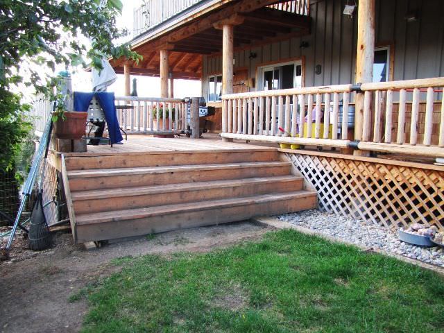

montana Posted September 25, 2010 Report Share Posted September 25, 2010 The systems room containing 4 water heaters (3 provide hydronic heat for radiant floor heating, and 1 for DHW), is an exterior room off a walk-out basement. After original construction, a landing was added off a wrap-around deck, that is over the top of this systems room. So, now the 4 exhaust vents are under the deck landing. The nearest door or window is at least 16 feet away. I know lots of standards for exhaust vent on roof, near windows, etc, but is there any concern about an exhaust vent under a deck (not immediately near a door or window)? My first thought would be heat damage, but I know from experience that the temperature of exhaust from a 36,000 BTU water heater is nowhere near high enough to torch the deck. There is no visible indication of heat damage on the underside of the deck. I know clearance requirements for B-type vents, but is there a clearance requirement for an exhaust hood? Puzzled Inspector (need an icon for a home inspector scratching his head) Click to Enlarge 92.47 KB Click to Enlarge 77.81 KB Link to comment Share on other sites More sharing options...
Terence McCann Posted September 25, 2010 Report Share Posted September 25, 2010 I'm pretty sure the original PE wouldn't approve of that design change. Heat may not be a problem but washing the ptw in a nice bath of moist acidic vapor may not be the best idea. Not to mention the fact that folks will be sitting right on top of these (the upside is it will take the chill off on a cool evening). Perhaps Katen has some code to cite. If the home isn't that old, and the original engineer for that system can be found, I'd shoot them a pic and ask for a opinion. Link to comment Share on other sites More sharing options...
Bain Posted September 25, 2010 Report Share Posted September 25, 2010 What Terry said, but more specifically, do you want a two-year-old playing on the deck and sucking in those flue gases? Besides which, normal clearance requirements should apply. All the instructions I've ever seen mention sidewalls, not overhead, horizontal walls, but logic suggests everything about the configuration in the photos is wrong. Link to comment Share on other sites More sharing options...
Scottpat Posted September 25, 2010 Report Share Posted September 25, 2010 On the upside it will keep the snow from accumulating and provide a nice sauna like experience in the winter months![] Link to comment Share on other sites More sharing options...
Mike Lamb Posted September 25, 2010 Report Share Posted September 25, 2010 B-vent termination needs to be at least 8' away or 2' above any walls or other obstructions. I would consider the deck above it an obstruction. Link to comment Share on other sites More sharing options...
Jim Katen Posted September 25, 2010 Report Share Posted September 25, 2010 . . . Perhaps Katen has some code to cite. . . . Katen is struggling to understand what the heck is going on. Do I understand correctly that, before the landing was constructed, there were simply four B-vents sticking up out of the ground in front of the deck? Is the systems room in a bunker? Were the B-vents intended to be decorative? Sorry, the old mind is reeling at this and can't quite seem to proceed until it absorbs this information. - Jim Katen, Oregon Link to comment Share on other sites More sharing options...
Bain Posted September 25, 2010 Report Share Posted September 25, 2010 Those babies would have to be treated like chimneys in my area, so they'd have to terminate above the roofline. I've never had to look it up, 'cause I haven't seen it, but I can't imagine a B-vent is rated for direct burial. Link to comment Share on other sites More sharing options...
David Meiland Posted September 25, 2010 Report Share Posted September 25, 2010 If I'm not mistaken those are Simpson Duravent high-wind rain caps, not B-vent caps. Link to comment Share on other sites More sharing options...

hausdok Posted September 27, 2010 Report Share Posted September 27, 2010 Back to the original thread, I'm not so certain that a tall chimney would have been absolutely required in any jurisdiction. As long as they were far enough away from the windows and doors, I think that it would be fine to have those vents come up out of a bunker like that. As for the deck over the top, though; that's just plain silly. The acidity in that exhaust gas is probably going to cause a host of problems with that wood and any metal fasteners, and the gas is liable to spread out under that deck and rise through that deck over a much broader area than it would have if the deck weren't there. It might be entirely possible to be sitting there in a deck chair and literally be surrounded by air that's heavily laden with C.O.. Someone should get the Darwin award for this one. ONE TEAM - ONE FIGHT!!! Mike Link to comment Share on other sites More sharing options...
Bain Posted September 27, 2010 Report Share Posted September 27, 2010 Back to the original thread, I'm not so certain that a tall chimney would have been absolutely required in any jurisdiction. As long as they were far enough away from the windows and doors, I think that it would be fine to have those vents come up out of a bunker like that. ONE TEAM - ONE FIGHT!!! Mike Have you been sniffin' Drano, my brother? What about kids getting burned or asphyxiated by those flues? I've never seen a B-vent terminate a couple of feet above grade (with the exception of the occasional DIY job). And what about burying the flues? I Googled and couldn't find anything definitive, but those things aren't allowed to be installed below ground, are they? I've never seen installation instructions that describe how to install subterranean B-vents. Link to comment Share on other sites More sharing options...
hausdok Posted September 27, 2010 Report Share Posted September 27, 2010 Back to the original thread, I'm not so certain that a tall chimney would have been absolutely required in any jurisdiction. As long as they were far enough away from the windows and doors, I think that it would be fine to have those vents come up out of a bunker like that. ONE TEAM - ONE FIGHT!!! Mike Have you been sniffin' Drano, my brother? What about kids getting burned or asphyxiated by those flues? I've never seen a B-vent terminate a couple of feet above grade (with the exception of the occasional DIY job). And what about burying the flues? I Googled and couldn't find anything definitive, but those things aren't allowed to be installed below ground, are they? I've never seen installation instructions that describe how to install subterranean B-vents. Oh, I suppose a kid could touch one one time and singe his finger and from that point on wouldn't hang around them. We have direct vent fireplace flues all over the place around here and I can't remember every hearing or reading about any kind being grieviously burned by one. They probably don't even get that hot; I've touched plenty of them and have never been burned. I've seen kids playgrounds with sewer vent stacks surfacing right in the middle of them too; I can't remember ever hearing about a kid dying out on the playground because he'd inhaled sewer gases. The burning thing aside, once that gas hits the outside air it dissipates pretty quickly. what's a kid going to do - go over to one of these throw a garbage bag around it and then stick his head in the garbage bag along with the flue and inhale deeply? I don't think so. There are bibs around the base of each of those. Those bibs are probably integrated into whatever type of waterproofing has been applied to the top of that bunker under that gravel. Those bibs take the brunt of the weather and whatever else touches them; not the B vent. ONE TEAM - ONE FIGHT!!! Mike Link to comment Share on other sites More sharing options...

Greg Booth Posted September 28, 2010 Report Share Posted September 28, 2010 It appears to me, that this is a room with a ballasted, membrane roof--I don't think we are looking at a buried "bunker". Wish the OP would help us out with more info. Link to comment Share on other sites More sharing options...
Tom Raymond Posted September 28, 2010 Report Share Posted September 28, 2010 Now you did it Mike. Every kid in that neighborhood will be hanging out over there making garbage bag hot air balloons over those B's, then the delinquent in the group will convince them to start huffing flue gasses[:-dev3] Seriously, kids are doing worse things than that. It's really stupid, and I'd say so, then I'd punt it to the AHJ and let him decide if he wants to be liable for that stupidity. I bet only the bunker portion has a permit, the deck was done after the fact to hide those things and make the missus happy. Link to comment Share on other sites More sharing options...
