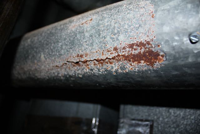

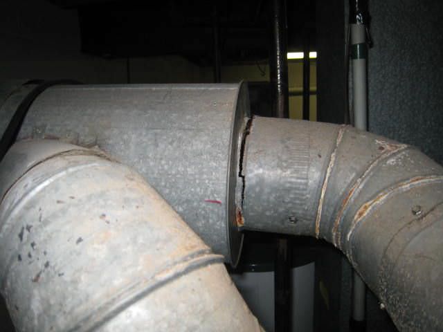

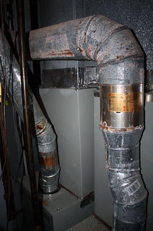

om Posted September 28, 2010 Report Share Posted September 28, 2010 We closed on a 30 year old house last July (New Jersey). The home inspection went well, a few minor details were in the report, nothing significant. While changing the furnace filters in early August I noticed some cracks in the exhaust pipe of the furnace (see photos). I sent the photos to the home inspector. He called me back and told me that he would stop the following week. He ended up not showing up for another 6 weeks or until we complained to our realtor (she called him and he listened...). His conclusion was that the previous owner should have fixed that, this is why he did not put it in his report ??? This was most certainly the only way out he could find. He told us he would send someone within the week to fix the pipes, so far no show after 2 weeks. My questions: - How serious of an issue is this problem? We have kids, they do play in the basement playroom. - How could an inspector miss that? It is so obvious! - Do we have any recourse to get him to reimburse us if he does not show up to fix the issue? - Can I trust his inspection or should I get another inspection, just to make sure? Thank you, Bob Click to Enlarge 64.59 KB Click to Enlarge 39.66 KB Click to Enlarge 35.51 KB Quote Link to comment Share on other sites More sharing options...
Ben H Posted September 28, 2010 Report Share Posted September 28, 2010 Curious, did your Realtor set up the inspection, or did you find your own inspector? And yes, cracked flue pipes in gas appliances are bad, have them fixed asap. Carbon Monoxide is nothing to fool around with. You should have CO detectors in the house, you do right? Quote Link to comment Share on other sites More sharing options...
hausdok Posted September 28, 2010 Report Share Posted September 28, 2010 Sure, The previous owner should have repaired it and the inspector should have listed it in the report as a deficiency that needs repair. Notify him in writing that you have complied with the terms of the pre-inspection contract by giving him an opportunity to come out, examine his oversight and make it right. Tell him that, since he hasn't made good on his end, and since winter is approaching and you have kids and need heat, you'll be contacting an HVAC firm to fix that flue and will be sending him the invoice. Tell him that if he doesn't intend to pay for the repairs to let you know now so you can save time by filing a complaint against him in small claims court now instead of later. Sign up for Angie's List, write a review of his services and send him a copy of the draft that you intend to post on Angie's List about his company when/if he doesn't live up to his end of your contract. While you are at it, send him a draft of the complaint that you intend to send to New Jersey's home inspection licensing authorities. That should do it. ONE TEAM - ONE FIGHT!!! Mike Quote Link to comment Share on other sites More sharing options...
Jim Katen Posted September 28, 2010 Report Share Posted September 28, 2010 Looks like two vents. Are there two furnaces? Just hire a good HVAC guy to replace the vents & send the home inspector the bill. If he pays it, great, if not, at least your family is safe. While you're at it, get rid of those automatic dampers. How old is the furnace (furnaces?). - Jim Katen, Oregon Quote Link to comment Share on other sites More sharing options...
Brandon Whitmore Posted September 28, 2010 Report Share Posted September 28, 2010 I'd hate to see the rest of the report if those ugly flues weren't written up. Quote Link to comment Share on other sites More sharing options...
caryseidner Posted September 28, 2010 Report Share Posted September 28, 2010 You might want to have your HVAC guy/gal look into what caused all that rust on the vents as well. It looks like the vents are not sloped properly. Quote Link to comment Share on other sites More sharing options...
Darren Posted September 28, 2010 Report Share Posted September 28, 2010 I agree with Cary; somethings wrong that has caused all the rust. Brandon's right too; if he missed something as obvious (and deadly) as that, who knows what else he missed. Here's a link to file a complaint. http://www.njconsumeraffairs.gov/hiac/hi_consumers.htm Quote Link to comment Share on other sites More sharing options...

om Posted September 28, 2010 Author Report Share Posted September 28, 2010 Thank you all! All your replies were very helpful. Things are pretty clear now. The home inspector I chose appeared to have a very good reputation, unfortunately he cannot be trusted. I will find an HVAC guy to get everything fixed and will try to get my money back. We do have carbon monoxyde detectors but it is still pretty scary to know that we could have ran these 2 furnaces for years without knowing about the problem. Quote Link to comment Share on other sites More sharing options...

Neal Lewis Posted September 28, 2010 Report Share Posted September 28, 2010 It looks like there may have been an oil furnace prior to this one, judging by the size of the metal exhaust/flue. Did the inspector advise you to have the chimney flue inspected/cleaned? Quote Link to comment Share on other sites More sharing options...
