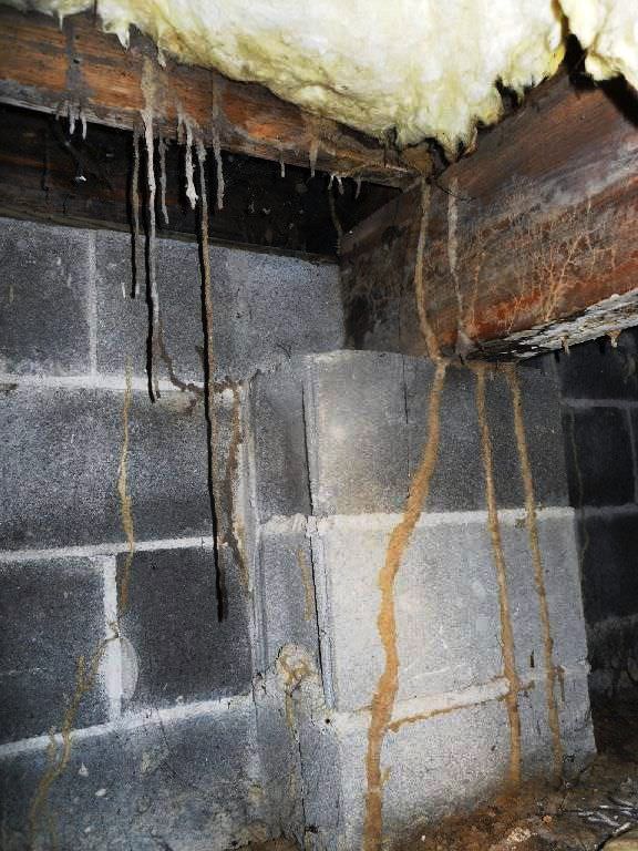

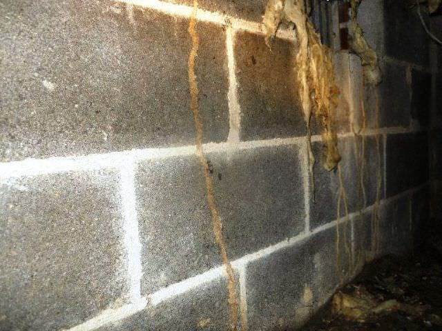

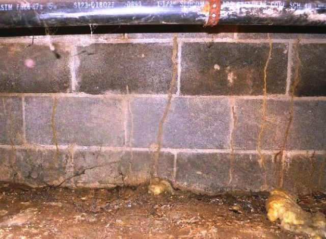

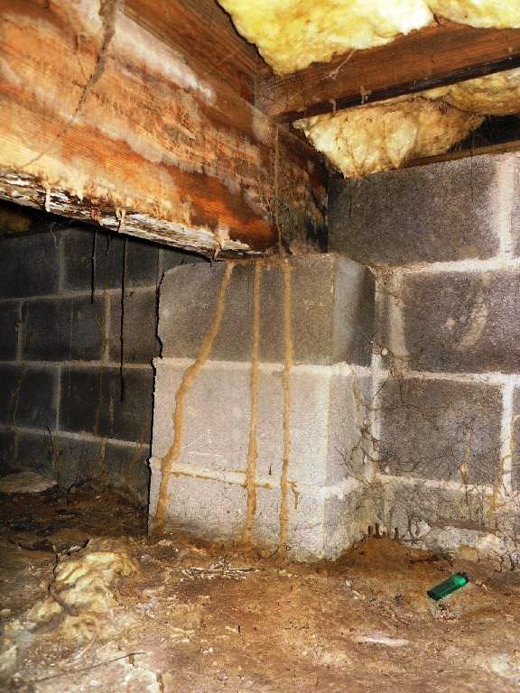

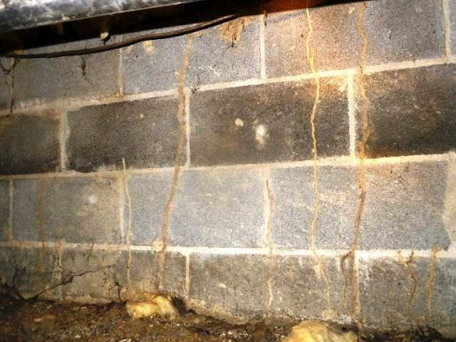

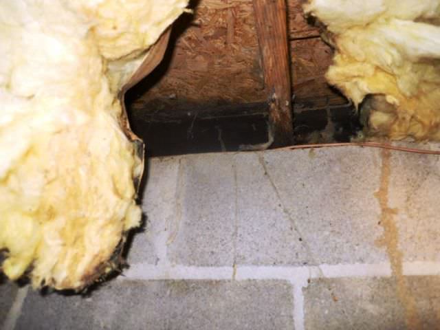

mgbinspect Posted October 8, 2010 Report Share Posted October 8, 2010 Richmond, is historically a haven for termites. It's not a matter of "if" they ever show up, but rather "when" they show up... This is, by far and away, the worst wood boring insect infestation I've ever seen. Every foundation wall has tubes on it about every three to four feet (probably sixty tubes in all). Most of the tubes have made it to the sill plate and beyond to the header joist and sub-floor. There were piles of tubes in the center of the crawl, which had me puzzled until I realized they were vertical tubes that had fallen over time after time. The tubes to the center beam are more akin to super highways. Tubes hang down from the center-beam as well. Click to Enlarge 84.53 KB Click to Enlarge 48.17 KB Click to Enlarge 62.16 KB Click to Enlarge 75.48 KB Click to Enlarge 77.65 KB Click to Enlarge 76.16 KB Click to Enlarge 109.38 KB Click to Enlarge 47.42 KB Click to Enlarge 112.53 KB Link to comment Share on other sites More sharing options...
hausdok Posted October 8, 2010 Report Share Posted October 8, 2010 Hi, Well, it's no wonder you've got a sub infestation; you've got a serious poria (brown rot) infestation there. The termites can't eat healthy wood and poria is about as sick as it can get. That girder has to go. ONE TEAM - ONE FIGHT!!! Mike Link to comment Share on other sites More sharing options...

mgbinspect Posted October 8, 2010 Author Report Share Posted October 8, 2010 Hi, Well, it's no wonder you've got a sub infestation; you've got a serious poria (brown rot) infestation there. The termites can't eat healthy wood and poria is about as sick as it can get. That girder has to go. ONE TEAM - ONE FIGHT!!! Mike Yeah, this crawl space is a complete train wreck - destined to become a sealed and conditioned space, after the replacement of many yards of sill plate and header joist (including the one the deck is hung on). And, the deck will probably become free standing. I think the buyers will most likely walk. Link to comment Share on other sites More sharing options...

inspector57 Posted October 9, 2010 Report Share Posted October 9, 2010 That is what I would describe a a "pusher". Easier to push the whole thing down and start over than to salvage that one. Looks like lots of moisture in that crawl, is that common in that part of the world? Link to comment Share on other sites More sharing options...
mgbinspect Posted October 9, 2010 Author Report Share Posted October 9, 2010 That is what I would describe a a "pusher". Easier to push the whole thing down and start over than to salvage that one. Looks like lots of moisture in that crawl, is that common in that part of the world? We have a fairly high water-table, so moisture, fungal growth, wood decay and termites are all issues here in both basements and crawl spaces. Most builders here won't build homes on basements, and a lot of the old homes on basements do leak. Link to comment Share on other sites More sharing options...
