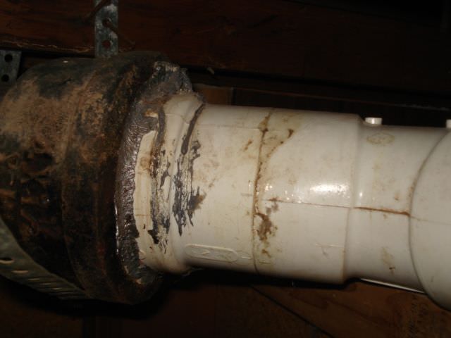

asihi Posted October 21, 2010 Report Share Posted October 21, 2010 I have a quick question. I did a vacant house today where a section of 3" cast iron sewer pipe was replaced with PVC. Instead of using any kind of connector, the plumber leaded the PVC into the cast iron hub. I've never seen this before. I would think with the expansion and contraction of the PVC, the lead wouldn't hold very well. Is this allowed and will this work? Thanks for your help. Tony Click to Enlarge 32.51 KB Quote Link to comment Share on other sites More sharing options...
Jim Katen Posted October 21, 2010 Report Share Posted October 21, 2010 I have a quick question. I did a vacant house today where a section of 3" cast iron sewer pipe was replaced with PVC. Instead of using any kind of connector, the plumber leaded the PVC into the cast iron hub. I've never seen this before. I would think with the expansion and contraction of the PVC, the lead wouldn't hold very well. Is this allowed and will this work? Thanks for your help. Tony I've seen it before and it seems to work fine. However, there's a much easier way. Fernco makes a special rubber donut just for that purpose. - Jim Katen, Oregon Quote Link to comment Share on other sites More sharing options...

Scottpat Posted October 22, 2010 Report Share Posted October 22, 2010 Another thing to ponder is that the PVC manufacturer most likely does not approve the use of lead to join PVC to anything. I would think that the heat that would be required to melt the lead would make the PVC under the lead brittle. I know that PVC does become brittle when it is exposed to heat, like when folks heat it to make a bend in the pipe. Quote Link to comment Share on other sites More sharing options...
kurt Posted October 22, 2010 Report Share Posted October 22, 2010 I've done it, and surprisingly, it doesn't do anything apparent to the PVC. It's just a pain in the butt getting the pot cooking, getting out the caulking irons, and all the other crap, when a little Fernco hub jammed in there takes about 1 minute. Quote Link to comment Share on other sites More sharing options...

resqman Posted October 22, 2010 Report Share Posted October 22, 2010 I recommend you contact the PVC pipe manufacturer and get their offical statement regarding the connection. Most of PVC in my area is made by Charlotte Pipe. Stamped all over the pipe. My guess is they would not approve of the connection. Only way to know for sure is ask the pipe manuf. Quote Link to comment Share on other sites More sharing options...

Scottpat Posted October 22, 2010 Report Share Posted October 22, 2010 This is what the IRC has to say about it... P2904.17.2 Plastic pipe or tubing to other piping material. Joints between different grades of plastic pipe or between plastic pipe and other piping material shall be made with an approved adapter fitting. Joints between plastic pipe and cast-iron hub pipe shall be made by a caulked joint or a mechanical compression joint. Quote Link to comment Share on other sites More sharing options...
Bill Kibbel Posted October 22, 2010 Report Share Posted October 22, 2010 As far as I can remember, caulking has been a code approved method for transitioning from plastic to a cast iron hub. ("caulking" is the term used for the traditional oakum and lead joint). I see it far more often than the "Fernco donut". Quote Link to comment Share on other sites More sharing options...
Jim Katen Posted October 22, 2010 Report Share Posted October 22, 2010 This is what the IRC has to say about it... P2904.17.2 Plastic pipe or tubing to other piping material. Joints between different grades of plastic pipe or between plastic pipe and other piping material shall be made with an approved adapter fitting. Joints between plastic pipe and cast-iron hub pipe shall be made by a caulked joint or a mechanical compression joint. In the world of plumbing, "Caulked joint" means lead. - Jim Katen, Oregon Quote Link to comment Share on other sites More sharing options...

Marc Posted October 22, 2010 Report Share Posted October 22, 2010 In the world of plumbing, "Caulked joint" means lead. - Jim Katen, Oregon What is a CI/PVC joint sealed with plumbers epoxy called? Marc Quote Link to comment Share on other sites More sharing options...
Jim Katen Posted October 22, 2010 Report Share Posted October 22, 2010 In the world of plumbing, "Caulked joint" means lead. - Jim Katen, Oregon What is a CI/PVC joint sealed with plumbers epoxy called? Marc I don't know. I've never seen it done. In my area, people use plumbers epoxy for everthing except plumbing. I don't see any reason why it wouldn't be called a caulked joint as well, though. -Jim Katen, Oregon Quote Link to comment Share on other sites More sharing options...
kurt Posted October 22, 2010 Report Share Posted October 22, 2010 I've also used epoxy, the powder in the blue can you mix with water, and bentonite oakum and the same goo out of the blue can. It all works just fine. Quote Link to comment Share on other sites More sharing options...
