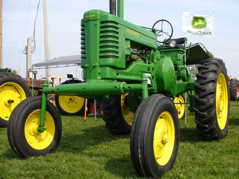

Terence McCann Posted December 17, 2010 Report Share Posted December 17, 2010 He'll only use it Douglas to make this: Pfftt.. [] Quote Link to comment Share on other sites More sharing options...
hausdok Posted December 17, 2010 Report Share Posted December 17, 2010 Is that a 4020? Haven't seen one of those in 30 years. ONE TEAM - ONE FIGHT!!! Mike Quote Link to comment Share on other sites More sharing options...

Les Posted December 17, 2010 Report Share Posted December 17, 2010 Is that a 4020? Haven't seen one of those in 30 years. ONE TEAM - ONE FIGHT!!! Mike naw, that is a country gentleman Model A. Can't see all of it, but looks like abt a 1950 from the tin work. Wonder if Chad's boiler is still in one piece and working. Quote Link to comment Share on other sites More sharing options...
