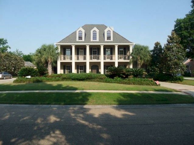

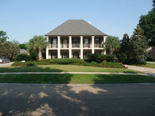

Jim Baird Posted May 11, 2011 Report Share Posted May 11, 2011 That chimbley column looks mighty short. Beside the point, but I wonder if any where in the report the word "ugly" popped up? Quote Link to comment Share on other sites More sharing options...
Marc Posted May 11, 2011 Author Report Share Posted May 11, 2011 That chimbley column looks mighty short. Beside the point, but I wonder if any where in the report the word "ugly" popped up? No. What is it that seems ugly? Marc Quote Link to comment Share on other sites More sharing options...
Richard Moore Posted May 11, 2011 Report Share Posted May 11, 2011 I wouldn't go so far as to call it ugly, but the large, plain roof does make it look like a glorified Pizza Hut sign. It needs some details... Click to Enlarge 55.51 KB Quote Link to comment Share on other sites More sharing options...
John Kogel Posted May 12, 2011 Report Share Posted May 12, 2011 I wouldn't go so far as to call it ugly, but the large, plain roof does make it look like a glorified Pizza Hut sign. It needs some details... Click to Enlarge 55.51 KB Nice work, Richard. I thought I was looking at Marc's pic, then I flipped back to his post. Wow. You've fixed the attic venting, too. Click to Enlarge 3.77 KB Quote Link to comment Share on other sites More sharing options...
