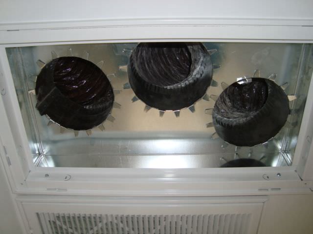

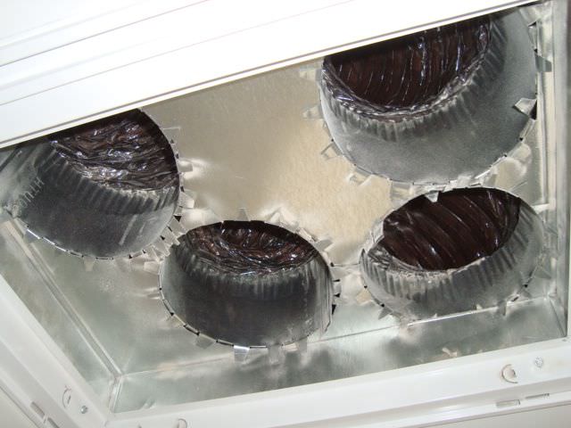

Anatol Posted May 16, 2011 Report Share Posted May 16, 2011 Fellow Inspectors, Recently renovated town home in DC. The only return(s) are located in the second floor ceiling (attic). No return installed on the first floor or in basement. Any idea why they would install two sets of returns and seven sets of duct in this area? Anatol Click to Enlarge 36.26 KB Click to Enlarge 49.83 KB Click to Enlarge 44.2 KB Quote Link to comment Share on other sites More sharing options...
Terence McCann Posted May 16, 2011 Report Share Posted May 16, 2011 Where is the furnace located? Quote Link to comment Share on other sites More sharing options...
Phillip Posted May 16, 2011 Report Share Posted May 16, 2011 With out seeing the attic view, my guess would be that they did not have room enough to run a large return pipe/duct so they had to run a bunch of little pipes to get the right amount of return air for the unit. Quote Link to comment Share on other sites More sharing options...
Anatol Posted May 16, 2011 Author Report Share Posted May 16, 2011 Furnace is in rear basement. Low slope town home roof, not a lot of space to run large ducting. Anatol Quote Link to comment Share on other sites More sharing options...
Bain Posted May 16, 2011 Report Share Posted May 16, 2011 One system will seldom cool a two-level house or townhome adequately. The returns were installed on the second level to mitigate that reality. As we know, heat rises, so the idea is to suck in the warm air near the second-level ceiling to prevent stratification. Sometimes it works. Usually it doesn't. Tell your peeps what's up, or they'll be calling you in August when the second level is 10 degrees warmer than the lower level. Quote Link to comment Share on other sites More sharing options...

Marc Posted May 17, 2011 Report Share Posted May 17, 2011 One system will seldom cool a two-level house or townhome adequately. The returns were installed on the second level to mitigate that reality. As we know, heat rises, so the idea is to suck in the warm air near the second-level ceiling to prevent stratification. Sometimes it works. Usually it doesn't. Tell your peeps what's up, or they'll be calling you in August when the second level is 10 degrees warmer than the lower level. Separate AC's for separate floors was born of a desire to save energy by shutting off the AC to the bedrooms during the daytime. A single system, if it possess adequate tonnage, can cool both floors just fine. If it's hotter upstairs during the cool season, the ductwork isn't properly sized. Between seasons it may be necessary to leave the blower on or run it intermittently, like my own thermostat provides for, to counter the rising hot air. Marc Quote Link to comment Share on other sites More sharing options...
Bain Posted May 17, 2011 Report Share Posted May 17, 2011 One system will seldom cool a two-level house or townhome adequately. The returns were installed on the second level to mitigate that reality. As we know, heat rises, so the idea is to suck in the warm air near the second-level ceiling to prevent stratification. Sometimes it works. Usually it doesn't. Tell your peeps what's up, or they'll be calling you in August when the second level is 10 degrees warmer than the lower level. Separate AC's for separate floors was born of a desire to save energy by shutting off the AC to the bedrooms during the daytime. A single system, if it possess adequate tonnage, can cool both floors just fine. If it's hotter upstairs during the cool season, the ductwork isn't properly sized. Between seasons it may be necessary to leave the blower on or run it intermittently, like my own thermostat provides for, to counter the rising hot air. Marc Perhaps in theory, but not in practice. I've been in too many two-story houses in which the second level was several degrees warmer than the lower level. I've never heard the bedroom scenario before, but I do know that an assembly-line builder in my area, that's in the top ten nationally, began putting two systems in its houses because they fielded a gazillion complaints when they were only putting one system in a house. Quote Link to comment Share on other sites More sharing options...
AHI in AR Posted May 18, 2011 Report Share Posted May 18, 2011 I tell my clients that they're fighting physics using one system to handle more than one floor: they can't win that fight. Returns on each floor help, but it's not a cure. My experience says that the upper floor will ALWAYS be a little warmer -- heating or cooling season. Running the fan continuously will help, but at what energy cost? Quote Link to comment Share on other sites More sharing options...

Terence McCann Posted May 18, 2011 Report Share Posted May 18, 2011 You can cool the 1st and second floor correctly with one system however you have to find a contractor that knows what their doing and then you actually have to pay more for a correct temperature control system and balanced duct work. When they build houses like their on an assembly line you get the contractor special. All I want to know is how cheap it is. Quote Link to comment Share on other sites More sharing options...
