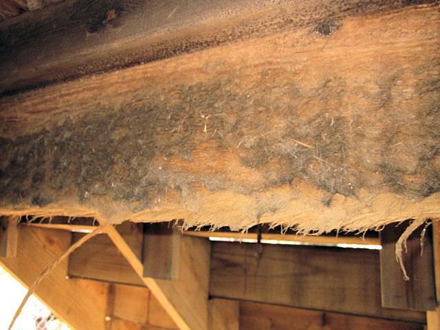

Mike Lamb Posted June 4, 2011 Report Share Posted June 4, 2011 I see this fur on floor joists beneath 100+ year old front porches often. Iââ¬â¢m sure itââ¬â¢s wood fibers from years of water and oxidation but itââ¬â¢s peculiar. The wood is not rotting. Maybe someone has a scientific explanation? Click to Enlarge 92.85 KB Click to Enlarge 65.57 KB Quote Link to comment Share on other sites More sharing options...
hspinnler Posted June 4, 2011 Report Share Posted June 4, 2011 I don't know Mike. Decades of dogs or cattle using them as a back scratcher? Quote Link to comment Share on other sites More sharing options...

Jim Katen Posted June 4, 2011 Report Share Posted June 4, 2011 Definitely not something I see around here, but Hank has a point. I see something like that on rough fence rails where cattle rub against them. Quote Link to comment Share on other sites More sharing options...
kurt Posted June 4, 2011 Report Share Posted June 4, 2011 No, nothing rubbing on them. They're always under mildly dank porches, sometimes in crawlspaces. It's moisture related, but I don't know what it is. Probably mold.......yeah, that's it; it's mold. Quote Link to comment Share on other sites More sharing options...
Jim Morrison Posted June 4, 2011 Report Share Posted June 4, 2011 No, nothing rubbing on them. They're always under mildly dank porches, sometimes in crawlspaces. It's moisture related, but I don't know what it is. Agreed. I see it every so often, but never quite that bad. Quote Link to comment Share on other sites More sharing options...

Jim Baird Posted June 6, 2011 Report Share Posted June 6, 2011 I crawled under a porch of a 100+yr old farmhouse where two women and about five big dogs lived. The porch flooring was gapped for ventilation I guess, but the perimeter was latticed tight. Anyway the dog hair had been gently falling for several years and did not accrete onto the sides of the framing, but due to my belly crawl did waft up to fill the air and gag me. Quote Link to comment Share on other sites More sharing options...
Angus Posted June 6, 2011 Report Share Posted June 6, 2011 I have seen this before, and everytime there has been a dog involved, including yellow lab hair under my own deck. Quote Link to comment Share on other sites More sharing options...

Bill Kibbel Posted June 6, 2011 Report Share Posted June 6, 2011 It's not any type of animal hair and yes, it is quite common under very old porches. It's called wood defibration and it's from the breakdown of the lignin between the fibers on the surface of the wood. It's usually from very slow, gradual decay. It can also be caused by salty air or salt used for melting ice. It's also been called defibrosis, delignification and "hairy timber" rot. Quote Link to comment Share on other sites More sharing options...
