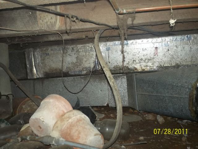

Phillip Posted July 31, 2011 Report Share Posted July 31, 2011 Just a reminder to all of you out there to be careful. yesterday while inspecting the crawlspace I started sliding under the main duct line. I felted a small tingle on my back, move and got the same feeling. I got out from under the duct work and touch it with my hand. I received a small shock. I got looking around and found a frailed electrical wire on top of the duct work. Click to Enlarge 57.44 KB Quote Link to comment Share on other sites More sharing options...

Marc Posted August 18, 2011 Report Share Posted August 18, 2011 I guess if the electricity is going to leak or spread, the duct work would be the place where it goes. Although wouldn't the frayed wire cause the circuit to flip? I know when I was little in our basement, we had concrete floors and exposed light switches where my father was renovating. Touching one of those wires would really wake me up. If the duct work was solidly bonded to earth, the breaker would likely trip. If bonding were not present, the energized duct would just sit and wait for some unfortunate individual or animal to complete the path, though that probably wouldn't be enough conductivity to trip the breaker. Marc Quote Link to comment Share on other sites More sharing options...
Jim Katen Posted August 19, 2011 Report Share Posted August 19, 2011 . . . If the duct work was solidly bonded to earth, the breaker would likely trip. Possible, but not guaranteed. It would depend on the earth. If bonding were not present, the energized duct would just sit and wait for some unfortunate individual or animal to complete the path, though that probably wouldn't be enough conductivity to trip the breaker. Marc If the goal is to clear faults that occur on the ducts, the way to achieve that is to use a bonding jumper to connect the ducts to the electrical system's grounding system -- either to the service enclosure, the neutral conductor at the service, grounding electrode conductor at the service, or directly to one of the service grounding electrodes. Simply connecting them to the earth won't provide a reliable fault current path. Quote Link to comment Share on other sites More sharing options...
