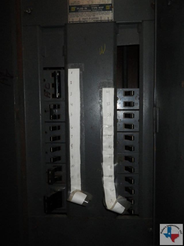

Nolan Kienitz Posted September 14, 2011 Report Share Posted September 14, 2011 Looking for some history and/or availability/viability of this panel being maintained today. House built in 1960, SEP installed in a very tight Utility Room and I was unable to safely open cover and remove deadfront. I can't seem to find any data on this panel. I plan on putting in report that sparky needs to review for ability to service/maintain. Click to Enlarge 40.35 KB Quote Link to comment Share on other sites More sharing options...
Brandon Whitmore Posted September 14, 2011 Report Share Posted September 14, 2011 Perhaps you'd find something if you Googled "Panellette"....[:-slaphap Quote Link to comment Share on other sites More sharing options...
Jim Katen Posted September 14, 2011 Report Share Posted September 14, 2011 Do you have a picture of the breakers? Quote Link to comment Share on other sites More sharing options...
Nolan Kienitz Posted September 14, 2011 Author Report Share Posted September 14, 2011 Do you have a picture of the breakers? A very poor one as access to the panel was a genuine PIA. Click to Enlarge 46.94 KB Quote Link to comment Share on other sites More sharing options...
Jim Katen Posted September 14, 2011 Report Share Posted September 14, 2011 If I recall correctly, those breakers were real trash. Quote Link to comment Share on other sites More sharing options...
Marc Posted September 14, 2011 Report Share Posted September 14, 2011 The lack of suitable access and age would be adequate reasons for me to write it up for replacement (in a better location). I'm not aware of any additional ammo for you to use. Marc Quote Link to comment Share on other sites More sharing options...
