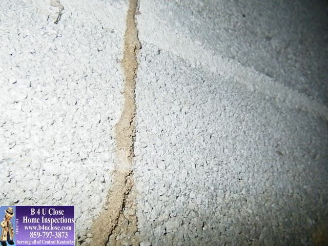

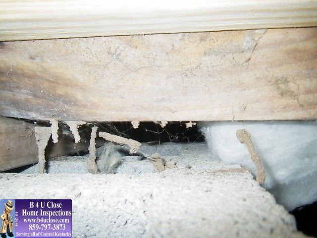

Erby Posted October 21, 2011 Report Share Posted October 21, 2011 In the great wisdom of the Kentucky Department of Agriculture's Structural Branch, and the Kentucky Pest Management Association, only a licensed pest control operator can legally identify wood destroying insects. So, while I saw evidence of what "appears" to be wood destroying insects (see photos below), I am not a licensed pest control operator and cannot legally determine the presence or absence of any wood destroying insects. Consult a licensed pest control operator to legally determine the presence or absence of any wood destroying insects and your best course of action regarding same. Click to Enlarge 59.25?KB Click to Enlarge 52.72?KB Click to Enlarge 76.96?KB Click to Enlarge 50.19?KB Perhaps sometimes I'm too sarcastic for my own good. Quote Link to comment Share on other sites More sharing options...
Nolan Kienitz Posted October 21, 2011 Report Share Posted October 21, 2011 In the great wisdom of the Kentucky Department of Agriculture's Structural Branch, and the Kentucky Pest Management Association, only a licensed pest control operator can legally identify wood destroying insects. So, while I saw evidence of what "appears" to be wood destroying insects (see photos below), I am not a licensed pest control operator and cannot legally determine the presence or absence of any wood destroying insects. Consult a licensed pest control operator to legally determine the presence or absence of any wood destroying insects and your best course of action regarding same. Click to Enlarge 59.25?KB Click to Enlarge 52.72?KB Click to Enlarge 76.96?KB Click to Enlarge 50.19?KB Perhaps sometimes I'm too sarcastic for my own good. Be careful ... watch some attorney say all the above is circumstantial and not solid evidence/proof. [] Quote Link to comment Share on other sites More sharing options...

kurt Posted October 22, 2011 Report Share Posted October 22, 2011 I think it offers great opportunity for theater. How many ways can the HI dance around the topic with approved language, while at the same time belittling and exposing the pinheads for what they are? I'm comfortable saying "There's some thing (here's a picture!) the State says I'm not allowed to identify, describe, or otherwise educate you about, crawling around this house. The State indicates I have to direct you to a licensed PCO for identification; call the PCO so they can also try to sell you treatment for this thing that most high school age children know about. Contact your Congressman for information related to this restriction of my right to tell you what you need to know." Kicking the hornets nest isn't particularly dangerous if you keep your escape routes in mind. At least, not around here. Would the Pacific Rim state's object to my approach? More accurately, could they punish me? Quote Link to comment Share on other sites More sharing options...

Marc Posted October 22, 2011 Report Share Posted October 22, 2011 I'm comfortable saying "There's some thing (here's a picture!) the State says I'm not allowed to identify, describe, or otherwise educate you about, crawling around this house. The State indicates I have to direct you to a licensed PCO for identification; call the PCO so they can also try to sell you treatment for this thing that most high school age children know about. Contact your Congressman for information related to this restriction of my right to tell you what you need to know." Kicking the hornets nest isn't particularly dangerous if you keep your escape routes in mind. At least, not around here. I observed what appears to be damage by some sort of wood destroying insect in the structural floor. While I've 3 years of prior experience as a termite inspector, I'm not currently registered, therefore I cannot tell which species it is. You will need to hire a registered termite inspector, nearly all of which employed by Pest Control Operators in this state. Keep in mind that since a termite inspector on a PCO's payroll has a vested interest in making a sale on a treatment, you may not hear from him exactly what he sees, just what he wants you to think. This conflict of interest in built in state law, specifically administrative law, by the Louisiana Structural Pest Control Commission I don't need an escape route. I invite them. I like to see the beet red faces sometimes, usually agents but I don't mind anyone who makes a living of screwing homebuyers or the profession that I work in. Unlike Washington State, the Structural Pest Control Commission is part of the Dept of Agriculture. The State Board of Home Inspectors and the Board of Realtors are separate agencies within the governor's office. None have jurisdiction over the others. Marc Quote Link to comment Share on other sites More sharing options...
