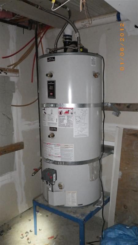

Robert Jones Posted January 10, 2012 Report Share Posted January 10, 2012 Can anyone tell by the attached picture what kind of radiant heating system was used, ie; closed etc...? Click to Enlarge 35.22?KB Click to Enlarge 43.94 KB Link to comment Share on other sites More sharing options...

hausdok Posted January 10, 2012 Report Share Posted January 10, 2012 Hi, Well, to expound on what I said earlier; the photo doesn't tell us anything because I believe that the system that had been there was removed and the water heater you see in the photo is what's been used to replace the wall-hung unit that was on the far wall. If that unit were still there and the photo was larger, I'd be able to tell whether the water heater was heating the water in the system directly or whether the heating loop was closed and heated by some kind of exchanger external to the water heater. Since all you have is the remnants of the tubing without the water heater, manifolds or controls, it's like looking at a pro-stock racer with the interior and dash stripped out and wondering, without talking to the owner, whether the original car had A/C or not. ONE TEAM - ONE FIGHT!!! Mike Link to comment Share on other sites More sharing options...

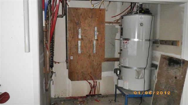

Robert Jones Posted January 10, 2012 Author Report Share Posted January 10, 2012 Thanks guys. I knew the pic wasn't going to do much justice with regards to my question. The homeowner(also the builder), took the device that attached to the water heater. The hydronic heat is in floor, not radiator type. I went ahead and attached a pic of the water heater. Link to comment Share on other sites More sharing options...

hausdok Posted January 10, 2012 Report Share Posted January 10, 2012 Hi Rob, What's the manufacturing date on the water heater? Are you sure he didn't simply strip out a tankless dual-purpose wall-hung water heater along with the circulators and manifold array and then cobble in a new tank-type water heater? I still don't see how that water heater is connected to the floor heat. Are there pictures from another angle? ONE TEAM - ONE FIGHT!!! Mike Link to comment Share on other sites More sharing options...

hausdok Posted January 10, 2012 Report Share Posted January 10, 2012 Ah, Now that you've posted the second coil and I've looked more closely at the first I think I see what's been done. It used to be a system that used a tankless water heater. He removed that tankless water heater and hooked up the system directly to a new tank type water heater (Now I see the minifold array on the left wall). My guess is that the sytem that had been used had a tankless water heater that utilized a closed loop system with a plate exchanger. When he stripped out the tankless, he took the plate exchanger with him. However, instead of hooking up the water heater to the potable water on one circuit, and the heating loop portion of the system to the in-tank coil on the other circuit, he's plumbed them all off the potable water side of the tank. Is that a whole lot of disconnected tubing protruding from the floor and walls? If so, that means that those disconnected portions are no longer in use and only part of the in-floor is actually heating the home. Is the floor heat even hooked up? The way the tank is configured, the temperature of the water leaving that tank is controlled using the tempering valve at the top of the tank. The point of that is one can crank the temperature of the tank way up, in order to have water temps that will allow the floor heating system to actually work, while still maintaining domestic hot water at a safe 120?F or less. If he's hooked the hydronic heating system directly to the potable water side of the tank and isn't controlling the temps of the two systems separately, the only way the floor heat will function properly is by cranking the water temperature way up on the tank and cranking the tempering valve all the way over to the hot side so that temps reaching the hydronic system are where they need to be. That works fine for the floor heat, but he'll end up with scalding hot water at the fixtures and be running the risk of third degree burns. Then, if the hydronic system is hooked up, there's the issue of constant circulation through that system. They aren't supposed to be plumbed so that they constantly circulate because then you run into issues with pipe scour. That floor system needs to be configured to circulate through those two nipples on the side of the tank and the pipes coming off the top of the tank need to be connected to only the DHW circuit so that DHW temp can be kept at 120 or less by the tempering valve. Contact Northwest Mechanical and talk to Buzz and send him some photos. ONE TEAM - ONE FIGHT!!! Mike Link to comment Share on other sites More sharing options...

Robert Jones Posted January 10, 2012 Author Report Share Posted January 10, 2012 Thanks Mike, No there is no heat in the home as the only source was the in floor radiant type. I was just curious as to what was removed(type of system). Those are pex tubes coming out of the floor, the home was a basement type. Link to comment Share on other sites More sharing options...
John Kogel Posted January 11, 2012 Report Share Posted January 11, 2012 Thanks Mike, No there is no heat in the home as the only source was the in floor radiant type. I was just curious as to what was removed(type of system). Those are pex tubes coming out of the floor, the home was a basement type. It looks like someone pulled a little gas boiler off the wall and sold it. Now why would somebody do that? [] I would say it looks to have been a closed system. My guess is that the tank heater is for domestic HW, still working? and the pex pipes were a separate system. But there are the copper pipes coming down from the ceiling, so who knows? It can still be a closed system and, what I often see here, anyway, have a line with a check valve and a pressure control off the main supply line. So that could be a makeup water supply line there. And there's that T on the WH, so who knows? Link to comment Share on other sites More sharing options...
