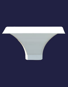

Bill Kibbel Posted March 14, 2012 Report Share Posted March 14, 2012 My last house had one of the additions under some mature cedar trees. I put a "funnel" downspout outlet on the gutter and it never clogged again. Quote Link to comment Share on other sites More sharing options...
