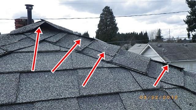

Robert Jones Posted March 27, 2012 Report Share Posted March 27, 2012 The roof is approximately 5 years old and I called out the fact that they used architectural shingles on the ridge(that were flipping up of course) rather than three tab or ridge cap shingles. Here was the response to the buyer. "4. Regular shingles are commonly cut and installed on the ridge. The inspector himself estimates AT LEAST 10 more years of life left on the roof. The shingles are either 30 or 40 year shingles. Therefore, these shingles on the ridge have been doing the job they were installed to do for a long time, through many high winds and not one has blown off. In fact, the asphalt strip on the back, meant to melt down and adhere one shingle to the next has done just that, and pulling them off now may damage the rest of the roof they are adhered to. These shingles are not a problem. The inspector says the roof is watertight, Best to leave well enough alone." Click to Enlarge 63.48?KB Click to Enlarge 70.7?KB Click to Enlarge 76.62 KB Click to Enlarge 79.08 KB Quote Link to comment Share on other sites More sharing options...
Jim Katen Posted March 27, 2012 Report Share Posted March 27, 2012 Aside from being a neon sign that says, "the roofer was a dumbass," I've never seen that cause a real problem. Quote Link to comment Share on other sites More sharing options...

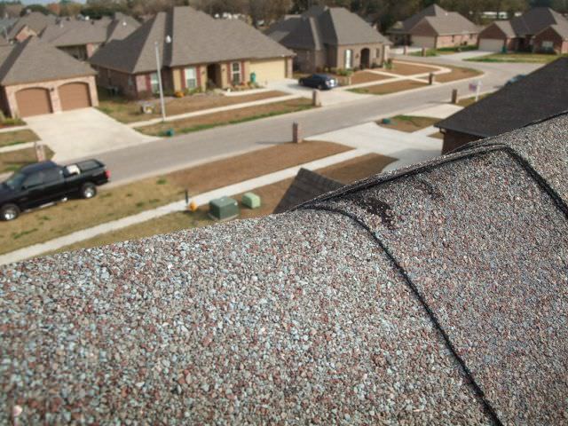

Marc Posted March 27, 2012 Report Share Posted March 27, 2012 Click to Enlarge 93.62 KB Maybe it's a regional-specific issue, perhaps high wind areas. This isn't the best picture but it shows de-lamination of two adjacent ridge shingles. Marc Quote Link to comment Share on other sites More sharing options...

Mike Lamb Posted March 27, 2012 Report Share Posted March 27, 2012 You are right to call it out but I'd accept that response if they looked OK. They are not easy to bend at severe angles and I'd expect to see what Marc shared on a steep roof. What was the slope of the roof? If a problem does develope there's nothing easier to repair than the hip and ridge. Quote Link to comment Share on other sites More sharing options...

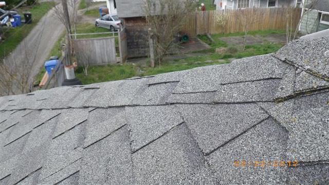

Robert Jones Posted March 27, 2012 Author Report Share Posted March 27, 2012 Thanks guys. I have added a pic of the install. Quote Link to comment Share on other sites More sharing options...
Jim Katen Posted March 27, 2012 Report Share Posted March 27, 2012 Click to Enlarge 93.62?KB Maybe it's a regional-specific issue, perhaps high wind areas. This isn't the best picture but it shows de-lamination of two adjacent ridge shingles. Marc Yes, the upper lamination peels back and looks stupid. It has no effect on the performance of the roof because the lower lamination stays put. Quote Link to comment Share on other sites More sharing options...
gtblum Posted March 27, 2012 Report Share Posted March 27, 2012 Wait a minute. I know I've seen at least one installation manual, and if I'm remembering it right, seen it written on the bundle packaging, that those were not to to be used for ridge caps because of that reason. They weren't designed to be bent like that and they will delaminate and fail. Sorry, I don't remember who's they were. Quote Link to comment Share on other sites More sharing options...
Jim Katen Posted March 27, 2012 Report Share Posted March 27, 2012 Wait a minute. I know I've seen at least one installation manual, and if I'm remembering it right, seen it written on the bundle packaging, that those were not to to be used for ridge caps because of that reason. They weren't designed to be bent like that and they will delaminate and fail. Sorry, I don't remember who's they were. Yes, they all say that. It's not a correct installation. But the "failure" has to do with delamination of the applied sections, not the base layer. I'm not saying this is right. It's wrong. I'm saying that I've never seen it cause a problem in the performance of the roof. Quote Link to comment Share on other sites More sharing options...
John Kogel Posted March 28, 2012 Report Share Posted March 28, 2012 Wait a minute. I know I've seen at least one installation manual, and if I'm remembering it right, seen it written on the bundle packaging, that those were not to to be used for ridge caps because of that reason. They weren't designed to be bent like that and they will delaminate and fail. Sorry, I don't remember who's they were. Yes, they all say that. It's not a correct installation. But the "failure" has to do with delamination of the applied sections, not the base layer. I'm not saying this is right. It's wrong. I'm saying that I've never seen it cause a problem in the performance of the roof. Let's just say Robert was not impressed with the performance put on by the roofer and his flaky ridge cap. [] Quote Link to comment Share on other sites More sharing options...
gtblum Posted March 28, 2012 Report Share Posted March 28, 2012 Let's just say Robert was not impressed with the performance put on by the roofer and his flaky ridge cap. Let's just say, they're not installed per the manufacturer's recommendation. End of story. Change them. The homeowner is wrong, and there's a much better chance of the wind tearing the whole piece when they're like that. Quote Link to comment Share on other sites More sharing options...
Marc Posted March 28, 2012 Report Share Posted March 28, 2012 Let's just say Robert was not impressed with the performance put on by the roofer and his flaky ridge cap. Let's just say, they're not installed per the manufacturer's recommendation. End of story. Change them. The homeowner is wrong, and there's a much better chance of the wind tearing the whole piece when they're like that. Good point. The de-lamination increases the vulnerability of the entire shingle not just the upper lamination. Marc Quote Link to comment Share on other sites More sharing options...

Marc Posted March 28, 2012 Report Share Posted March 28, 2012 Actually, the two in my photo were just examples. The ridge was sprouting 'wings' all over like a magnolia butterfly orgy, and this was a one year-old house. Maybe you were replying to Robert. Marc Quote Link to comment Share on other sites More sharing options...

Robert Jones Posted March 28, 2012 Author Report Share Posted March 28, 2012 Thanks for the replies and Gary is right on the money with this one. It wasn't just the one shingle flipping, there were numerous at different locations along that roof. My client was a young lady buying her first home and I explained to her that while they haven't blown off yet, there is a good possibility that they will in the future. First time buyers typically have no clue of repair cost and I tend to really hand hold them more than I would a client that is buying their third home for example. I have added a couple more pics I found. On a side note. This particular buyer is using a city down payment program that sends out their own inspector. On the last house I inspected for this client, they called out just about everything on my report and the seller refused to do the work so the deal was "killed". The home's that my client are looking at are in the 70-80k price range. That is on the low end in our market to say the least. That and they are typically in the 80-90 year old range. Not a good combination for the buyer and that assistance program to say the least. Quote Link to comment Share on other sites More sharing options...
