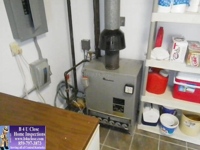

Erby Posted May 16, 2012 Report Share Posted May 16, 2012 I see very few boilers. This one was in my afternoon inspection. I raised the temperature on each of the thermostats, waited about an hour and checked each of the radiators with an infrared thermometer. Each of the radiators was producing heat. Any added thoughts on this set up. Click to Enlarge 45.82?KB Click to Enlarge 48.5?KB Click to Enlarge 59.78?KB Click to Enlarge 47.28?KB Click to Enlarge 42.84?KB Click to Enlarge 40.4?KB Click to Enlarge 47.86?KB Click to Enlarge 49.17?KB Click to Enlarge 56.1?KB Link to comment Share on other sites More sharing options...

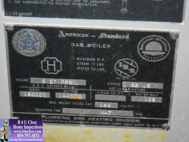

Erby Posted May 16, 2012 Author Report Share Posted May 16, 2012 Nope. Not even close. 180,000 BTU gas fired boiler and 40,000 BTU gas fired water heater in a room 9'6" by 10'6" by 8" high = 798 CUBIC feet and NO combustion makeup air vents. Nary a one. Some things you just shake your head at! Link to comment Share on other sites More sharing options...

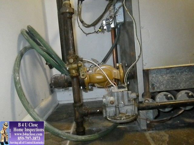

Tom Corrigan Posted May 16, 2012 Report Share Posted May 16, 2012 The union should be downstream of the gas shutoff valve (see the last picture). Tom Corrigan Link to comment Share on other sites More sharing options...

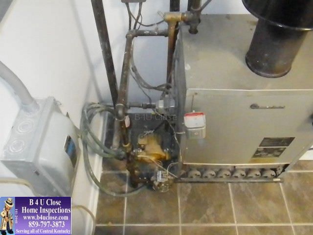

Darren Posted May 16, 2012 Report Share Posted May 16, 2012 Here's so things I include just for informational purposes: 'The heating system has multiple zones; this also means there are zones valves present. These valves open & close to allow (hot) water to flow thru a specific zone. While all zone valves were tested, you must be aware these valves do wear out and replacement should be considered a maintenance issue.' 'There is no air scoop installed on this hot water system. Although not required, an air scoop is a good upgrade to eliminate air in the pipes. Air in the pipes makes the system noisy and can create air lock. You should consider having an air scoop installed to help eliminate noise.' Link to comment Share on other sites More sharing options...
Neal Lewis Posted May 16, 2012 Report Share Posted May 16, 2012 Erby, the water supply feed is missing a backflow preventer valve. You really ran that system for a solid hour? Link to comment Share on other sites More sharing options...
kurt Posted May 16, 2012 Report Share Posted May 16, 2012 Why not? American Standard is a good old boiler. The pressure reducing valve acts as a back flow preventer, and the gas valve downstream of the union is a pilot shutoff. It's OK. Various locales can get picky about both, but both were considered SOP at the time this boiler was installed, and are actually just fine. Has anyone ever seen a room big enough to accommodate the combustion appliances? I never do, and I never see combustion air vents (well, rarely). Link to comment Share on other sites More sharing options...
Tom Raymond Posted May 16, 2012 Report Share Posted May 16, 2012 If it ran for an hour it's broken. Neal, boilers didn't require backflow preventers 50 years ago. The zone valve arrangement is comical. When the vinyl sheet flooring under it ignites it's efficiency will increase, but only briefly. Link to comment Share on other sites More sharing options...
