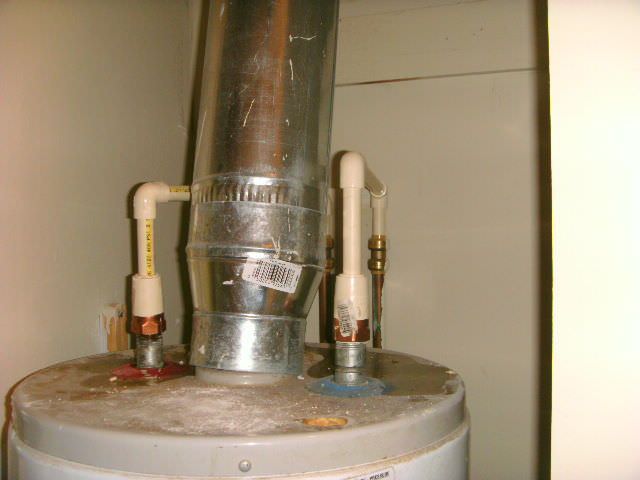

mlparham Posted November 2, 2012 Report Share Posted November 2, 2012 Click to Enlarge 34.99 KB I took this picture at this morning's inspection in a 1920's era home in the Old Fourth Ward. It is a view from the kitchen of the hall to a bedroom. At the front left of the picture you can see a door, at the center right a gas cold water heater and at the end of the hall a door to a bedroom. In my mind if the door from the kitchen to the hall is closed you now have a gas appliance in the closet of a sleeping room. If the door from the kitchen to the hall is removed is the cold water heater placement OK? If the door is not removed is it OK? Thanks in advance for your thoughts!! Link to comment Share on other sites More sharing options...

mlparham Posted November 3, 2012 Author Report Share Posted November 3, 2012 I see a valid concern, but technically, the appliance is in the hall, not in the bedroom. Yes, removing the kitchen door would reduce the risk. Until someone decided they wanted the door back. You are right to point out the risk. In my mind, I would recommend closing off the water heater with a closet door there and adding an air supply from outside. But that might not be practical. The tank sticks out too far into the hall. We just call them 'water heaters' but I guess they are 'cold water' heaters. Oh yeah, the TPR discharge pipe is kinda .... missing. [] No need to worry about the missing TPR drain line. There is another TPR on the 1/2" outlet line that's piped to the crawl space. Link to comment Share on other sites More sharing options...
John Kogel Posted November 3, 2012 Report Share Posted November 3, 2012 Oh yeah, the TPR discharge pipe is kinda .... missing. [] No need to worry about the missing TPR drain line. There is another TPR on the 1/2" outlet line that's piped to the crawl space. That is wrong, too. The TPR valve has a temperature probe that has to sit in the top of the tank. The one in the tank might blow ahead of the one with the discharge tube. I call it a scalding hazard because a curious kid could flip the lever and get a shot in the face. Link to comment Share on other sites More sharing options...
mlparham Posted November 4, 2012 Author Report Share Posted November 4, 2012 Oh yeah, the TPR discharge pipe is kinda .... missing. [] No need to worry about the missing TPR drain line. There is another TPR on the 1/2" outlet line that's piped to the crawl space. That is wrong, too. The TPR valve has a temperature probe that has to sit in the top of the tank. The one in the tank might blow ahead of the one with the discharge tube. I call it a scalding hazard because a curious kid could flip the lever and get a shot in the face. John, I was just being a little facetious. I attached another photo of the same water heater just for fun. What a mess. Click to Enlarge 33.93 KB Link to comment Share on other sites More sharing options...
rkenney Posted November 4, 2012 Report Share Posted November 4, 2012 Click to Enlarge 33.93?KB No draft hood Flue is upside down No water shut-off Definately DIY Link to comment Share on other sites More sharing options...

Brandon Whitmore Posted November 4, 2012 Report Share Posted November 4, 2012 Just for fun.... I see: Missing cold water shut off. Missing draft hood. Missing equilateral attachment at joints. Lack of proper vent/draft hood clearances to combustibles (pipe). Probable combustion air issue since you need 50 cu. ft. of air space for every 1k btu's of equip. rating. This water heater is probably 40k btu's and I doubt that "hallway" has 2k cu. ft. of space. Missing seismic restraints/ earthquake straps if required there. Missing discharge pipe. Is the inlet/outlet really reduced to 1/2"? But hey, it's working just fine, right? Link to comment Share on other sites More sharing options...

mlparham Posted November 4, 2012 Author Report Share Posted November 4, 2012 Just for fun.... I see: Missing cold water shut off. Missing draft hood. Missing equilateral attachment at joints. Lack of proper vent/draft hood clearances to combustibles (pipe). Probable combustion air issue since you need 50 cu. ft. of air space for every 1k btu's of equip. rating. This water heater is probably 40k btu's and I doubt that "hallway" has 2k cu. ft. of space. Missing seismic restraints/ earthquake straps if required there. Missing discharge pipe. Is the inlet/outlet really reduced to 1/2"? But hey, it's working just fine, right? Did you notice the standing water on top of the unit? There is an almost impossible to reach cutoff valve behind the water heater and it was in the off position when I took the picture. Odd don't you think? But it gets better. There was also water leaking from the turned off hot water supply at the adjacent laundry area. So, if the water supply is turned off to the water heater and there is a leak at the water heater piping and at a hot water faucet and no flow to some cold water faucets do you think we have a plumbing problem? Link to comment Share on other sites More sharing options...
