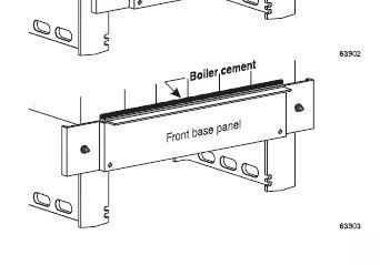

Mike Lamb Posted November 21, 2012 Report Share Posted November 21, 2012 The paste is cracking off this 2 yr old steam boiler. It's right above the front burners and below the cast iron exchanger. Why is it there and is it a big deal that it's cracking and peeling off? Click to Enlarge 46.54 KB Click to Enlarge 46.98 KB Quote Link to comment Share on other sites More sharing options...
Jim Katen Posted November 21, 2012 Report Share Posted November 21, 2012 Looks like furnace cement. It's like spackle for furnace's, boilers, & stoves. Every time I see it, it's hiding something bad. Quote Link to comment Share on other sites More sharing options...
Bill Kibbel Posted November 22, 2012 Report Share Posted November 22, 2012 That's the front base panel where it meets the cast-iron section assembly. Sealant is required at that location, per the installation instructions, to keep "flue gas" from spilling out. The manufacturer of the boiler supplied boiler cement for that application and for other seals needed on installation. It's just a sloppy job. Weil McLain EG boiler? Quote Link to comment Share on other sites More sharing options...
Mike Lamb Posted November 22, 2012 Author Report Share Posted November 22, 2012 Thanks all. Yes. Weil-McClain. I looked up the install instructions and it looks like you are right, Bill. Click to Enlarge 11.1 KB Have a good Thanksgiving. Quote Link to comment Share on other sites More sharing options...
