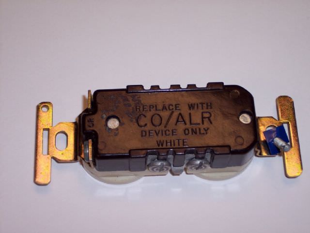

Charlie R Posted November 29, 2012 Author Report Share Posted November 29, 2012 Makes sense to not loop the wire over itself. As to using the CO/ALR rated receptacles, I ran across this statement - what is everyone's thoughts? "Also some incorrectly believe that repairing older pre-1970s aluminum can be done by replacing electrical devices (switches, outlets, etc.) with ones that are rated for use with aluminum wire (CO/ALR rated devices). The problem is that these modern devices are tested and listed using modern AA-8000 series alumimum wire, which is very different than older pre-1970s aluminum wire which expands and contracts much more, and is more susceptible to creep. So the CPSC considers using CO/ALR devices for older aluminum wiring only an emergency repair." Wikipedia Quote Link to comment Share on other sites More sharing options...
Jim Katen Posted November 30, 2012 Report Share Posted November 30, 2012 Makes sense to not loop the wire over itself. As to using the CO/ALR rated receptacles, I ran across this statement - what is everyone's thoughts? "Also some incorrectly believe that repairing older pre-1970s aluminum can be done by replacing electrical devices (switches, outlets, etc.) with ones that are rated for use with aluminum wire (CO/ALR rated devices). The problem is that these modern devices are tested and listed using modern AA-8000 series alumimum wire, which is very different than older pre-1970s aluminum wire which expands and contracts much more, and is more susceptible to creep. So the CPSC considers using CO/ALR devices for older aluminum wiring only an emergency repair." Wikipedia I'd want to see documentation that backs up the claim that CO/ALR devices are not considered acceptable for use with pre AA-8000 wire. Quote Link to comment Share on other sites More sharing options...
Charlie R Posted November 30, 2012 Author Report Share Posted November 30, 2012 Jim- This is what is in the CPSC PDF that anyone can download - AluminumWiringFixes.pdf - "However, CO/ALR wiring devices have failed in laboratory tests when connected to aluminum wire typical of that installed in existing homes. The test conditions simulated actual use conditions; no ?overstress? type of testing was used. Further, CO/ALR connectors are not available for all parts of the wiring system (e.g., for the permanently wired appliances and ceiling mounted light fixtures). In the opinion of CPSC staff, CO/ALR devices must be considered, at best, an incomplete repair. Recommendations on Temporary Repairs AL/CU twist-on connector pigtails or CO/ALR devices may be used as an emergency, temporary repair for a failed aluminum termination." Honestly, I don't know if the receptacles and switches will fail or not, and I agree that this is the stuff produced by government. I'm not a barrister, but my point is - from a liability stand point, are we smart for telling people that using CO/ALR rated components is OK when the government is saying it's not? Quote Link to comment Share on other sites More sharing options...
Douglas Hansen Posted November 30, 2012 Report Share Posted November 30, 2012 Honestly, I don't know if the receptacles and switches will fail or not, and I agree that this is the stuff produced by government. I'm not a barrister, but my point is - from a liability stand point, are we smart for telling people that using CO/ALR rated components is OK when the government is saying it's not? Electrical components are tested and listed by "Nationally Recognized Testing Laboratories" (NRTLs). The most prominent NRTL is UL. NRTLs do not arbitrarily choose the manner in which components are tested. They are tested to published standards. For receptacles, the standard is ANSI/UL 498, and for snap switches it is ANSI/UL 20. CPSC is not a nationally recognized testing laboratory. The engineer who provided the bulk of "their" research on aluminum is not an electrical engineer. The test protocols which were followed for whatever research led to this CPSC statement have not been published, and there is no reason to imagine they were conducted in accordance with the procedures of the published standards. Per the NEC and the standards above, snap switches, and receptacles rated 20 amps or less, must be rated CO/ALR when directly connected by aluminum conductors. Other types of receptacles may be connected by pigtailing copper and using a suitable connector between the different materials. If you examine a CO/ALR receptacle or switch, you will see that the underside of the terminal screw head has a saw-tooth pattern designed to bite into the conductor and increase the area of surface contact between the materials. Of course they must also be applied at their proper torque setting (20 inch pounds). Quote Link to comment Share on other sites More sharing options...

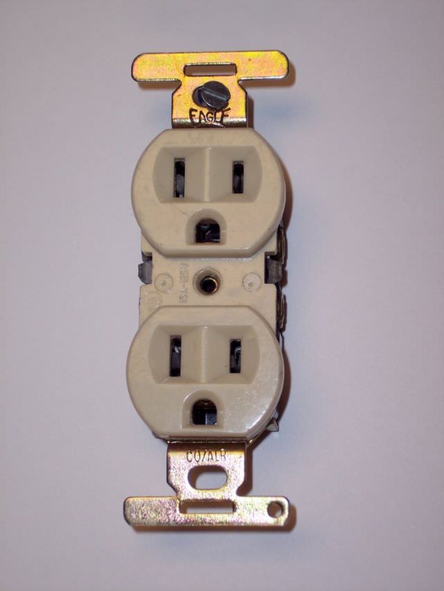

ericwlewis Posted December 1, 2012 Report Share Posted December 1, 2012 That's a new duplex receptacle rated CO/ALR and is suitable for 10 or 12 gauge aluminum wire. The pigtails are there to increase the billable hours rather than improve the safety of the system. The electrician is an idgit. Serious question, are all new receptacles rated CO/ALR??? or can you actually see it on there? I didn't think the 39 cent recepts were CO/ALR, just the $2 ones. Quote Link to comment Share on other sites More sharing options...
Douglas Hansen Posted December 1, 2012 Report Share Posted December 1, 2012 Serious question, are all new receptacles rated CO/ALR??? or can you actually see it on there? I didn't think the 39 cent recepts were CO/ALR, just the $2 ones. They are a specialty item, and probably cost more the $2 these days. I doubt they sell them in home improvement centers. I've only seen them in electrical supply houses. You can see the letters on the yoke and they are also embossed on the back. Click to Enlarge 28.63 KB Click to Enlarge 41.11 KB Quote Link to comment Share on other sites More sharing options...
Charlie R Posted December 1, 2012 Author Report Share Posted December 1, 2012 Thanks Douglas, appreciate the feedback. If we can counter CPSC's statement with a UL rating then that is certainly worth something. I had another home yesterday with aluminum wiring and you guys would have been proud - I only took some covers off, I didn't pull the receptacles out. See, I can learn! Quote Link to comment Share on other sites More sharing options...
ericwlewis Posted December 1, 2012 Report Share Posted December 1, 2012 Serious question, are all new receptacles rated CO/ALR??? or can you actually see it on there? I didn't think the 39 cent recepts were CO/ALR, just the $2 ones. They are a specialty item, and probably cost more the $2 these days. I doubt they sell them in home improvement centers. I've only seen them in electrical supply houses. You can see the letters on the yoke and they are also embossed on the back. Click to Enlarge 28.63?KB Click to Enlarge 41.11?KB I was pretty sure I knew the answer and that you can get them in Lowes, Menards etc. I have bought them there recently. As far as cost, . $2.99 at Home depot http://www.homedepot.com/Electrical-Out ... LqH-obAGso Quote Link to comment Share on other sites More sharing options...
Douglas Hansen Posted December 1, 2012 Report Share Posted December 1, 2012 Thanks Eric Clicking on your link it turns out even my local HD store has 28 of them in stock. Quote Link to comment Share on other sites More sharing options...
