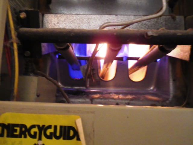

Jerry Simon Posted August 20, 2014 Report Share Posted August 20, 2014 Look at the flame in the left heat exchanger compartment. Seller had furnace tech out to check. Furnace tech called me today, and asked (snidely) if I was the *home inspector*. After acknowledging such, I asked who I had the pleasure of speaking with. He replied "what's your f****ing problem". Click to Enlarge 39.68 KB Quote Link to comment Share on other sites More sharing options...

Brandon Whitmore Posted August 22, 2014 Report Share Posted August 22, 2014 It looks like there's a combination of dirty burners/carry-overs and primary air shutters being out of adjustment (most likely). Quote Link to comment Share on other sites More sharing options...
plummen Posted August 22, 2014 Report Share Posted August 22, 2014 It looks like there's a combination of dirty burners/carry-overs and primary air shutters being out of adjustment (most likely). [^][^] Quote Link to comment Share on other sites More sharing options...
