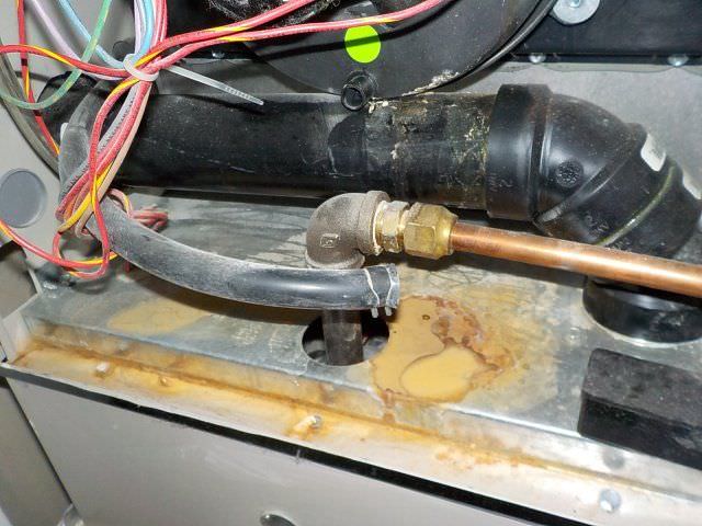

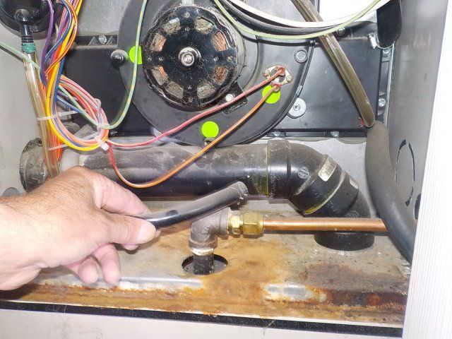

John Kogel Posted October 18, 2014 Report Share Posted October 18, 2014 I had occasion to inspect 2 homes about one block apart. Same age, same floor plans, same furnaces. Texas Furnace Co high efficiency gas furnaces dated 2006. Both have the condensate hose pulled off so that the drip is corroding the cabinet. Why would the HVAC dude do this? Or do these hoses blow off on their own? Click to Enlarge 73.07 KB Click to Enlarge 68.3 KB Click to Enlarge 68.29 KB Quote Link to comment Share on other sites More sharing options...
inspector57 Posted October 19, 2014 Report Share Posted October 19, 2014 Looks like it might have been pulled off and not replaced during installation of the horizontal exhaust pipe. Just sloppy work. Quote Link to comment Share on other sites More sharing options...
plummen Posted October 19, 2014 Report Share Posted October 19, 2014 Looks like it might have been pulled off and not replaced during installation of the horizontal exhaust pipe. Just sloppy work. What he said. Quote Link to comment Share on other sites More sharing options...
John Kogel Posted October 19, 2014 Author Report Share Posted October 19, 2014 The same dude probably installed them both.[:-graduat Thanks. I felt confident it was wrong the first time but when you see the same thing in another house you start to question, maybe there's something to this I don't know? Quote Link to comment Share on other sites More sharing options...

John Kogel Posted October 22, 2014 Author Report Share Posted October 22, 2014 Does it really make a difference why the hose was off? Where's the benefit in trying to assign blame? You may be misunderstanding my thought process. I don't need to assign blame. I need to know if it was willfully removed. If so, why? Was it causing a problem? One hose, somebody forgot or it blew off. Two furnaces, same hose off, I wonder if there is a mysterious reason for removing the hose. Quote Link to comment Share on other sites More sharing options...

kurt Posted October 23, 2014 Report Share Posted October 23, 2014 It took a while to get my interest, but now that I'm here..... Was/is the hose plugged or open and freely draining? Quote Link to comment Share on other sites More sharing options...
Chad Fabry Posted October 24, 2014 Report Share Posted October 24, 2014 It took a while to get my interest, but now that I'm here..... Was/is the hose plugged or open and freely draining? I just read it too. Honestly, I probably would have just put the hose back on. Quote Link to comment Share on other sites More sharing options...
John Kogel Posted October 24, 2014 Author Report Share Posted October 24, 2014 It took a while to get my interest, but now that I'm here..... Was/is the hose plugged or open and freely draining? I just read it too. Honestly, I probably would have just put the hose back on. I could have done that. Twice. But then we wouldn't be having this educational discussion. [] The hoses are not plugged. I wanted the furnaces to be checked out, the real reason I didn't put them back on. Quote Link to comment Share on other sites More sharing options...
Les Posted October 24, 2014 Report Share Posted October 24, 2014 I am with John on this. if I saw two off I would wonder why and come here and ask. I may have put it back on, but likely would have punted to hvac tech. I see many of these hoses that are rotted, swollen, leaking etc. but to see two that are in pretty good condition and off nipple would pique my interest. Quote Link to comment Share on other sites More sharing options...
John Kogel Posted October 24, 2014 Author Report Share Posted October 24, 2014 \I need to know if it was willfully removed. If so, why? Was it causing a problem? It sure seems to me John that you could burn up some valuable time trying to get such answers. And no matter what they would be I'll bet that you'd make the same recommendation to your client - let the HVAC contractor figure it out. [] Eric, a poem from the Great War -Our's is not to question why, our's is but to do and die. Quote Link to comment Share on other sites More sharing options...
kurt Posted October 24, 2014 Report Share Posted October 24, 2014 Yeah, I'd probably ask too. Modern HVAC equipment continues to evolve and provide multiple conundrums in problem solving. I asked the question I asked because I've been seeing brand new installs with the hose not connected and plugged; it just hangs there. I was told it's a secondary drain for service, which made no sense. I was hoping someone would tell me what the second plugged hose is. Quote Link to comment Share on other sites More sharing options...
Les Posted October 24, 2014 Report Share Posted October 24, 2014 the second hose is to accommodate installation with another orientation. on side upside down etc. or to facilitate incoming flue(s). Quote Link to comment Share on other sites More sharing options...
kurt Posted October 24, 2014 Report Share Posted October 24, 2014 So, it kinda about service. Kinda. Thnx. Quote Link to comment Share on other sites More sharing options...
