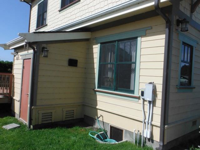

Denray Posted April 13, 2015 Report Share Posted April 13, 2015 The black conductors are coming from the main panel, which is a 100 amp single breaker panel. At this box the red and black go to the house sub panel. The yeller taps go to the garage sub panel. That small white wire shouldn't be tapped in there either. What do you call this kind of box? The small wire taps are wrong, correct? Click to Enlarge 77.02 KB Quote Link to comment Share on other sites More sharing options...
Marc Posted April 13, 2015 Report Share Posted April 13, 2015 The black conductors are coming from the main panel, which is a 100 amp single breaker panel. At this box the red and black go to the house sub panel. The yeller taps go to the garage sub panel. That small white wire shouldn't be tapped in there either. What do you call this kind of box? The small wire taps are wrong, correct? Click to Enlarge 77.02 KB Transfer switch. Marc Quote Link to comment Share on other sites More sharing options...
Denray Posted April 14, 2015 Author Report Share Posted April 14, 2015 Shouldn't there be a lock on that? Looks way easy for a kid to get into. Click to Enlarge 57.43 KB Quote Link to comment Share on other sites More sharing options...
Jim Katen Posted April 14, 2015 Report Share Posted April 14, 2015 Shouldn't there be a lock on that? Looks way easy for a kid to get into. There's no requirement for one. When people put locks on these things they tend to lose the key or forget the combination. I suggest using heavy duty cable ties instead. It's enough of a deterrent to keep the really little kids out and bigger kids, well at some point they've got to learn about electricity . . . Quote Link to comment Share on other sites More sharing options...
John Kogel Posted April 14, 2015 Report Share Posted April 14, 2015 Shouldn't there be a lock on that? Looks way easy for a kid to get into. There's no requirement for one. When people put locks on these things they tend to lose the key or forget the combination. I suggest using heavy duty cable ties instead. It's enough of a deterrent to keep the really little kids out and bigger kids, well at some point they've got to learn about electricity . . . A screw shackle makes a good lock. Kid has to learn vise-grips and rust first, then he gets to learn wiring. [] Yes the doubletaps are wrong. Marc is 'transfer switch' a Cajun expression for 'disconnect switch'? [] Quote Link to comment Share on other sites More sharing options...

Marc Posted April 14, 2015 Report Share Posted April 14, 2015 Click to Enlarge 77.02 KB The house connects to the center, the electric utility at the top and the generator at the bottom. It ain't Cajun. 'Dis is Cajun. Marc Quote Link to comment Share on other sites More sharing options...

RPV Posted April 17, 2015 Report Share Posted April 17, 2015 It`s a disconnect, not transfer switch. Should not have two wires ever under one lug. Front door will not open or should not when energized. Can`t tell what amperage this is by picture but I would say it`s probably 100 amp. The smaller wire is not rated for that size disconnect or breaker that feeds it and is in danger as it is on an overrated breaker. No code violation for not having lock but would never pass an electrical inspection. Obviously homeowner or friend installed with no permit or inspection. Quote Link to comment Share on other sites More sharing options...
