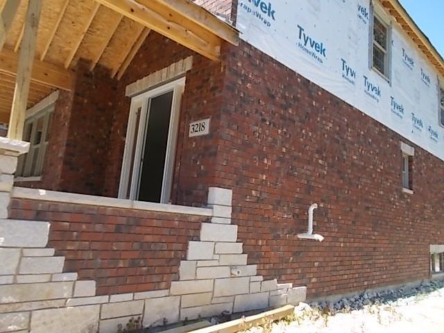

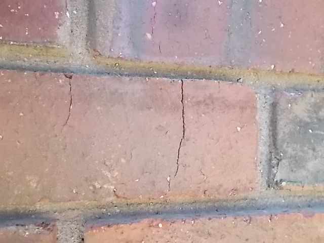

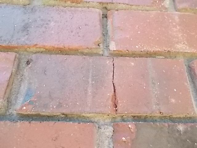

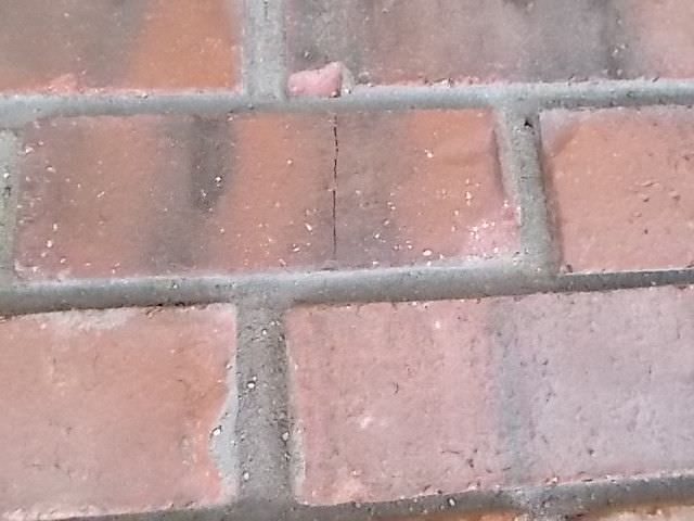

Mike Lamb Posted July 21, 2015 Report Share Posted July 21, 2015 This house had a lot of vertical cracks in the brick face. Is it cause for great concern? I am thinking freeze/thaw will wreck the brick. Thoughts? Click to Enlarge 64.97 KB Click to Enlarge 53.1 KB Click to Enlarge 53.11 KB Click to Enlarge 49 KB Quote Link to comment Share on other sites More sharing options...

Scottpat Posted July 22, 2015 Report Share Posted July 22, 2015 I would say something like this "Many of the bricks on this home have visible cracks, the exact cause of the cracks is not known but it could be a defect in the brick or even mishandling when it was being installed. A concern is that water will enter the cracks, freeze and expand causing additional damage to the brick. This condition will not improve with time, it will only worsen. The builder should contract the brick manufacturer or a masonry expert for additional instructions on what needs to be done". Quote Link to comment Share on other sites More sharing options...
Chad Fabry Posted July 22, 2015 Report Share Posted July 22, 2015 In the first photo, the brick is broken. Cletus was probably too enthusiastic setting it to the line. There is no crack above or below the brick, the mortar joints are intact. It's really just two small bricks. In the second and third photos, the surface is crazed, there's no visible cracks above or below the crazing and no sign anywhere that there's been some structural movement to crack the bricks. The look may be intended or it may be a defect. I'd advise my client to contact the manufacturer to ascertain what the bricks are supposed to look like. Or, I'd be so shocked from the overall ugly that I'd forget to mention the condition. Quote Link to comment Share on other sites More sharing options...
kurt Posted July 22, 2015 Report Share Posted July 22, 2015 BTW, is the stone ruins look supposed to be attractive? Actually, yes, with the emphasis on the "supposed to be" part. It's hard to explain how stuff happens in Chicago, but I'll try..... Think of an otherwise normal and reasonable person that wants to build a house. Now, remove their frontal lobe, reasoning ability, and provide relentless exposure to countless misguided efforts to recreate Olde Worlde Charm by mimicking medieval design elements translated into stylistic decorations on 25 x 125 infill city lots. It has stuff on it that looks like other stuff. It must be architecture then, right? Mission accomplished. As far as the cracked brick, Scott's got the right idea, but too many words. Way too many for someone building something this ****ing ugly. My knee jerk is some moron is using a *too hard* bag mix for soft brick. We got dweebs in Chicago that use S because it's "Structural", so it must be stronger, and stronger is better. Seriously. It should be a soft sandy limey mix, maybe Type O. The soft and already partly cracked brick is moving around and the mud isn't. Or something like that. Incompatible mortar. It's epidemic. Quote Link to comment Share on other sites More sharing options...
Mike Lamb Posted July 22, 2015 Author Report Share Posted July 22, 2015 I didn't even notice the cracks. My client did. The general pointing was terrible with cracks and holes in the mortar everywhere especially at the dirty verts. Quote Link to comment Share on other sites More sharing options...
kurt Posted July 22, 2015 Report Share Posted July 22, 2015 Lousy head joints. That'll mess up stuff. The bricks look like those fake clinker things; they're crappy brick to start, they use them to go with the goofy stone ruins look, like the whole thing was put together by northern Euro-serfs in the Dark Ages. Quote Link to comment Share on other sites More sharing options...
