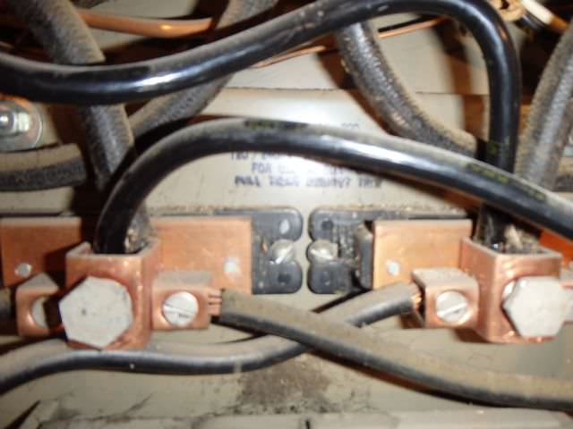

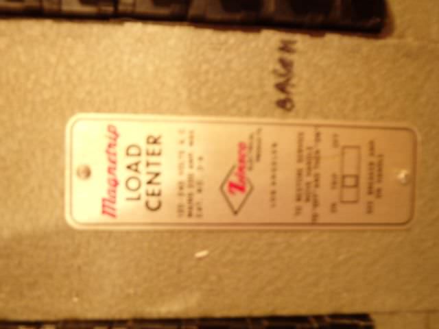

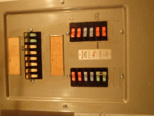

Inspector1 Posted December 21, 2015 Report Share Posted December 21, 2015 I have been a Home Inspector for two years. I have seen a few Zinsco panels but not one like this. It's from a friends house that sold recently. I had a few concerns about the panel and wanted to get some input from some Inspectors. I see some double taps with service conductors. double taps on some breakers. Click to Enlarge 42.26 KB Click to Enlarge 39.07 KB Click to Enlarge 28 KB Click to Enlarge 46.92 KB Click to Enlarge 51.4 KB Link to comment Share on other sites More sharing options...
Nolan Kienitz Posted December 21, 2015 Report Share Posted December 21, 2015 Zinsco products are about as bad as Federal Pacifics. I recommend replacement everytime I run across one. Link to comment Share on other sites More sharing options...
Jim Katen Posted December 21, 2015 Report Share Posted December 21, 2015 I'm not sure what you want to know. Zinsco panels are crap. The double taps are wrong. If you want more input about the panel or the installation, you'll have to post nice clear pictures of it with the cover off. Only posting pictures of the probelms you've already found won't help us to find things that you didn't see. Link to comment Share on other sites More sharing options...
Robert Jones Posted December 21, 2015 Report Share Posted December 21, 2015 It's junk that should be replaced. Link to comment Share on other sites More sharing options...
