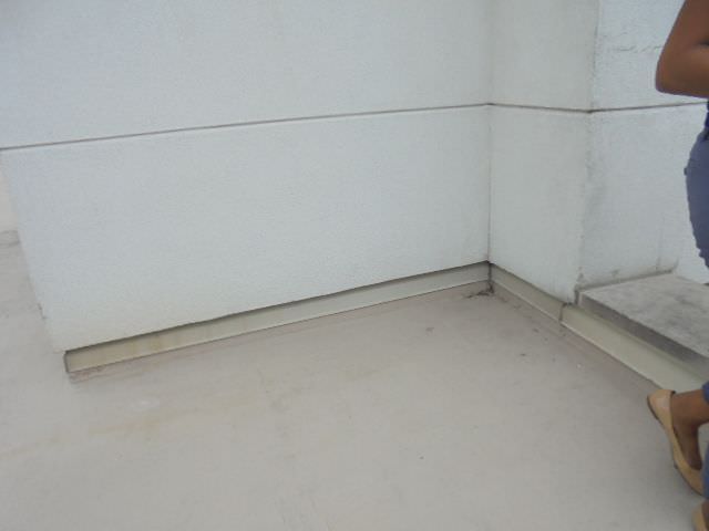

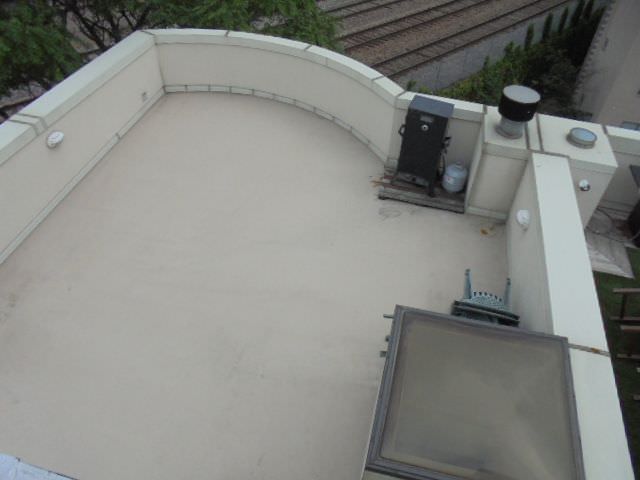

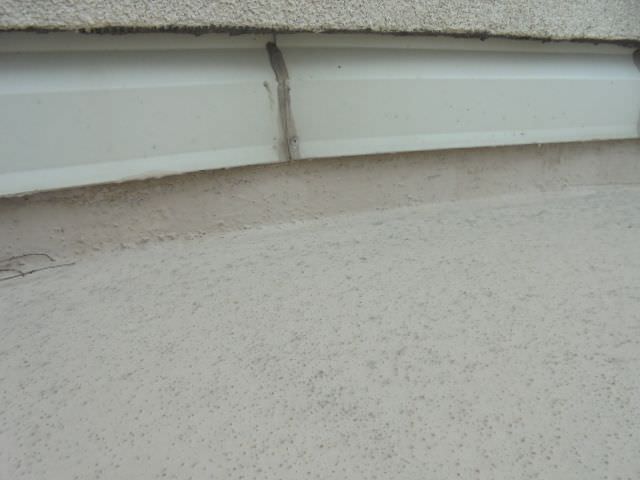

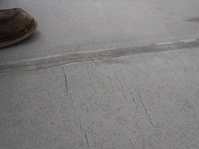

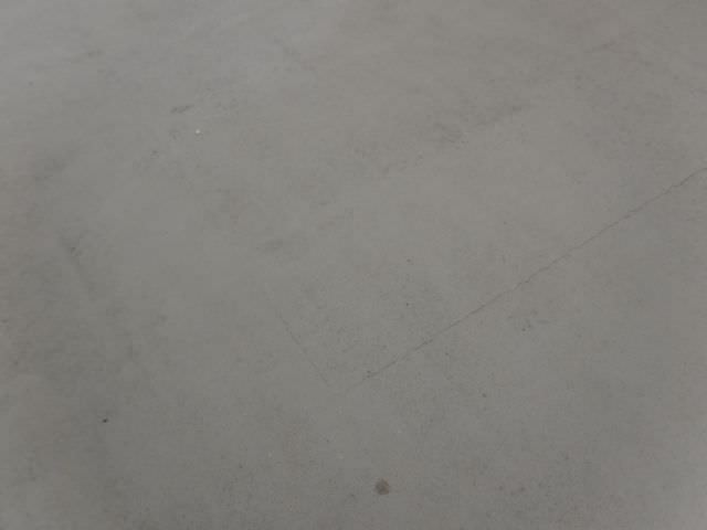

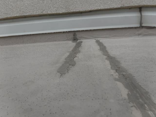

Mike Lamb Posted September 10, 2016 Report Share Posted September 10, 2016 This was a hard plastic underfoot. It was seamless but I could see some faint 4x8 patterns. One section was patched. Is this fiberglass? Any insights are appreciated. Click to Enlarge 34.32 KB Click to Enlarge 36.94 KB Click to Enlarge 17.67 KB Click to Enlarge 21.44 KB Click to Enlarge 34.83 KB Click to Enlarge 29.81 KB Link to comment Share on other sites More sharing options...
Chad Fabry Posted September 10, 2016 Report Share Posted September 10, 2016 It looks like fiberglass. Too bad they botched it up by sealing the cracks with goo. Link to comment Share on other sites More sharing options...
Jim Katen Posted September 10, 2016 Report Share Posted September 10, 2016 On my monitor, it looks like a really bad installation of Gacodeck. However, Gacodeck is not hard; it's rubbery and you can dent it with your fingernail. I'm not aware of any fiberglass product that can be installed in that manner. If it's fiberglass, it's a grossly incorrect installation. Link to comment Share on other sites More sharing options...
palmettoinspect Posted September 10, 2016 Report Share Posted September 10, 2016 It looks like a product similar to Seal-o-Flex or Hydro-Stop. Commonly refereed to as Liquid Applied Deck System. They're quit popular around here. There's a few different brands that have similar product system and many different finish coats so identifying the exact manufacture is difficult. I usually refer to them as a Paintable Rubber Membrane or Liquid Applied Deck System. They require periodic recoats every so many years. The system in the pictures you have is in poor shape and is in need of a repair/recoat. I wouldn't be surprised if there's leaks. http://www.emagcloud.com/Siplast/Sealof ... eMagV2.pdf Link to comment Share on other sites More sharing options...

kurt Posted September 11, 2016 Report Share Posted September 11, 2016 I don't know anything about the roof cover, but the flashing and coping details are a disaster if that's a standard Chicago single wythe masonry parapet. Link to comment Share on other sites More sharing options...
Mike Lamb Posted September 11, 2016 Author Report Share Posted September 11, 2016 There was very little standard about this building. Three units with one 4500 square-foot condo which had its own elevator. Wall construction was CMU with EIFS finish all around. Link to comment Share on other sites More sharing options...
kurt Posted September 11, 2016 Report Share Posted September 11, 2016 I've never seen a roof even slightly similar to that, but we're seeing dozens of wall issues in the repair business. More than I could have imagined in ways I wouldn't have believed 8 years ago. CMU with wood floor platforms is it's own little (big) perfect storm. Stucco on CMU without parapet ventilation and impeccable flashing detailing is in the same league as some of the stuff Cramer's finding in Florida. CMU cavity and core ventilation is critical. Link to comment Share on other sites More sharing options...

hausdok Posted November 20, 2016 Report Share Posted November 20, 2016 It looks like a really poorly done urethane membrane. If you saw the pattern of the decking beneath it the installer failed to detail the joints between decking and then applied the surface material way too thin. You start with a clean deck - preferably marine-grade plywood. The plywood is roughed up on the surface with some 80-grit and then flashings are installed 12 to 18-inches up the inside of the parapet walls and the sides of the house and integrated into any pan flashing below the doorway to the house. Coil stock is bent to form a trough that will pass through the parapet for scuppers. A hole will be cut in the up flashings where the scuppers are located and then the inside ends of those scuppers are inserted through the holes, notched and bent flat to the flashings. A special primer is painted onto the floor, onto the flashings and up the up-leg to a height several inches above where the siding is to end above the balcony. They allow the primer to dry for about an hour and then a thin layer of liquid urethane is applied with a squeegee over the flat leg of the flashings out onto the wood for about four inches, over every seam in the plywood deck, and over the marriage points between the up-leg of the flashings and the doorway sill pan and the scuppers as well as onto the outside of any floor drain flanges. Fiberglass mesh is imbedded in the urethane to strengthen the membrane where there are joints in the plywood, over all vertical joints in the up flashings, and at all other transition and marriage points, the squeeze-out is smoothed out and then they leave and allow the surface to cure for about another twenty-four hours. The next day the installer comes back; and, using his trusty squeegee, the installer applies a thin coat over everything. That coat is about 1/16-inch thick; and, if it's done right all transitions where the flashings change from metal to wood deck, where the metal is bent at the scupper onto the up flashings, the joints in the deck, and all metal tabs are all smoothed out and none are visible. The installer leaves and gives it 24-hours to cure. The next day, he's back again and applies only enough urethane to make the surface sticky. He then sprinkles a thin even coat of fine sand into the wet urethane and leaves. The next day he comes back, uses a soft-bristled brush to sweep away the excess sand, blows off any loose sand using an air tank and nozzle and then applies a finish topcoat to the deck to seal the sand in place. Nobody is allowed to go onto that balcony for the next two (preferably three) days. After the stuff has cured properly, the cladding can be installed on the walls of the house on the inside of the balcony and the inside walls of the balcony parapet, being careful not to drive any nails through those flashings any closer than about six inches from the balcony floor. If he's done it right, when it's all finished the membrane will be about 1/8 to 3/16-inch thick and extremely durable. Like Jim said, you should be able to push your thumb into the surface and the little ding your nail makes in the membrane should slowly disappear. None of the fiberglass mesh, the seams between adjacent pieces of plywood decking, the transition points between flashings and deck or where the scuppers and drains are integrated into the balcony will be visible. The last time I had a deck or balcony surfaced with that stuff, that was done the way it appears to have been done in your picture, the adjective I used to describe the application was abysmal. Link to comment Share on other sites More sharing options...
John Kogel Posted November 21, 2016 Report Share Posted November 21, 2016 [br Click to Enlarge 21.44 KB I pick this one. [] Fiberglass is hard, like a boat or truck cap. The mat is laid up over the entire surface,with a gel coat topping. No give, no dents at all, no painting ever. Fiberglass deck covers are about the best possible deck for a wet climate, IMO. Link to comment Share on other sites More sharing options...
