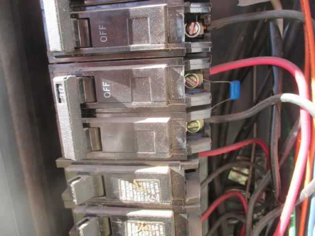

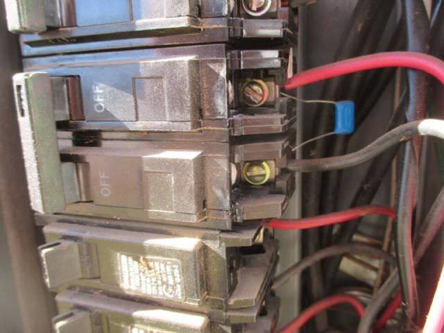

Unknown blue thing
JEuriech
It's a capacitor used to allow signals injected into one 120 supply to reach destinations on the other 120v supply. The coils in the thermal/magnetic breakers are an obstruction to those signals, so that little capacitor bypasses them. Installation on any two-pole breaker would work.

More specifically, the green one is a 650 volt 100K mfd capacitor.
Also the guy on Jim's site says don't put it on a dryer breaker as it may heat up from surge at startup. It can actually go across any two adjacent breakers.

A capacitor with a voltage rating that high and that much capacitance would be at least ten times larger than that little thing.
I don't know what it's capacitance actually is.

I looked up a schematic for this yesterday. I didn't recognize the phase coupler as just a capacitor and I was curious what else was included in the small package. For those interested but not interested enough to click the link, 0.1 uF is the capacitor size listed. For an explanation including the math, http://www.laureanno.com/Coupler-and-Blockers.html

That design combines a coil with the 'blue thing' to increase the signal carried from one 120V source to the other. The values for each component needs to be exact as the combo in this configuration creates a circuit that resonates at the X-10 frequencies. Its like a warp tunnel.[;)]
If the capacitor didn't work well enough, I'd use this design. It's very simply to make.

You are right, I tried to read the label and got a bunch of zeros misplaced. The voltage rating is 650 v, the capacitance could be 0.1 mfd.
Thanks Chad, for the link. They improve the design with the coils so it blocks noise, where the capacitor alone just acts as a jumper at that frequency, so the X-10 signal can pass, I think. Its a notch filter but I'm not sure if it is blocking that frequency or letting only that frequency pass. ??

Series resonant circuits facilitate the transmission of frequencies at or near the resonant frequency of the circuit.
Parallel resonant circuits attenuate the transmission of frequencies at or near the resonant frequency of the circuit.
The design in question is a series resonant circuit.
