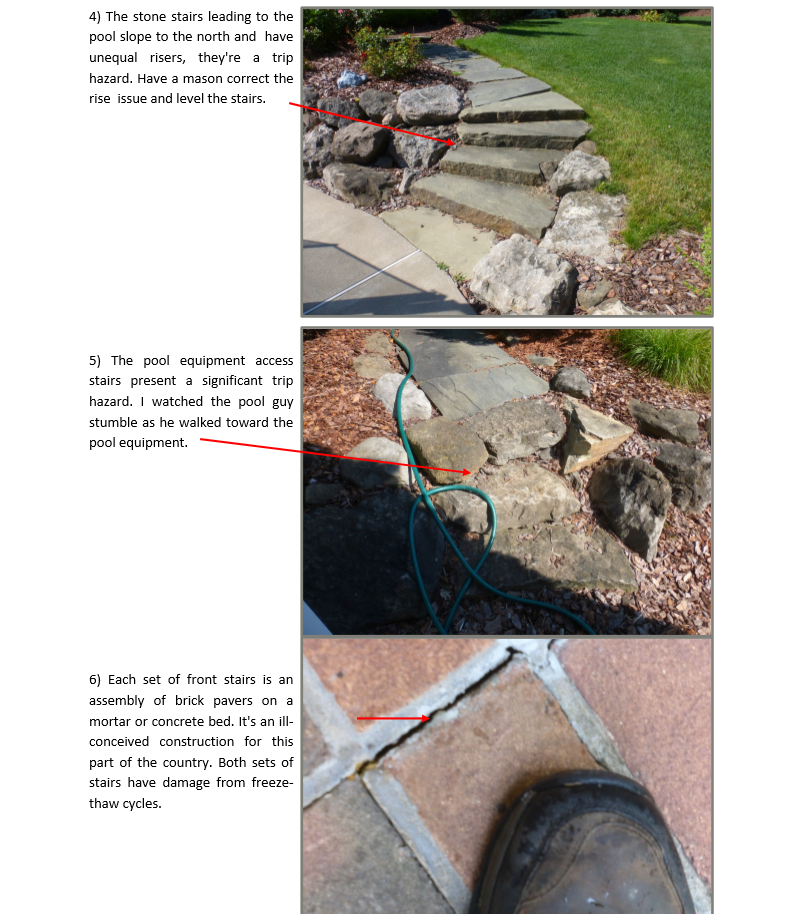

Marc Posted February 10, 2017 Report Posted February 10, 2017 I've just used Excel to get some features that Word doesn't have. Text and related photo are now side by side. Text on left and photo on right. Real neat. Click to Enlarge 39.24 KB Word would automatically move it to the bottom of a double columned-page. Anyone else using Excel? Marc

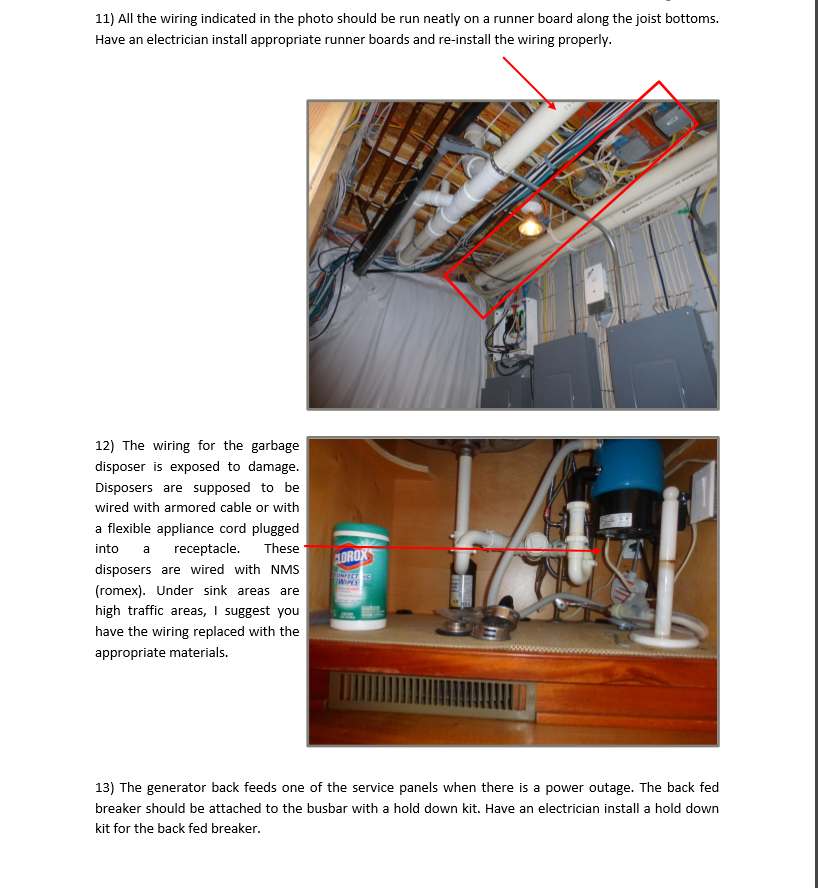

Chad Fabry Posted February 10, 2017 Report Posted February 10, 2017 I don't use excel but my report pages look pretty much the same as yours. Here are a couple of screen shots of pages generated using Inspect Express- the software Mike Brown developed. It's a Word overlay so there must be a way to do it in Word. I can drag the photos anywhere but things get a little funky when trying to place a photo right at the top or bottom of a page. Click to Enlarge 716.5?KB Click to Enlarge 1099.25?KB

Marc Posted February 13, 2017 Author Report Posted February 13, 2017 Marc, you might want to check Word Help for Column breaks and Section break Next Page. Or, as Bryan said, a two column table. I already use double columns which will automatically move your photo to the bottom. That was my problem. I wanted the photo to stay where I put it, right besides the relevant text. I think Bryan was suggesting individual double-column set-ups, one for each text/photo pair. The 'beef' of my reports in Word were previously a single long double-column set up and that worked until I decided I wanted the photo besides the relevant text instead of following it. Marc
