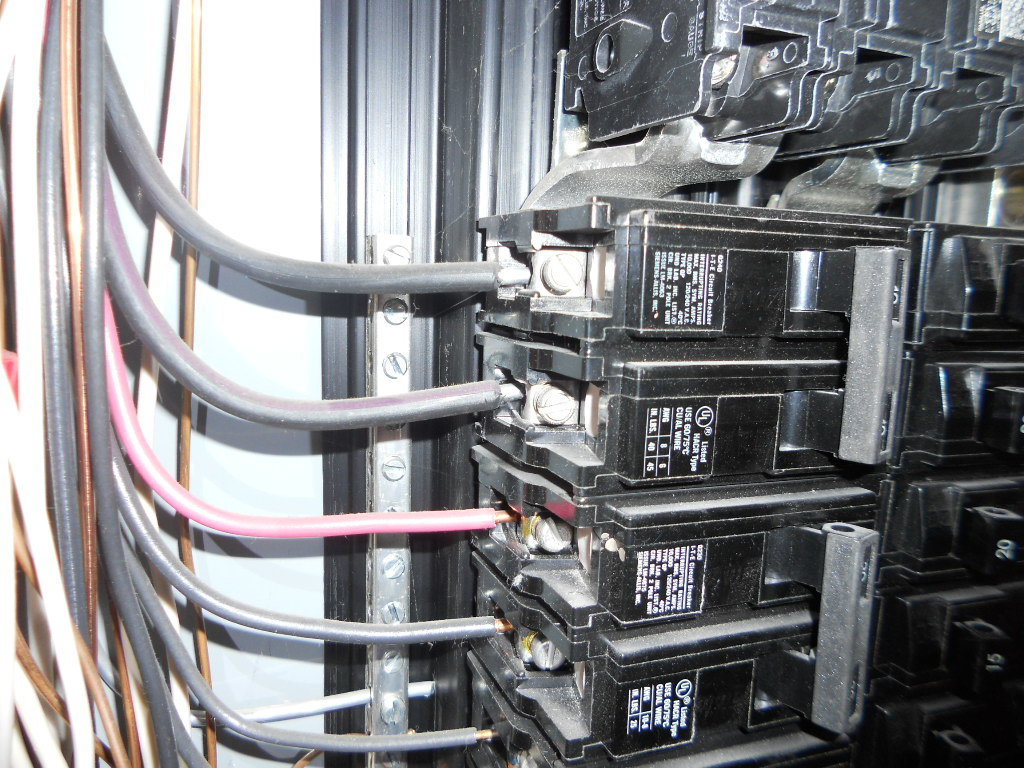

greyboy39 Posted June 4, 2018 Report Share Posted June 4, 2018 So, I don't see aluminum wiring to often unless its' stranded and typically it's the SEC. At todays inspection solid aluminum #8 was observed at a double pole 40 amp breaker which is serving the electric range. Getting conflicting information about #8 having the capability to serve 40 amp breakers and am wondering if it is adequate and do ya'll make your clients aware of of its' presence regardless of adequacy. It was marked as XHHW #8 and was in a house built in 1986. Top two wires in pictures and picture of the wire jacket is included but apparently not a very good one. Quote Link to comment Share on other sites More sharing options...
Erby Posted June 5, 2018 Report Share Posted June 5, 2018 You wire is OK for the breaker but is 40 Amps adequate for the range. Some ranges require 50 Amps.https://www.cerrowire.com/ampacity-charts Quote Link to comment Share on other sites More sharing options...
inspector57 Posted June 5, 2018 Report Share Posted June 5, 2018 1 hour ago, Erby said: You wire is OK for the breaker but is 40 Amps adequate for the range. Some ranges require 50 Amps.https://www.cerrowire.com/ampacity-charts Wrong chart, that one is for copper. Quote Link to comment Share on other sites More sharing options...
inspector57 Posted June 5, 2018 Report Share Posted June 5, 2018 http://www.usawire-cable.com/pdfs/nec ampacities.pdf Try this one. Quote Link to comment Share on other sites More sharing options...

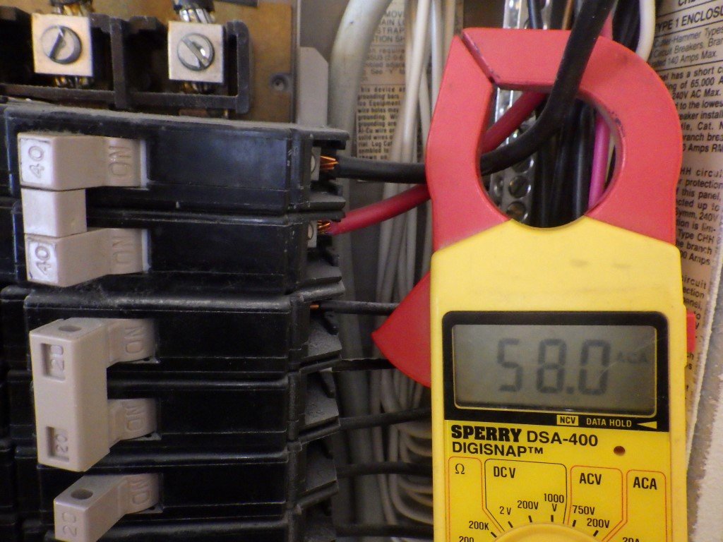

Jim Katen Posted June 5, 2018 Report Share Posted June 5, 2018 Erby's chart shows the aluminum ampacities way over on the right side. Both charts (and the NEC) allow #8 SER cable to be used on a 40 amp circuit (you have to use the 75-degree column, which is fine if all of the terminals in the circuit are marked for 75 degrees, which they almost certainly are). On many ranges, the installation instructions will specify either a 40- or 50-amp circuit, even though the range is capable of drawing more than that. I suspect that the manufacturer figures you won't run all of the burners on high at once. Being the suspicious type, I've tested this several times on several ranges. The 40-amp breakers rarely trip, even when the amp draw creeps up above 40 amps for a while. Quote Link to comment Share on other sites More sharing options...
Jim Katen Posted June 5, 2018 Report Share Posted June 5, 2018 This was from a 13.5kw range. The installation manual said that it was supposed to be installed on a 50 amp circuit. The breaker did eventually trip, but it took a surprisingly long time. Quote Link to comment Share on other sites More sharing options...
