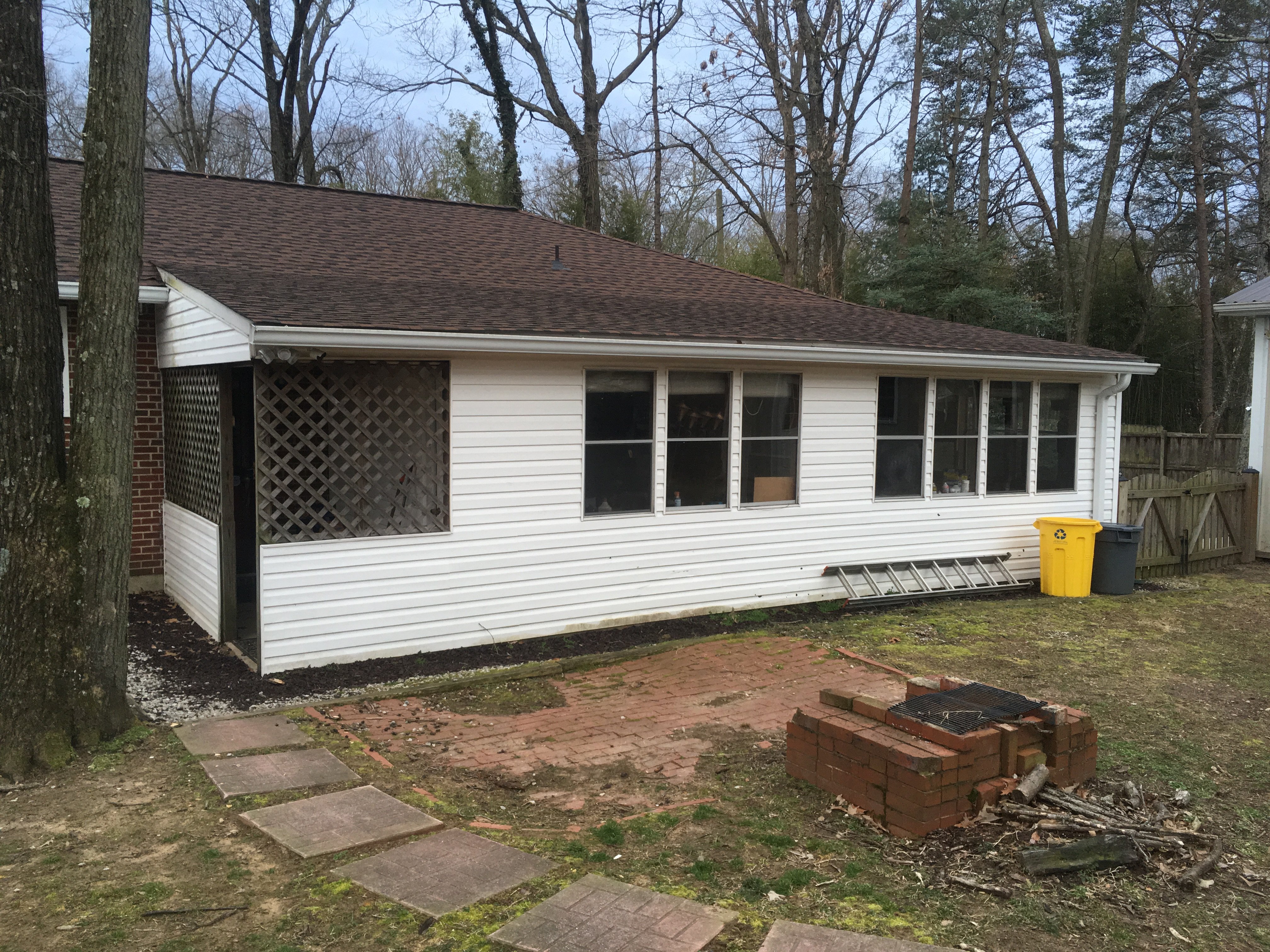

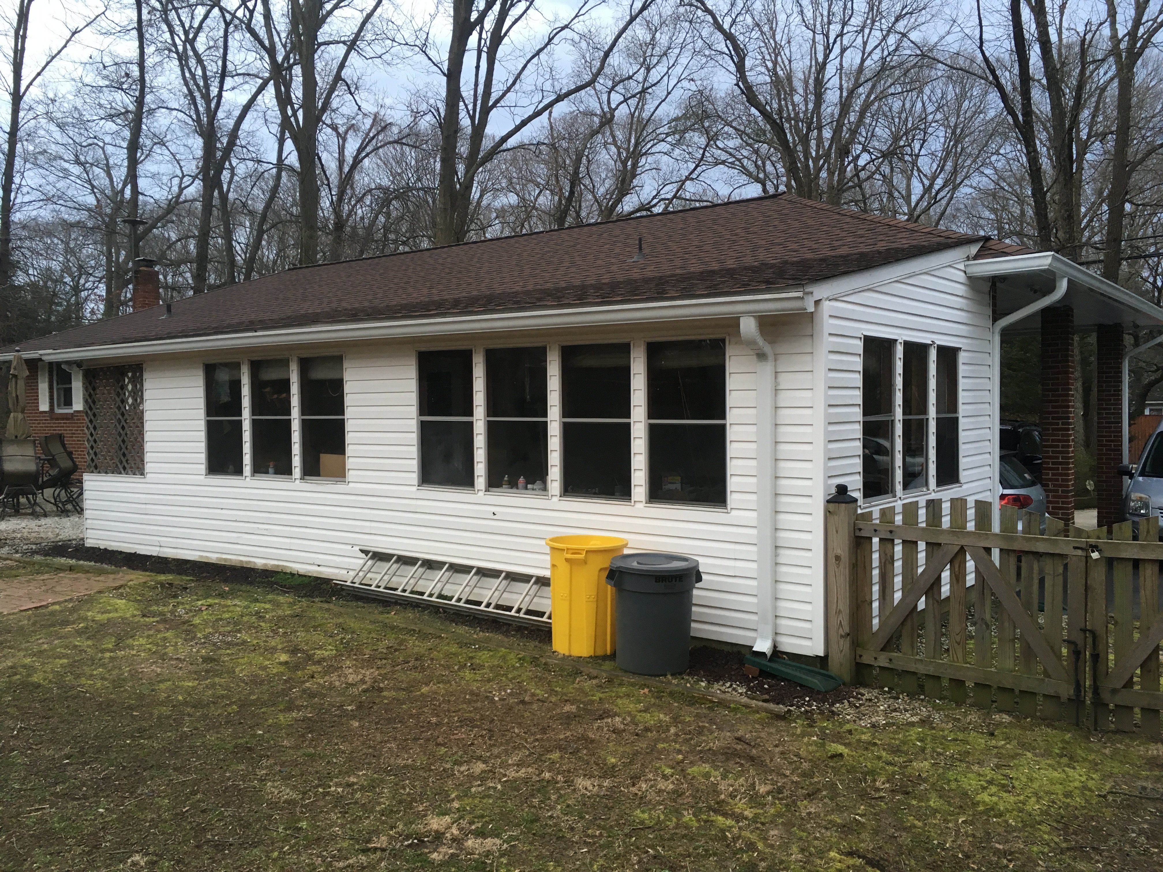

John Dirks Jr Posted February 22, 2019 Report Share Posted February 22, 2019 What better place to turn for suggestions and guidance than here? We're fixing up the back porch into a patio enclosure. While in the process of planning I'm thinking about the ceiling. I want to do this relatively inexpensive and I'm thinking about vinyl soffit panels for the ceiling. The ceiling is a 2:12 pitch over a floor space of 12 by 24 feet. We want to run the linear feature long ways so obviously there would be seams. If I trim the mounting tab properly, will the panels overlap fairly good? Here's the material. > https://www.lowes.com/pd/12-in-x-143-75-in-white-vinyl-solid-soffit/1095077?cm_mmc=shp-_-c-_-prd-_-lbm-_-google-_-lia-_-103-_-vinylsiding-_-1095077-_-0&kpid&store_code=2594&k_clickID=go_625667893_34613737510_111132545110_aud-299487635210:pla-259301822122_c_9007872&gclid=Cj0KCQiAtbnjBRDBARIsAO3zDl8FCfrDwEjD01hfqOelkr4x81qnTGBfdZiXod3dGprfwQsTfgZF7RsaAvNLEALw_wcB Quote Link to comment Share on other sites More sharing options...

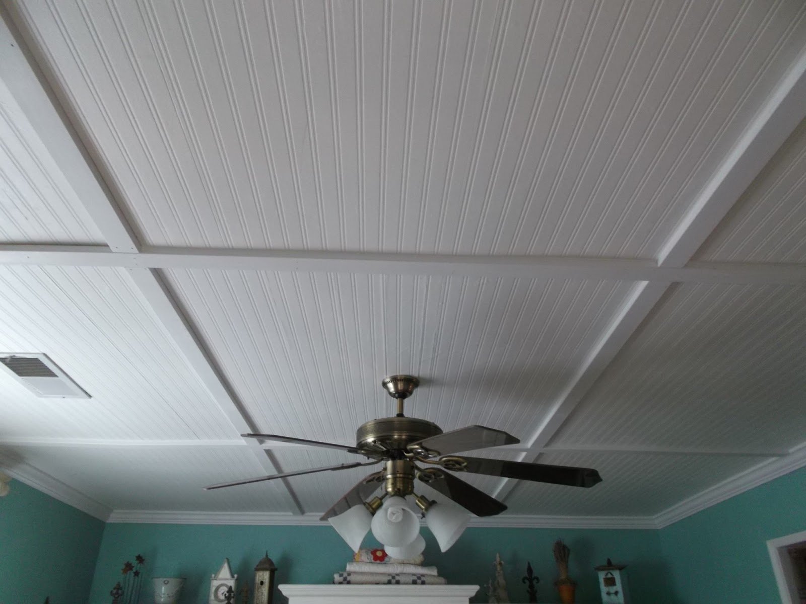

Bill Kibbel Posted February 22, 2019 Report Share Posted February 22, 2019 I would choose 4x8 sheets of beaded fiber cement (HardieSoffit). Quote Link to comment Share on other sites More sharing options...
Tom Raymond Posted February 22, 2019 Report Share Posted February 22, 2019 No, they won't lap nicely. Add strapping and run them the other way, or divide the space with H channels. Or select a different material. Tongue and groove cpvc is nice. Quote Link to comment Share on other sites More sharing options...

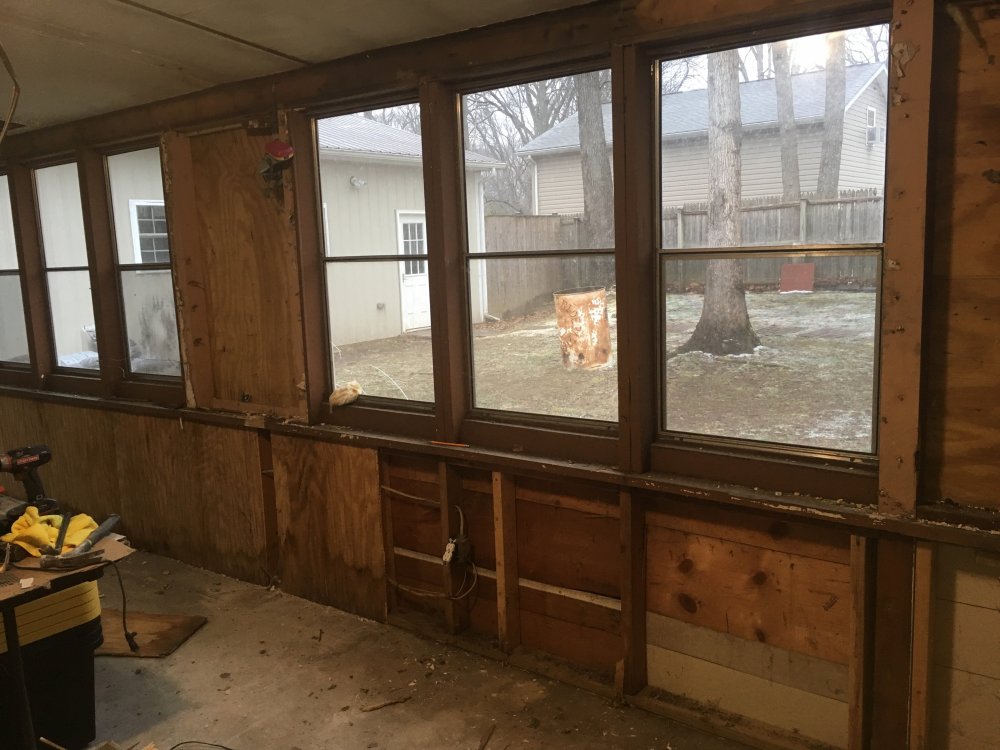

John Dirks Jr Posted February 23, 2019 Author Report Share Posted February 23, 2019 (edited) Thanks for the replies everyone. The ceiling material (whatever the choice) will get affixed to framing that is constructed under the rafters. The rafters are 2"x6" and I think the framing beneath them is also 2"x6". The underside framing is pretty straight and currently has 1/4 inch plywood on it running length wise with the structure. The 4'x8' sheets always held good and never looked warped. The only thing it suffered from was the roof leaks and that is no longer an issue. The 16" on center framing could surely serve well for affixing 4'x8' beaded hardboard. I like this idea since it not only looks nice but might even cost a tad less then vinyl. Maybe not when you include efforts for paint and trim. I'm going to try and convince the Mrs to the beaded hardboard panels idea. If we decide to go with vinyl, we have already agreed to change the direction which will require strapping like Tom pointed out. The benefit in this choice is, the direction change would eliminate butt end overlaps. Tongue and groove cpvc would also be nice but the cost of that material would severely dent our budget for this project. If vinyl winds up being the material of choice, the nailing tabs are slotted and I'd be sure to keep fasteners slightly proud to allow movement. I'd keep slack at the ends in the trim channels too. I'd keep it all a floating assembly just like vinyl siding is done. Here's a beaded panel ceiling example. Heres the porch we’re working on. Here’s the current ceiling. Edited February 23, 2019 by John Dirks Jr Quote Link to comment Share on other sites More sharing options...
Bill Kibbel Posted February 23, 2019 Report Share Posted February 23, 2019 I don't like plastic anything. The fiber cement is really quick and easy. If you dont have one, grab a cheap drywall lift from Craigslist or Horror Fright. Quote Link to comment Share on other sites More sharing options...
Jim Baird Posted February 24, 2019 Report Share Posted February 24, 2019 I think you can get beaded material in 3/8 plywood too. Not so heavy as fiberboard. Quote Link to comment Share on other sites More sharing options...

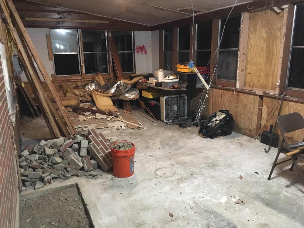

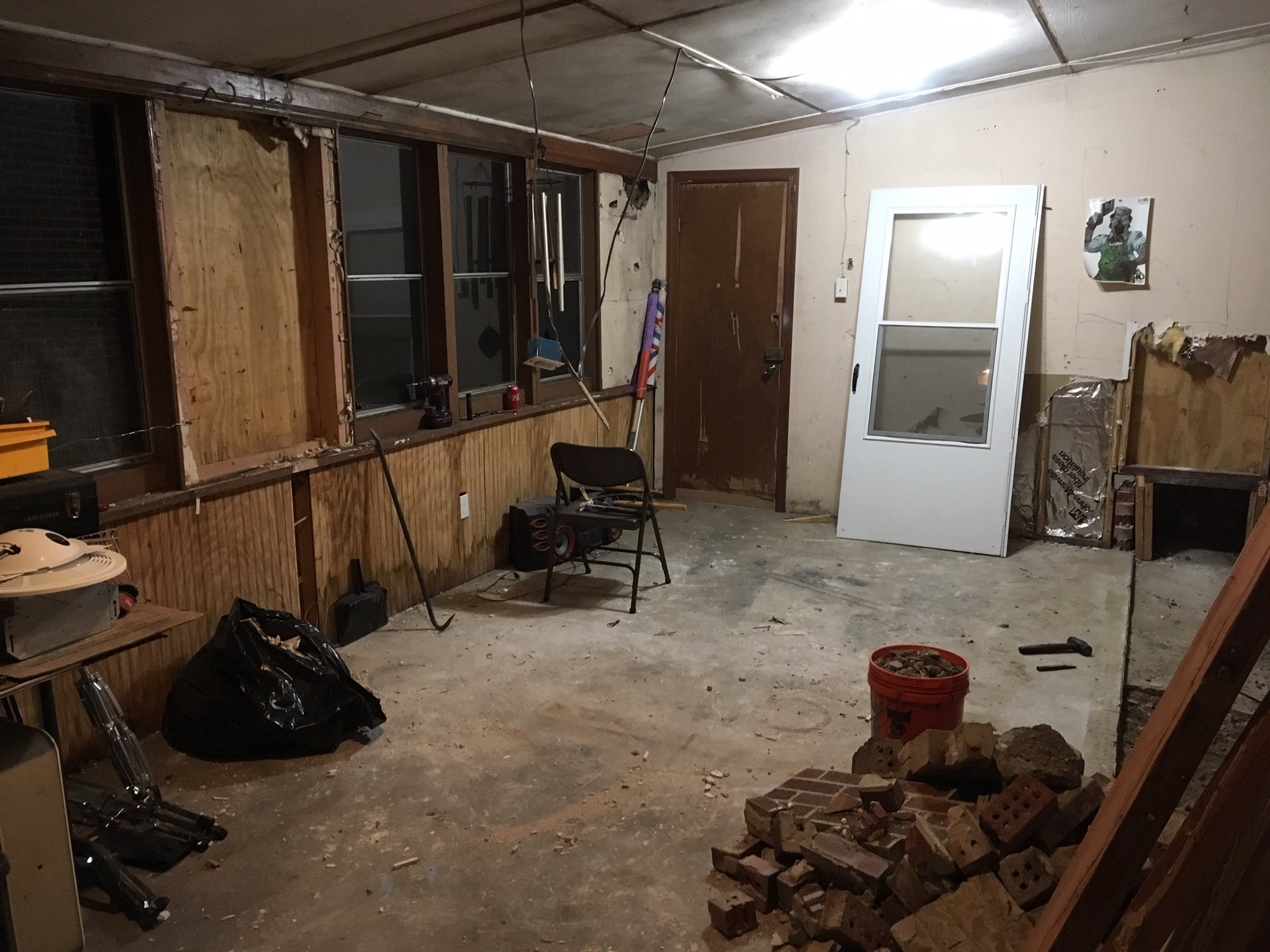

John Dirks Jr Posted February 25, 2019 Author Report Share Posted February 25, 2019 I got started on the interior demo today. I'm feeling my 54 year old body now. No pain at all when I'm working because adrenaline is abundant in me. When I begin to relax after working is when I feel it. The space had been divided by a wall in 1980 and was used as a small apartment for several years. There was also a brick garden bed across the back of the house as far back as the 60's. I removed the partition wall (non bearing) and knocked out the brick garden bed. Where the garden bed was, the slab will have to be filled in. I'm wondering if I'll try my hand at concrete finishing or farm that part out. The finished exposed concrete needs to look good and match the existing surface as close as possible. The plan is to paint the concrete floor and use a throw rug here or there. Here's some pics of the process thus far. Quote Link to comment Share on other sites More sharing options...
Marc Posted February 25, 2019 Report Share Posted February 25, 2019 Heck, given the many trades you've ventured within since I joined this message board ten years ago, you'll likely master the concrete finishing by the time you finish this project. I'm jealous. Quote Link to comment Share on other sites More sharing options...

John Dirks Jr Posted March 3, 2019 Author Report Share Posted March 3, 2019 Thanks for all the suggestions on the finishing. We still have time to make decisions so nothing is settled yet. On to some structural choices. There will be multiple sliding glass doors across the back wall. The header is a double 2x8 and the distance between the header and slab is roughly 82 1/4”. What should I use as a bottom plate under the door thresholds? I was thinking treated 1x6. Quote Link to comment Share on other sites More sharing options...
Jim Baird Posted March 4, 2019 Report Share Posted March 4, 2019 ...if it is concrete slab I would just flash under what is likely an aluminum threshold. Doubt you will find ground contact treated 1x6 anyway. Quote Link to comment Share on other sites More sharing options...
Marc Posted March 4, 2019 Report Share Posted March 4, 2019 If your door is a standard 6' 8" door, 82 1/4 doesn't leave enough room for a sill plate under the threshold. That 2 1/4 is gonna be taken up by the threshold, top jamb, door/frame gap and header clearance. What Jim said, just flash the threshold. Pan and dam. Quote Link to comment Share on other sites More sharing options...
John Dirks Jr Posted March 4, 2019 Author Report Share Posted March 4, 2019 (edited) Hmmm. The sliding door assemblies I'm looking at call for an 80" rough opening height. If I have 82 1/4, shouldnt a 3/4" plate fit underneath? Something like this https://www.lowes.com/pd/severe-weather-common-1-in-x-6-in-x-10-ft-actual-0-75-in-x-5-5-in-x-10-ft-appearance-treated-lumber/4745765?cm_mmc=shp-_-c-_-prd-_-lbm-_-google-_-lia-_-162-_-treatedlumberanddecking-_-4745765-_-0&kpid&store_code=2594&k_clickID=go_625667893_34613736790_111132543550_aud-299487635210:pla-380703942124_c_9007872&gclid=EAIaIQobChMIwoi90brn4AIVAkOGCh3LwwbdEAQYASABEgJJXPD_BwE Or this https://www.homedepot.com/p/WeatherShield-1-in-x-6-in-x-8-ft-Ground-Contact-Pressure-Treated-Board-253935/206974075 Edited March 4, 2019 by John Dirks Jr Quote Link to comment Share on other sites More sharing options...

John Dirks Jr Posted March 5, 2019 Author Report Share Posted March 5, 2019 I'm not planning a floor covering, just painted concrete. The doors across the back are not generally intended for entry and exit so a 3/4" plate wont make an issue there I dont think. There will be a standard hinged door into the carport area and a slider into the mudroom area for entry / exit. I will discuss the threshold height condition with the boss and get the reaction. Sometimes that alone concludes the decision. But at least I'll keep the thresholds of the doors intended for entry / exit as low as possible. There is another condition with the line of doors across the back. The space between the slab and header is 82 1/4 at one end and fluctuates gradually 1/4" to 3/8" more across the 24 foot length, which alone I'm not too concerned with. The other irregularity is the slab line and header gradually slopes downward together towards the end of the structure. Exactly how much I do not know yet. I'm going to pull a tight string line and use a line level to see how much the droop is. My choice is how to deal with the droop. 1) just run the doors and allow each of them to follow the droop? 2) slightly stagger each door in attempt to keep them closer to a common plane? Obviously, this decision and affect the decision to use 1x as a plate, I mean the 1x would reduce the amount of space I have to fiddle with across the 24 foot span. In the pic below, the porch structure droops off towards the right of the structure. I think the slab was in this position when the structure was framed onto it. I think the framers just followed the slab. Quote Link to comment Share on other sites More sharing options...
