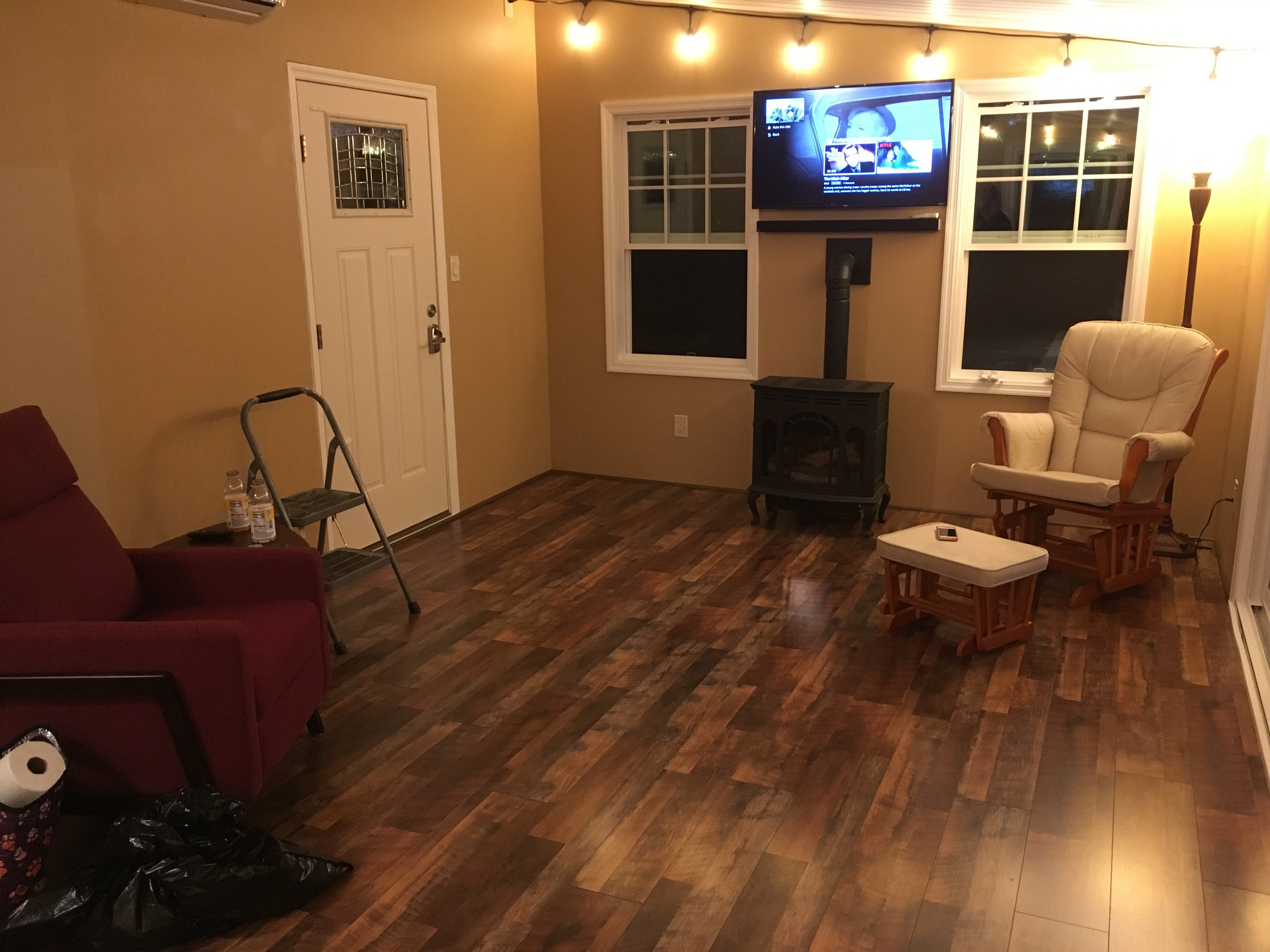

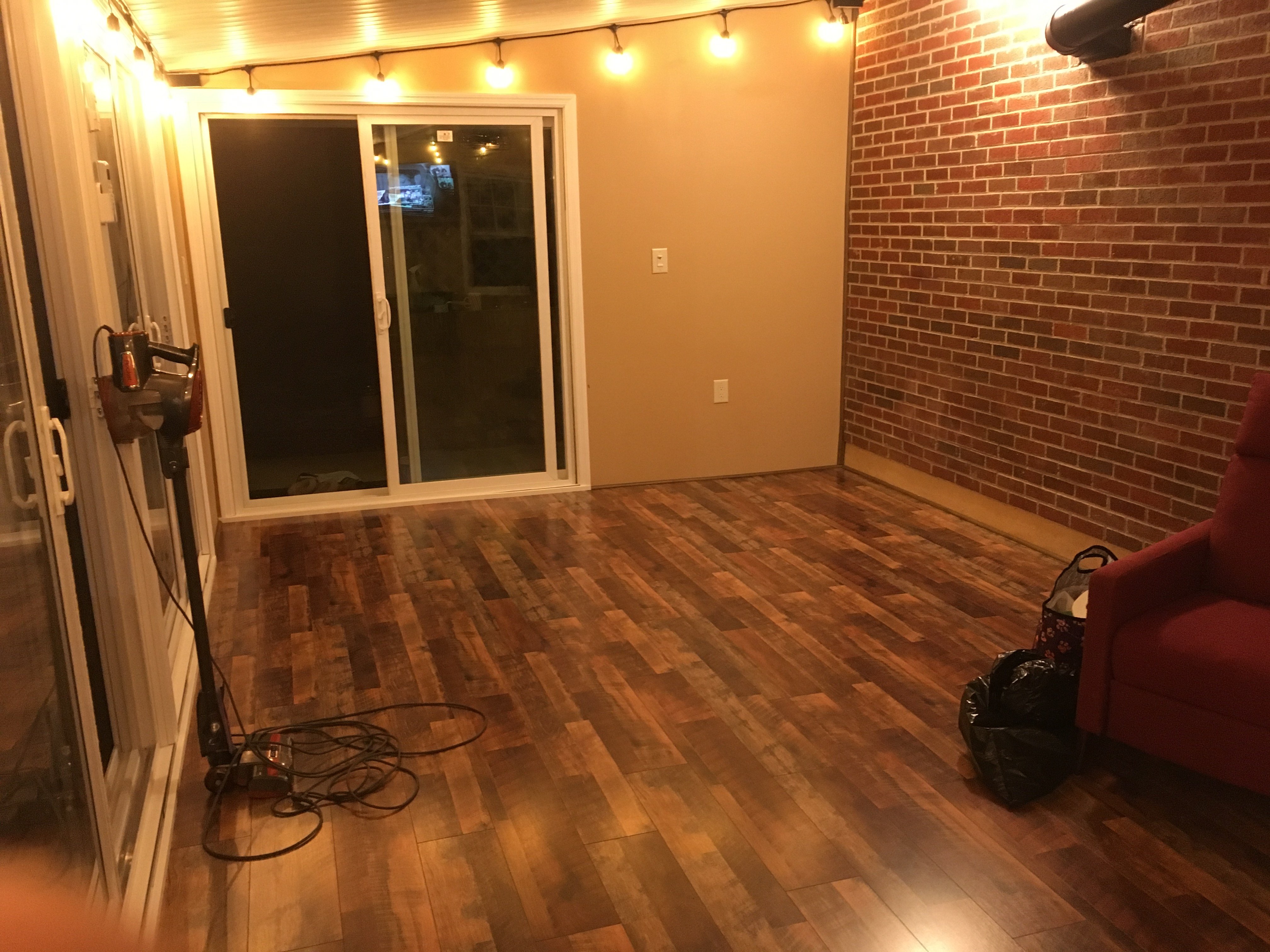

John Dirks Jr Posted June 15, 2019 Author Report Share Posted June 15, 2019 The project is shaping up. We’re putting the finishing touches on. 1 Quote Link to comment Share on other sites More sharing options...

Marc Posted June 15, 2019 Report Share Posted June 15, 2019 Not too hot for the TV in the heating season? Quote Link to comment Share on other sites More sharing options...
John Dirks Jr Posted June 15, 2019 Author Report Share Posted June 15, 2019 2 hours ago, Marc said: Not too hot for the TV in the heating season? All clearance to combustibles are met with extra to spare. As for heat radiating up onto the tv, we’ll have to find out. But I doubt it will be a problem. Quote Link to comment Share on other sites More sharing options...

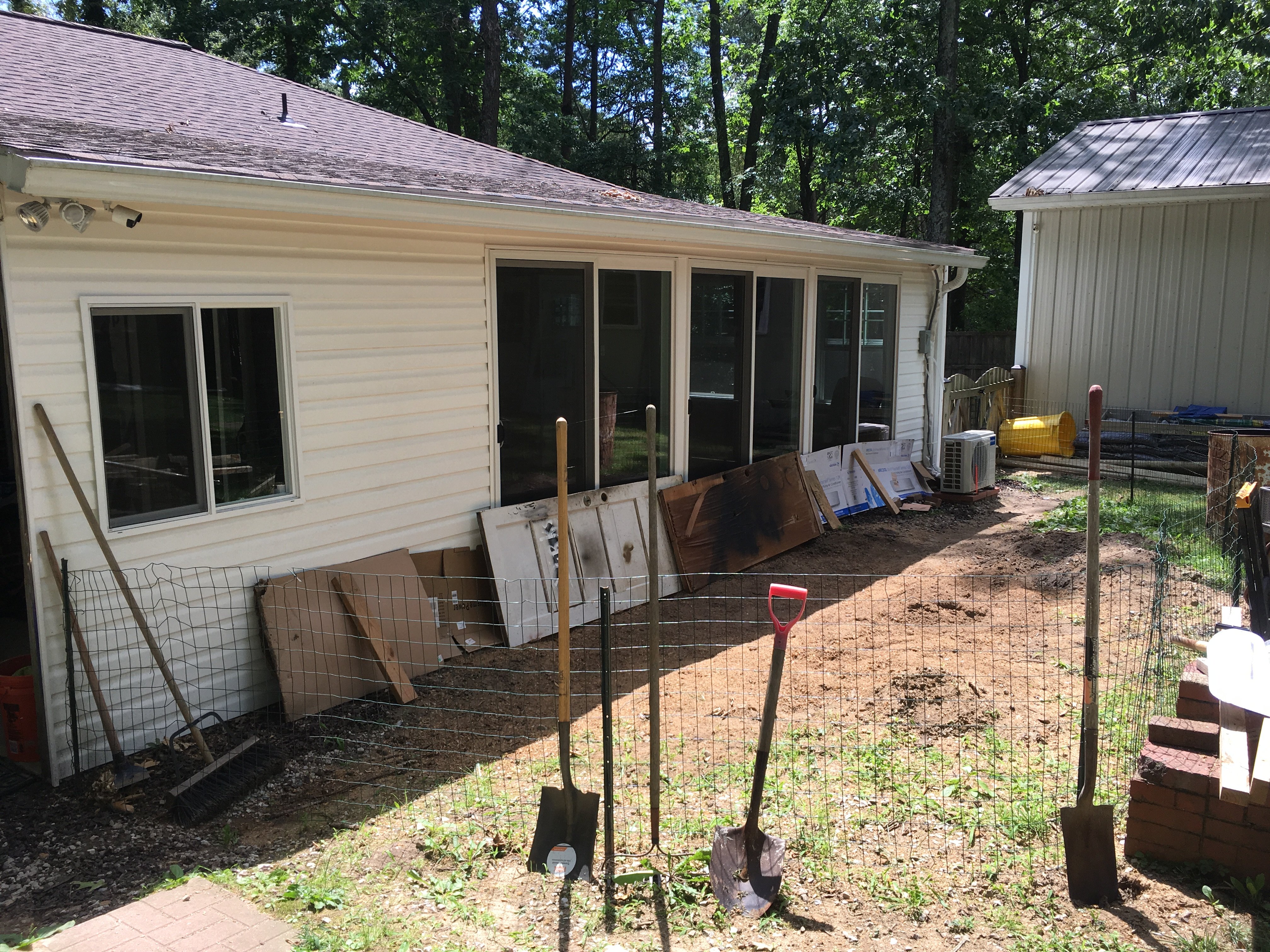

John Dirks Jr Posted June 15, 2019 Author Report Share Posted June 15, 2019 Still working on finishing grade on the outside. There used to be a huge oak tree right there, 3’ diameter. It was growing thick to the point it was almost touching the gutter. Tree experts took it out several years ago and ground the stump. But remaining stump portions and roots were still in my way of getting the grade where I need it to be. I rented a stump grinder and went at it for about 3hrs. Tree parts are still there but now everything is low enough for me to put a decent swale in. Quote Link to comment Share on other sites More sharing options...

John Dirks Jr Posted June 15, 2019 Author Report Share Posted June 15, 2019 I hear ya Marc. All I can say is this back porch slab was always at risk of taking on water if you didn’t tend to any gathering debris during heavy rainfall. Once the tree was taken out, even then we would have an issue now and then. I fixed that by cutting some of the remaining roots that were damming things up. So for a couple years now we’ve had no flooding. After this additional stump grinding and grading, we should be in really good shape and able to handle monsoons without issue. No other drainage issues anywhere on the property. The sandy soil drains good and the basement has always been dry. Quote Link to comment Share on other sites More sharing options...
John Dirks Jr Posted June 15, 2019 Author Report Share Posted June 15, 2019 Here’s one of the best hand grading tools ever. Italian Grape Hoe Quote Link to comment Share on other sites More sharing options...
John Dirks Jr Posted June 16, 2019 Author Report Share Posted June 16, 2019 That old tree with its massive stump still gets the last laugh. I guess these two get cut off short Quote Link to comment Share on other sites More sharing options...

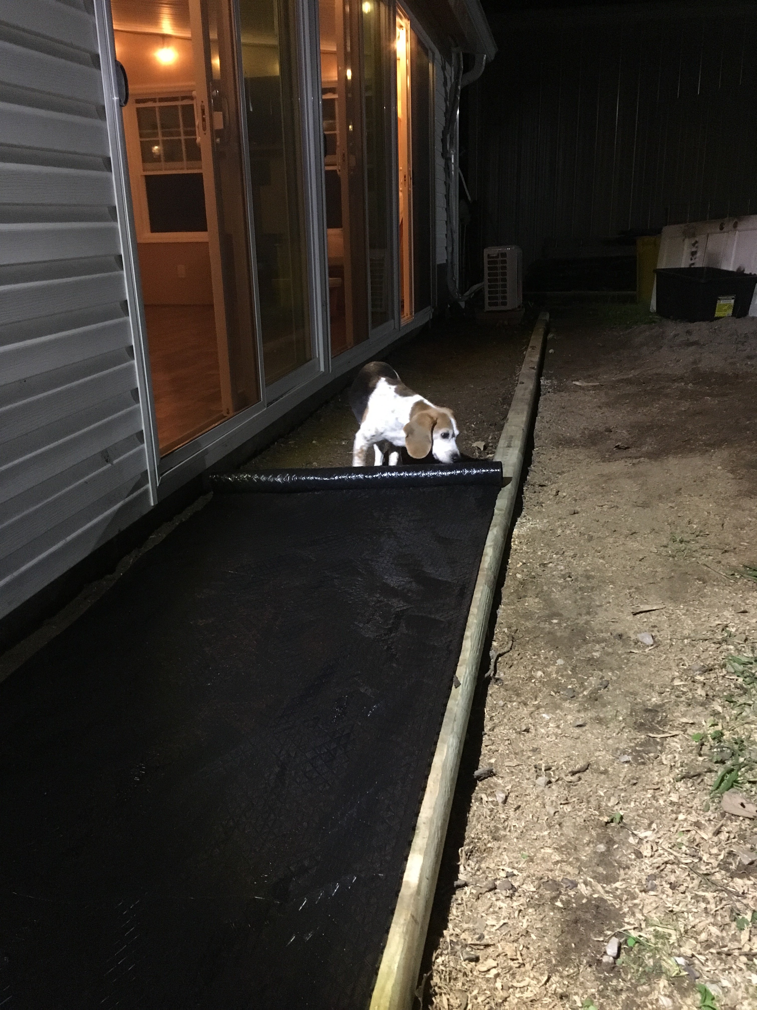

John Dirks Jr Posted June 16, 2019 Author Report Share Posted June 16, 2019 Got the trough graded with a beagle approved weed barrier. In here goes rubber mulch. We have discovered it works for us. It’s not organic so it does not splatter dirt on the wall when pounded with rain. It’s also lighter than dirt and decomposed material so it stays on the surface. Quote Link to comment Share on other sites More sharing options...

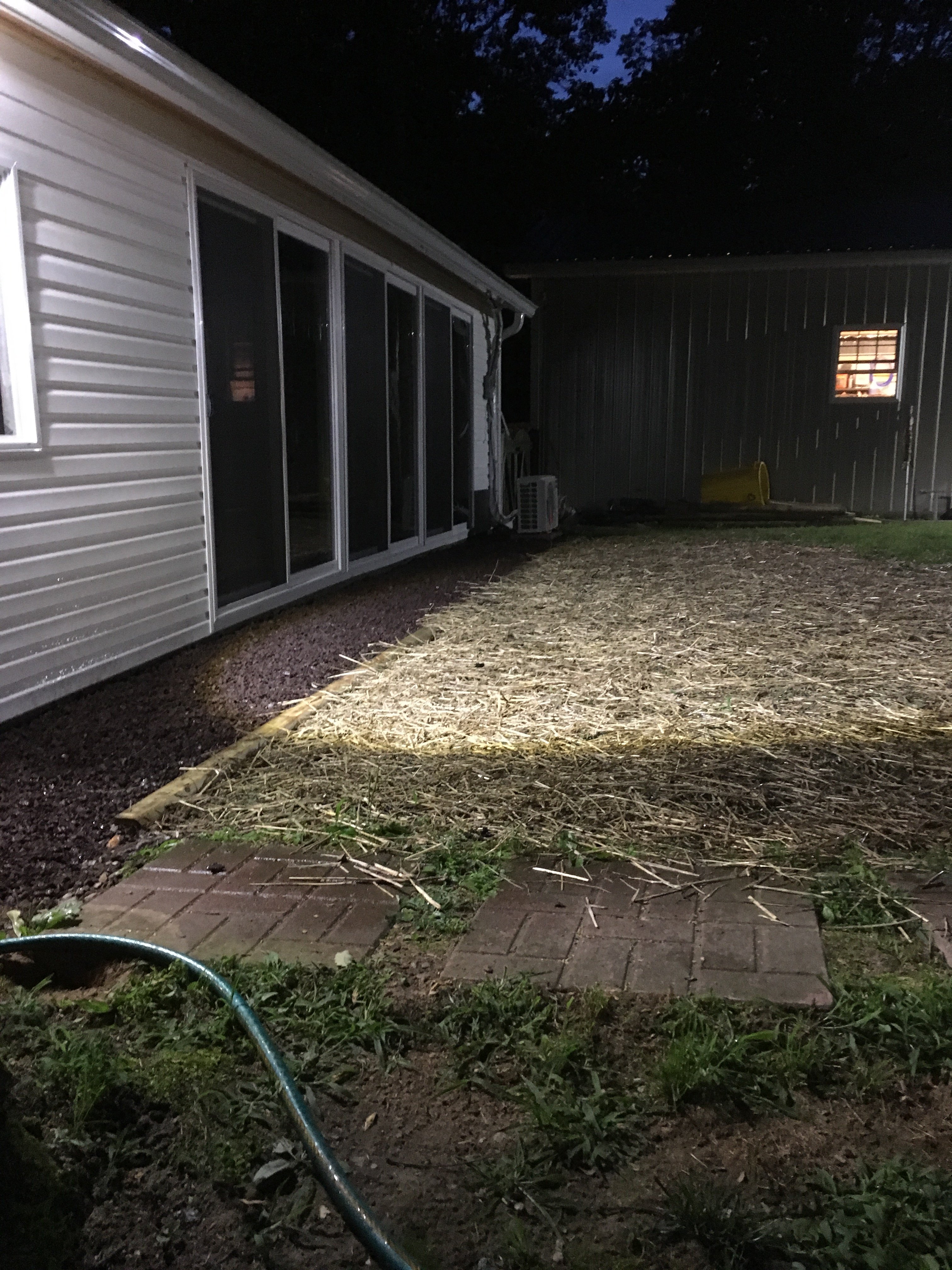

John Dirks Jr Posted June 17, 2019 Author Report Share Posted June 17, 2019 Graded, seeded, light watering, strawed, another light watering. Mother Nature do your thing. I’ll help you with a light watering each day until germination. Then, you make the roots dive for water. Quote Link to comment Share on other sites More sharing options...

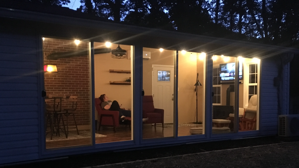

John Dirks Jr Posted June 25, 2019 Author Report Share Posted June 25, 2019 1 Quote Link to comment Share on other sites More sharing options...
Marc Posted June 26, 2019 Report Share Posted June 26, 2019 (edited) That is precisely what I want in my backyard. Thinking a steel moment frame might be a good idea, with storefront glass. Edited June 26, 2019 by Marc Quote Link to comment Share on other sites More sharing options...
Jim Katen Posted June 26, 2019 Report Share Posted June 26, 2019 I salute your energy. Lord knows I don't have the energy for a project like that. Quote Link to comment Share on other sites More sharing options...

John Dirks Jr Posted June 26, 2019 Author Report Share Posted June 26, 2019 The Mrs put this picture show together. I know, I need a real vent termination for the gas stove. The one in there now is just a cheap mock to see if the thing would side vent ok. It does. I’m gonna get a proper one in before the heating season begins. I have a proper thimble in the wall already. Quote Link to comment Share on other sites More sharing options...
