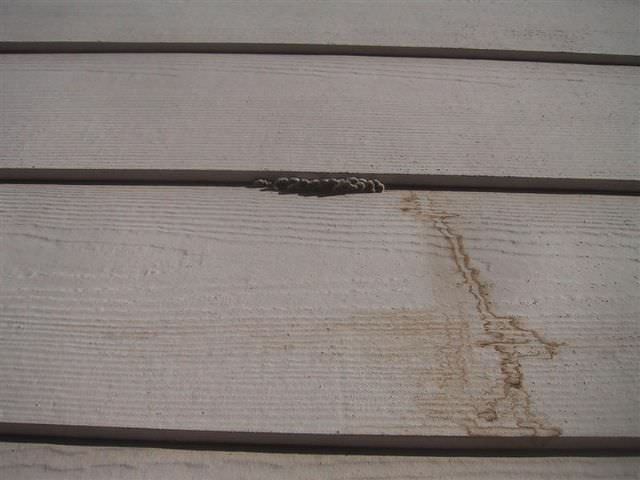

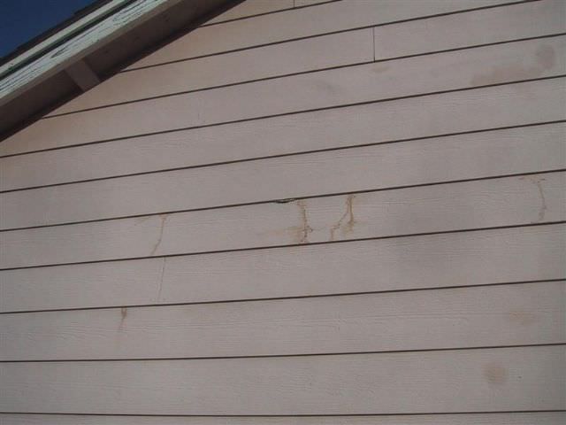

Jim Katen Posted March 22, 2006 Report Share Posted March 22, 2006 The stuff I see isn't from tannins. While I see it on old cedar siding, I also see it on old fir siding. And lately, I'm seeing exactly the same stuff on Hardiplank. I think it has more to do with asphalt from the tar in the felt paper. Here are some pics from a house I inspected in mid February. The house is six years old. This stuff ain't tannin. - Jim Katen Download Attachment: Stains 1.JPG 51.16 KB Download Attachment: Stains 2.JPG 66.98 KB Download Attachment: Stains 3 w Mushrooms.JPG 97.22 KB Quote Link to comment Share on other sites More sharing options...

Jim Katen Posted March 22, 2006 Report Share Posted March 22, 2006 Originally posted by Rob Amaral What else can you tell us about that place with the stains and Hardiplank? Weird.. Moisture issue indoors? Were you able to get at the gable ends (if any)? The bath fan exhaust was ducted to the eave vent. That might have been part of the problem. Otherwise, the situation is exactly like what I see on '50s houses. Brown, syrup-like stains streaking down the siding on the exterior wall of the bathroom. Given that this one had mushrooms growing out from between the siding planks, I told them to remove the siding in this area. My hunch is that the OSB sheathing is a mess underneath. I never heard what happened. - Jim Katen, Oregon Quote Link to comment Share on other sites More sharing options...
