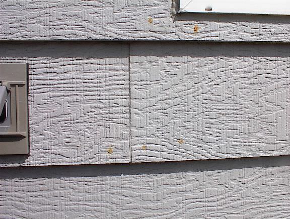

Jim Katen Posted March 23, 2006 Report Share Posted March 23, 2006 Does anyone know what brand of siding this is? It's a hardboard product, like the old Masonite x-90, but the back side is smooth. There's no screen texture that I usually see on Masonite brand products. I also don't remember ever seeing this particular pattern on Masonite. It was installed in 1978. The exposure is 8". Butt joints were covered with aluminum H-channel. Could it be Masonite without the screen texture on the back? - Jim Katen, Oregon Download Attachment: Siding.JPG 81.77 KB Download Attachment: SidingClose.JPG 78.55 KB Quote Link to comment Share on other sites More sharing options...

BlackJack Posted March 23, 2006 Report Share Posted March 23, 2006 I had the exact same product on my house, pressed wood and no markings on the back at all. I was told it could not be identified for class action replacement, also it was too old (1982) and had reached the end of its useful life. They sure used allot of this product in my neighborhood. Never did find out the manufacturer. I replaced it in 2002 with Hardiplank. Quote Link to comment Share on other sites More sharing options...

hausdok Posted March 23, 2006 Report Share Posted March 23, 2006 Hi Jim Have you got The Siding Book? I loaned mine to a fellow months ago and he's apparently forgotten that he has it because it hasn't been returned (hint-hint). I think I saw that produce in there but I can't say for certain. Getting old, not remembering so well anymore. Possibly a Forestex, ABTCo, Smurfit or L-P's Canexel product? Sure wish I had my Siding Book here. ONE TEAM - ONE FIGHT!!! Mike Quote Link to comment Share on other sites More sharing options...

hausdok Posted March 24, 2006 Report Share Posted March 24, 2006 Hi Jim, Some good news (I think). I was talking to L-P this morning about another issue when I mentioned this little scavanger hunt. The rep asked me to point him to the site and as soon as he pulled up the photo he said it was a G-P product but then when he heard that it wasn't screened on the back wasn't so sure. A little while later he called me back to inform me that he'd talked to some of his colleagues and had learned that some G-P products are not screened on the back and that it really depends on where it was made. I then went to the G-P site, called their toll-free number and the operator redirected me to Blue Linx, the outfit that took over the distribution operation for G-P. Left a message and a while later a very helpful fellow named Eric called back. I directed him to your photos and he said that it looks like it's G-P's Catawba Sundance line. If it is that product, the class action closed about 3-4 years ago but it has a 30-year warranty (pro-rated) so it might be possible to make a warranty claim. If so, tell him not to expect much once the stuff has been pro-rated. It sounds like it really isn't worth the trouble. I'd just tell him to tear it off and replace it with Hardi-Plank. Hope this helps. ONE TEAM - ONE FIGHT!!! Mike Quote Link to comment Share on other sites More sharing options...

Jim Katen Posted March 26, 2006 Author Report Share Posted March 26, 2006 Originally posted by hausdok Hi Jim, Some good news (I think). I was talking to L-P this morning about another issue when I mentioned this little scavanger hunt. The rep asked me to point him to the site and as soon as he pulled up the photo he said it was a G-P product but then when he heard that it wasn't screened on the back wasn't so sure. A little while later he called me back to inform me that he'd talked to some of his colleagues and had learned that some G-P products are not screened on the back and that it really depends on where it was made. I then went to the G-P site, called their toll-free number and the operator redirected me to Blue Linx, the outfit that took over the distribution operation for G-P. Left a message and a while later a very helpful fellow named Eric called back. I directed him to your photos and he said that it looks like it's G-P's Catawba Sundance line. If it is that product, the class action closed about 3-4 years ago but it has a 30-year warranty (pro-rated) so it might be possible to make a warranty claim. If so, tell him not to expect much once the stuff has been pro-rated. It sounds like it really isn't worth the trouble. I'd just tell him to tear it off and replace it with Hardi-Plank. Hope this helps. ONE TEAM - ONE FIGHT!!! Mike Thanks Mike. My legwork has revealed almost the same thing. I actually have some photos of confirmed Catawba siding from a past siding consultation (see the attachment). It looks very much like the same critter, but not exactly the same. Notice the horizontal striations that are in my archive pics (meant to simulate wood grain), but not in the pics of this week's stuff. I've also attached a pic of unknown siding from a past inspection. It looks similar to this week's stuff but lacks the vertical striations that are supposed to represent bandsaw marks. Also, the GP rep I talked to told me that they didn't release the Catawba product till 1979 and this house was completed in 1978. Now that's pretty close, so I'm not ruling it out, I just want to know if there are alternative possibilities. The Masonite Woodsman product looks about as close to it as the GP stuff, but I confirmed that Woodsman had a screen-like texture on the backside. This stuff is smooth as a baby's butt. I suppose the next step is to start pulling pieces. - Jim Katen, Oregon Download Attachment: UnknownSiding.jpg 80.69 KB Download Attachment: Catawba2.jpg 89.95 KB Download Attachment: Catawba1.jpg 77.04 KB Quote Link to comment Share on other sites More sharing options...

BADAIR Posted June 9, 2009 Report Share Posted June 9, 2009 I know I've unearthed a ancient post but can anyone definitively identify this as Masonite Click to Enlarge 68.76 KB Click to Enlarge 74.24 KB Click to Enlarge 75.87 KB Click to Enlarge 72.74 KB Click to Enlarge 40.47 KB Quote Link to comment Share on other sites More sharing options...
Jim Katen Posted June 9, 2009 Author Report Share Posted June 9, 2009 I know I've unearthed a ancient post but can anyone definitively identify this as Masonite Yes. In the fourth picture, the X 90 is definitely Masonite. - Jim Katen, Oregon Quote Link to comment Share on other sites More sharing options...
BADAIR Posted June 9, 2009 Report Share Posted June 9, 2009 I know I've unearthed a ancient post but can anyone definitively identify this as Masonite Yes. In the fourth picture, the X 90 is definitely Masonite. - Jim Katen, Oregon I use to be able to remember things like that, THANKS! Quote Link to comment Share on other sites More sharing options...
