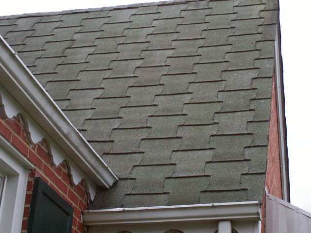

mgbinspect Posted April 26, 2006 Report Share Posted April 26, 2006 I see these shingles a few times a year. They have to be the most durable asphalt shingles ever made. This roof is about 35 years old +/- I'm posting these pictures because I've always wished to know more about this product. Who made it? Why they stopped making it? So, anyone familiar with it, please enlighten me. Download Attachment: 100_0195.jpg 382.06 KB Link to comment Share on other sites More sharing options...
Chad Fabry Posted April 26, 2006 Report Share Posted April 26, 2006 T lock shingles are made by more than a few companies..they're used primarily on barns with gambrel roofs around here. Link to comment Share on other sites More sharing options...
Les Posted April 26, 2006 Report Share Posted April 26, 2006 Chad is right, jeeze that hurts to say. Around Michigan they are common, if in fact the photo is just standard t locks. But I think those are not standard t's. Common t's would go around 285lb per square and yours look heavier. These look like the old johns manville asphalt slate, but are too new for that. Around here we have common t's, diamond lock, interlock, propriatary sherif-goslin modified locking and a few locking strip type. Truth be told I have never seen that exact shingle. Link to comment Share on other sites More sharing options...
mgbinspect Posted April 26, 2006 Author Report Share Posted April 26, 2006 Are they still around, Chad & Les? I only see them on older houses and the shingles themselves are always quite old. They're impressive! As long as they seem to last, I can't understand why they aren't used more. Link to comment Share on other sites More sharing options...
Les Posted April 26, 2006 Report Share Posted April 26, 2006 Here they are almost a status symbol, because of the extra cost. On real estate line-sides they often will promote the fact it has a sherif-goslin or other company roof. Maybe 20% of the market. Very easy to install, but a pisser to flash and they do last a long time. I have seen many 40yrs plus and some old JM type that are 80+. I think interlock are much better than t's and quicker to install. Link to comment Share on other sites More sharing options...
Chad Fabry Posted April 26, 2006 Report Share Posted April 26, 2006 http://www.certainteed.com/CertainTeed/ ... mLok25.htm I almost never see them on anyroofs that are newer than 20 years or so except for barns where they're still used all the time. Link to comment Share on other sites More sharing options...
mgbinspect Posted April 26, 2006 Author Report Share Posted April 26, 2006 I'd definitely have 'em as long as I was planning to live and die in the house. Link to comment Share on other sites More sharing options...

mgbinspect Posted April 26, 2006 Author Report Share Posted April 26, 2006 Now that you mention it, I can imagine they would be fun to flash. Link to comment Share on other sites More sharing options...
kurt Posted April 27, 2006 Report Share Posted April 27, 2006 We called them (me & the guys that used to install them) "farmer shingles", because farmers always wanted them. Why? Because before self sealing shingles, they were the only type that wouldn't blow off the barn. Well, at least they had/have increased resistance to being blown off. Link to comment Share on other sites More sharing options...
Bill Kibbel Posted April 27, 2006 Report Share Posted April 27, 2006 Interlocking asphalt shingles are popular in high wind areas, so I don't see more than 1 or 2 a year. I did see one that was documented to have been installed in 1929. (I think I remember the installers name was K. Mitenbuler) A veteran roofer I know calls them "cereal box top" shingles. Link to comment Share on other sites More sharing options...
hausdok Posted April 27, 2006 Report Share Posted April 27, 2006 Hi, I see those quite a bit on some of the older bungalows around town. I've talked to a couple of roofers about them and they both said that they haven't been commonly used around here for about the last 35 years, which corresponds to what I'm seeing on homes. The ones I've seen were unusually thick and durable though and in amazingly good condition when one takes into consideration that they were at least a quarter of a century old. I lived in Colorado Springs for a year before moving to Seattle in the mid-90's. This type of shingle was on about 80 - 90% of the houses there - or at least so it seemed. I have no idea though whether those were as thick and durable as the ones I'm finding on older homes here. My Roofers Handbook, originally written by W.E. Johnson in 1938 and reprinted by Craftsman Book Company devotes a couple of dozen pages to installing and flashing them. ONE TEAM - ONE FIGHT!!! Mike Link to comment Share on other sites More sharing options...
kurt Posted April 27, 2006 Report Share Posted April 27, 2006 I've seen 'em on very steep pitched gable roofs (farmhouse roofs), where I know for sure they are at least 50 years old. Hard as a piece of slate, but still shedding water. What were they, around 285#, or 320#? Darned thick & heavy stuff, that's for sure. Link to comment Share on other sites More sharing options...
