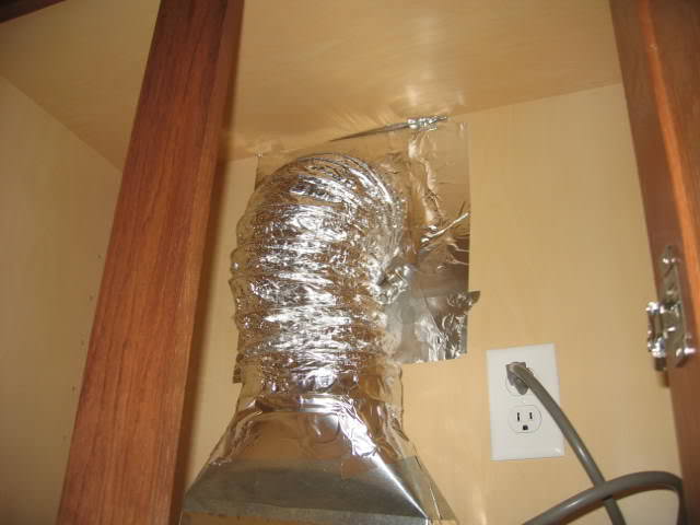

rlskfoster Posted September 12, 2006 Report Share Posted September 12, 2006 New home today has a Hotpoint Microwave/Range Hood Combo. The transition piece was the silver metallic material you see on some dryer transitions. It almost feels like cloth and very flexible. Manufacturers instructions sitting on counter did not specifically identify a type of material to use as a transition, but, it has a picture of a 90 degree elbow. What is the general consensus for this material to be used in this application.I have seen the metal flex duct used for a short transition and found literature to support its use for short transitions, but I am unsure about this. Here is the picture: Buster Download Attachment: Dearinger 002.jpg 44.01 KB Quote Link to comment Share on other sites More sharing options...
hausdok Posted September 12, 2006 Report Share Posted September 12, 2006 Hi, It's a heated location, it's short and they won't be pushing any lint up through it, so it's never going to get clogged. As long as there's a damper in the micowave/fan exhaust outlet it should be fine. OT - OF!!! M. Quote Link to comment Share on other sites More sharing options...
kurt Posted September 12, 2006 Report Share Posted September 12, 2006 What would grease do in that stuff? I'm not saying it's bad and I'm not saying it's good; I'm just curious. Personally, if I was going cheapo & using flex, I'd get the semi rigid dryer duct (you know, the expando stuff....) Actually, I can think of about a dozen better materials & methods for that little elbow; the installer is a maroon. Quote Link to comment Share on other sites More sharing options...
Les Posted September 13, 2006 Report Share Posted September 13, 2006 My two cents worth - that sure looks like Mylar and is worthless for any application, wheather 6" or 6'. It will fail in this application is my world famous opinion. So there! Quote Link to comment Share on other sites More sharing options...
Mike Lamb Posted September 13, 2006 Report Share Posted September 13, 2006 SECTION M1502 RANGE HOODS M1502.1 General. Range hoods shall discharge to the outdoors through a single–wall duct. The duct serving the hood shall have a smooth interior surface, shall be air tight and shall be equipped with a backdraft damper. Ducts serving range hoods shall not terminate in an attic or crawl space or areas inside the building. Exception: Where installed in accordance with the manufacturer’s installation instructions, and where mechanical or natural ventilation is otherwise provided, listed and labeled ductless range hoods shall not be required to discharge to the outdoors. M1502.2 Duct material. Single–wall ducts serving range hoods shall be constructed of galvanized steel, stainless steel or copper. Quote Link to comment Share on other sites More sharing options...
kurt Posted September 13, 2006 Report Share Posted September 13, 2006 Well, that stuff doesn't have a smooth interior surface. But, it doesn't say you can't use flex either. Come to think of it, I've been in some nasty Section 8 crawlers where they've used flex, and it was greased out. I'm w/Les. Stuffs gonna shitcan. Quote Link to comment Share on other sites More sharing options...

swolsen Posted September 13, 2006 Report Share Posted September 13, 2006 I agree with Mike, that looks like Mylar and should not be used in that application. Quote Link to comment Share on other sites More sharing options...

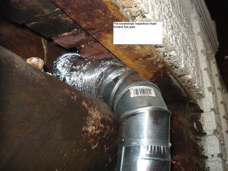

Bain Posted September 30, 2007 Report Share Posted September 30, 2007 You guys are just plain stupid. A licensed HVAC dude used Mylar for a furnace flue pipe, so Mylar has to be okay for a range hood duct. Les, what were you thinking? John Download Attachment: DSC05350a.JPG 93.36 KB Download Attachment: DSC05361a.JPG 96.92 KB Quote Link to comment Share on other sites More sharing options...
Les Posted September 30, 2007 Report Share Posted September 30, 2007 It was a momentary lapse of my insanity!! Quote Link to comment Share on other sites More sharing options...
