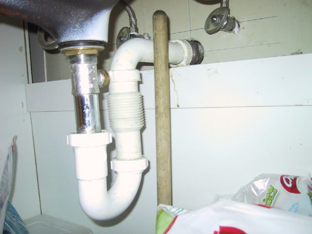

Chris Bernhardt Posted September 18, 2006 Report Share Posted September 18, 2006 Does any one write up for correction P-traps with water seals greater 4" deep? The plumbing code here requires a minimum 2" depth and a max depth of 4". Has anyone every heard of this being a functional problem? I have seen them as deep as 10" on old homes. Normaly I just find the trap installed backwards. Thanks, Chris Quote Link to comment Share on other sites More sharing options...
Jim Katen Posted September 19, 2006 Report Share Posted September 19, 2006 Originally posted by Chris Bernhardt Does any one write up for correction P-traps with water seals greater 4" deep? The plumbing code here requires a minimum 2" depth and a max depth of 4". Has anyone every heard of this being a functional problem? I have seen them as deep as 10" on old homes. Normaly I just find the trap installed backwards. Thanks, Chris Sure. I do anyway. Though when I find this, there's usually at least one other major screw-up in the way that the trap is plumbed. - Jim Katen, Oregon Download Attachment: 153-5348_IMG.JPG 78.64 KB Quote Link to comment Share on other sites More sharing options...

Chris Bernhardt Posted September 19, 2006 Author Report Share Posted September 19, 2006 Jim, Concerning the flex fitting used on the outlet of that trap, My understanding is that such flex fittings can be used in the tail piece side before the trap inlet. Or are they not approved at all? I seem to remember reading somewhere that HUD did not approve of thier use? Quote Link to comment Share on other sites More sharing options...
Jim Katen Posted September 19, 2006 Report Share Posted September 19, 2006 Originally posted by Chris Bernhardt Jim, Concerning the flex fitting used on the outlet of that trap, My understanding is that such flex fittings can be used in the tail piece side before the trap inlet. Or are they not approved at all? I seem to remember reading somewhere that HUD did not approve of thier use? They're not permitted anywhere in the drainage or venting system. Oregon Residential Specialty Code P3001.1 Drainage piping shall be cast iron, galvanized steel, galvanized wrought iron, lead, copper, brass, schedule 40 PVC DWV, extra strength vitrified clay pipe, or other approved matereials having a smooth and uniform bore . . . Section 3001.2 Drainage fittings shall be of cast iron, malleable iron, lead, brass, copper, ABS, PVC, vitrified clay or other approved materials having a smooth interior waterway of the same diameter as the piping served . . . Doesn't matter if it's considered drainage piping or a drainage fitting, it doesn't have a smooth interior waterway. The section on vent piping has the same language. If you see a corrugated drain pipe or fitting in a house, it's wrong. - Jim Katen, Oregon Quote Link to comment Share on other sites More sharing options...
