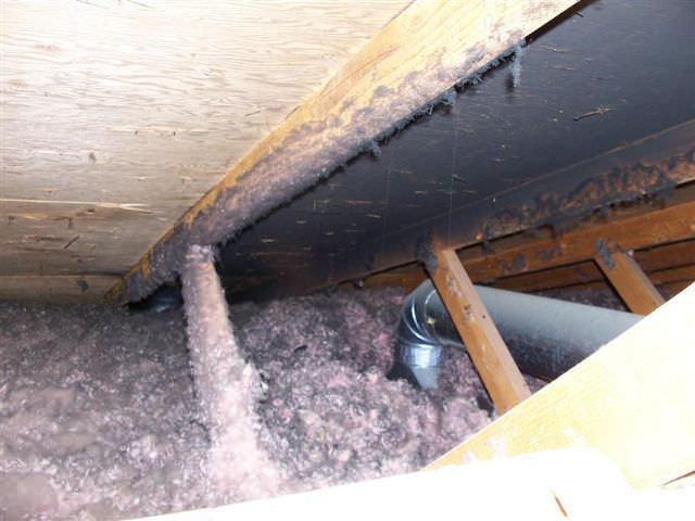

tbird Posted May 11, 2007 Report Share Posted May 11, 2007 Ran into this today. A leaking chimney pipe in the attic. Darkened the underside of the roof sheathing with soot. The homeowners are lucky that the flame has not got this high, or has it? Now this is trouble waiting to happen. This is a double wall metal pipe at the very low point in the attic - can hardly see it. Has any one else seen something like this? Download Attachment: SootAttic.JPG 71.49 KB Have a great one. Carl Johnson http://www.thunderbirdinspection.com Quote Link to comment Share on other sites More sharing options...
jon_ran Posted May 11, 2007 Report Share Posted May 11, 2007 It is odd that the soot is only between those 2 trusses, which is not even directly above the vent while the decking above the vent looks clean. Are you sure that it is soot and not mold? Is there a bath exhaust at the soffit end of that truss section that does not vent outside? If it is soot - Does the home have an oil furnace? If not, I'm sure it did in the past. Does the flue/vent pipe travel up a chase from the level below that terminates at the attic line? My guess is that the pipe had leaked in the past and been replaced. The pipe in place now does not look too old or sooty on the exterior. Looks like dust on top of the pipe may be hiding some soot, but hard to tell. Is there any slope to that pipe? It looks fairly level. Also, looks like the vent pipe is almost touching the truss webbing, there should be at least 1" clearance with type B vents. Did you see an oil tank anywhere? I always warn about potential underground leaks and how I am not performing soil testing, tank integrity testing, etc. when I know that anoil appliance had been in the home. Quote Link to comment Share on other sites More sharing options...
tbird Posted May 11, 2007 Author Report Share Posted May 11, 2007 Thanks for your input Jon. This is Arizona - no oil furnaces in my area. 80% percent of the homes in my area are less than 30 years old. In fact 50% of the homes are less than 15 years old. Don't confuse the pipe to the right as the vent. That is a forced gas heat air duct. The pipe in question is just a small speck where the roof meets the ceiling. It is wood burning 8" inner with a 12" outer pipe. It is possible that it is not connected right at the fireplace and smoke is running up the chase along side of the pipe and when it hits the attic, it cannot continue out of the roof due to clearances. There is soot on most of the insulation in the attic also. What say you? Quote Link to comment Share on other sites More sharing options...
jon_ran Posted May 11, 2007 Report Share Posted May 11, 2007 Without actually being there and seeing it, it is hard to say. Even if I were there, it doesn't sound like I could see much. If you go back, you might take a couple packs of paper matches (or 4th of July smoke bombs), light them all inside of the fireplace then go into the attic and sniff for sulfur. You may not be able to smell anything as there may be enough of a draft to pull it all out of the chimney, but it will be one more step towards making your client happy. If you do smell the sulfur in the attic, then you know that there ids definately a problem. I would not do anything as drastic as light newspaper or such in case the flue is separated or has a hole. You don't want to burn the house down. Were you able to look down the flue from the roof? What did it look like? Quote Link to comment Share on other sites More sharing options...

ozofprev Posted May 11, 2007 Report Share Posted May 11, 2007 Nope, I haven't run into that, but there's no mystery here. Just report it. The caveat I would mention (if you don't see the specific point of discharge) is that the wall may be acting as the chimney while the breach in the vent may be near the fire. That would be bad. Originally posted by tbird Ran into this today. A leaking chimney pipe in the attic. Darkened the underside of the roof sheathing with soot. The homeowners are lucky that the flame has not got this high, or has it? Now this is trouble waiting to happen. This is a double wall metal pipe at the very low point in the attic - can hardly see it. Has any one else seen something like this? Download Attachment: SootAttic.JPG 71.49 KB Have a great one. Carl Johnson http://www.thunderbirdinspection.com Quote Link to comment Share on other sites More sharing options...
Les Posted May 11, 2007 Report Share Posted May 11, 2007 Buy regular smoke candles 10sec - 30 sec or 1 minute. Don't use 4th of July smoke bombs, they are extremely toxic and will render a $500 cleaning bill if they back up into home. Been there - done that - paid price - never do it again! Now we have battery operated smoker and my world famous Fog Machine (cherry flavor) that is non-toxic. Quote Link to comment Share on other sites More sharing options...
hausdok Posted May 11, 2007 Report Share Posted May 11, 2007 I began routinely recommending Level 2 inspections of these, and corrections if necessary, by a CSIA-certified sweep, prior to closing. I seem to recall that years ago the NFPA recommended that homeowners routinely have a Level 2 inspection done on these double-walled vents to ensure that they're still locked together. So, I do it even when the flue looks pretty good because there's no way I can examine 100% of those flues from above or below, and because I remember reading someplace that disconnected flue sections are common. ONE TEAM - ONE FIGHT!!! Mike Quote Link to comment Share on other sites More sharing options...
ozofprev Posted May 11, 2007 Report Share Posted May 11, 2007 Yes, that's an automatic recommendation (in my reporting SW) for any fireplace. Quote Link to comment Share on other sites More sharing options...

tbird Posted May 12, 2007 Author Report Share Posted May 12, 2007 I think just reporting on the sighting of the soot in the attic and recommending further evaluation and repair by a "licensed" fireplace technician is enough. Now trying to find out exactly where the smoke is coming from (using smoke bombs, cherry flavored smoke machines, etc), isn't that above and beyond the standard call of duty for home inspectors? I already do, as standard protocall, recommend level 2 inspections on any type of fire equipment as standard wording in the report. Carl Johnson http://www.thunderbirdinspection.com Quote Link to comment Share on other sites More sharing options...
hausdok Posted May 12, 2007 Report Share Posted May 12, 2007 You're right, there is no need to do more than that. You can't repair it. So, just tell them what the consequences to the structure can/will be, if it isn't corrected, recommend correction and drive on. OT - OF!!! M. Quote Link to comment Share on other sites More sharing options...
