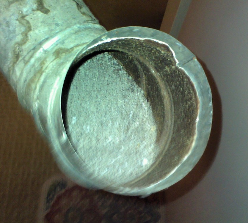

fqp25 Posted July 5, 2008 Report Share Posted July 5, 2008 What is this powdery substance, that is coming out of these elbows of a mid-efficiency furnace? There is none on top of the furnace or water heater (located right by the furnace) . Only on these elbows. Any ideas? Frank Image Insert: 71.28 KB Image Insert: 120.2 KB Quote Link to comment Share on other sites More sharing options...

SonOfSwamp Posted July 5, 2008 Report Share Posted July 5, 2008 That's the white crud that appears at B-vent joints when water condenses in the flue. It's an indication of bad venting. It's a job for an HVAC tech. WJ Quote Link to comment Share on other sites More sharing options...
Bain Posted July 5, 2008 Report Share Posted July 5, 2008 Looks like anhydrous salts left behind by evaporating water. Moisture is likely entering around the storm collar atop the roof. Quote Link to comment Share on other sites More sharing options...
Eric B Posted July 5, 2008 Report Share Posted July 5, 2008 It's from the water vapor in the combustion gas that is condensing inside the vent. Happens in cold weather and indicates improper venting details and/or burner adjustment. It's very common in our area. If you look in the attic you will not see these deposits around the storm collar or flashing. They originate from the vent joints and seams. Spend some time explaining what's going on to the client because chances are high that the HVAC contractor is going to blame the condition on the roof details. Quote Link to comment Share on other sites More sharing options...

hausdok Posted July 6, 2008 Report Share Posted July 6, 2008 Hi, I suppose a chemist might call it some kind of salt but it's what you get when you mix nitric acid with the zink in the galvanizing used to coat the steel. The byproducts of that burning gas are mostly water, nitrogen, sulphur and various other crud - basically nitric acid. Ever see the stuff that builds up on the zinc battery posts of a car? Same stuff. How much you get depends on how well the furnace is venting. If it vents well, you'll get almost none; if it's not venting well, you'll get a lot because there's more condensation occurring inside the vent and you've got more acid there. That looks like a single-walled vent. Is it? If so, is it located in an unheated area or inside. If it's located inside in conditioned airspace and you're getting that much condensate residue you've definitely got some venting issues. ONE TEAM - ONE FIGHT!!! Mike Quote Link to comment Share on other sites More sharing options...
fqp25 Posted July 6, 2008 Author Report Share Posted July 6, 2008 Wow, thanks for the fast responses, especially over a holiday weekend. This is the first time I've seen this residue. This is a "utility room" which is outside of the house and drywalled but most likely uninsulated. Very rare for this area, so maybe cold weather in this room might be attributed to it. It is 4 inch single wall right there, and connected into a 5 inch B-Vent which connects the WH vent. There is some rust on the B-Vent right after the connection of the WH vent. Image Insert: 69.33 KB Quote Link to comment Share on other sites More sharing options...
Darren Posted July 6, 2008 Report Share Posted July 6, 2008 Frank; What youââ¬â¢re seeing is the result of condensation (improper venting). There are many variables to the possible cause, letââ¬â¢s look at one scenario: A newer, fan assisted furnace or boiler has been installed. This vent, along with an existing atmospheric draft water heater, are still connected to a masonry chimney. The location of the chimney is also very important. If itââ¬â¢s an exterior chimney, it absolutely should be re-lined, maybe even abandoned. If itââ¬â¢s an interior chimney, re-lining is probably required. Due to the cooler furnace flue temperatures, itââ¬â¢s not a buoyant as the water heater exhaust, therefore, the water heater exhaust will control. The water heater connector may have to increase in size (it cannot increase more than 2 sizes) to cool down quicker AND the furnace connector may have to be replaced with a B vent. Thereââ¬â¢s just too, too many variables for a home inspector to think he can solve the problem. Here in NJ, almost every house I inspect has a venting issue. I did one last week where the furnace and WH connected to an 8â⬠Quote Link to comment Share on other sites More sharing options...

Brad Burke Posted March 24, 2020 Report Share Posted March 24, 2020 (edited) I have often thought part of the cause is where the galvanized steel single wall pipe is connected to the aluminum inner pipe of the B-vent. A chemical reaction if you will. I have had this problem on water heaters and changed the single wall pipe to aluminum and the problem went away. I haven't been brave enough to try the thin aluminum pipe on a furnace yet so I still fight the "salt" on those and it does, eventually rot through the pipe. Before that happens, I usually have to take the vent apart and dump all of that stuff out of the horizontal pipe and vacuum it out of the draft inducer part of the furnace. I've had it almost completely block the opening in the furnace. This usually manifests itself with a code about the draft inducer or inadequate vent flow Edited March 26, 2020 by Brad Burke Quote Link to comment Share on other sites More sharing options...
hausdok Posted March 24, 2020 Report Share Posted March 24, 2020 Hi, The white powdery substance you are seeing is mineral salts caused by a chemical reaction between the acids in the exhaust gases and the zinc contained in the galvanized pipe used for the single-walled vent connector. To make that relatable, think battery post corrosion in your engine compartment. That length of single-walled pipe from the collar allows those exhaust gases to cool, get heavier and slow down way too early. When that happens, the gas cools to dewpoint and condenses on the inner walls of the vent somewhere above the connection between the single-walled connector and double-walled vent pipes. Wherever the acids in that condensation comes into contact with galvanized pipe, that reaction occurs. Then, when all of that excess condensation drains back to the joint between the vent and connector and leaks out of the joint, the water evaporates and leaves the salts behind. That's why gas exhaust vents and connectors should be double-walled all the way from the collar of the appliance to terminus. The fuel-gas code used to require only B vents to the collar in attics and concealed spaces and anywhere considered to be cold, but it seemed like the majority of HVAC installers ignored that rule anyway if the furnace or water heater was installed where it's readily viewable in unheated areas like garages. Somewhere back around the 2003 - 2005 timeframe that requirement disappeared from the code and they allowed installation of single-walled connectors in areas other than the attic or concealed spaces as long as the area wasn't any colder than 5-deg. F. in winter. This despite the fact that a lot of condensation can occur even in vents that are luke-warm to the touch in such areas like garages. I'll bet you a box of donuts that most HVAC installers still couldn't care less and are still using as much single-walled material as they can, in order to squeeze as much profit as possible out of every job. Too much salt indicates an issue with the exhaust vent system. A little bit of salts isn't really too much of a concern at a single-walled to double-walled connection, if there isn't any issue at the vent terminus (Excessive rusting, cracks, holes due to condensation and acidic vapor lingering around the vent once it leaves the pipe), but a lot of salt is telling you there's an issue with exhaust gases cooling too rapidly - especially if there is a lot of salt sifting back down from the vent connector at the collar and ending up in/on the furnace. Cause could be the single-walled connector from the collar, if it's too long and it's in an unheated (cold) area. The fix could be to replace the single-walled section with a double-walled section, but a lot of the time that doesn't necessarily stop it if the installer didn't properly calculate the vent size requirements using the vent sizing tables in the code or if he/she didn't pay attention to the rule about limits on number and degree of bends in the vent between collar and terminus - bends that violate the 'no bends greater than 45-deg but one bend of no more than 60-deg. rule, slow those gases. The more bends, the slower the gas moves - even if the furnace has an exhaust gas inducer. Around here those numbskulls will use two to four 90-deg. bends to detour around furnace filter access doors instead of using 45-deg. vents to go around. Another thing to look at is whether or not the appliance has enough makeup air. If they've installed it in confined space with insufficient makeup air, or in a laundry room where there's a clothes dryer and no makeup air openings to the outside, those gases will stall - even with an inducer integral to the appliance. There have been thousands of times I've stepped out of my vehicle, glanced up at a rooftop, saw a heavily-rusted vent terminus and knew right away that as soon as I checked out the furnace I was going to find issues with stalling exhaust gases. Sometimes, the issue was so bad that condensation would literally leak out of the vent connector connection at the collar and drip onto components in the controller bay - eating holes through the floor of the bay and sometimes causing electrical connections to severely corrode. So, when someone tells you, like the gent above, that the salts mean nothing, take it with a grain of salt and thoroughly inspect that vent installation anyway. It's good that you're asking questions about this. I've always said that inspectors need, more than anything else, to understand basic building sciences, and need to look at the whole picture, not just the tick marks their report format asks them to check, that are taught by a lot of so-called inspection schools, in order to really do this job well and be able to make the client fully comprehend the implications of issues found. ONE TEAM - ONE FIGHT!!! Mike 1 Quote Link to comment Share on other sites More sharing options...

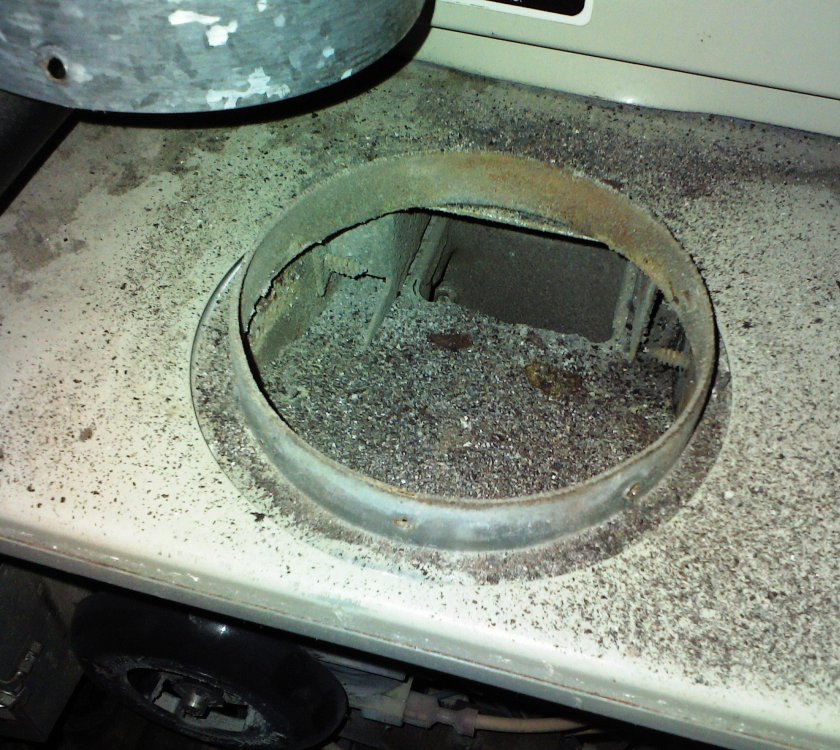

Brad Burke Posted March 26, 2020 Report Share Posted March 26, 2020 On 3/24/2020 at 3:58 PM, Brad Burke said: I have often thought part of the cause is where the galvanized steel single wall pipe is connected to the aluminum inner pipe of the B-vent. A chemical reaction if you will. I have had this problem on water heaters and changed the single wall pipe to aluminum and the problem went away. I haven't been brave enough to try the thin aluminum pipe on a furnace yet so I still fight the "salt" on those and it does, eventually rot through the pipe. Before that happens, I usually have to take the vent apart and dump all of that stuff out of the horizontal pipe and vacuum it out of the draft inducer part of the furnace. I've had it almost completely block the opening in the furnace. This usually manifests itself with a code about the draft inducer or inadequate vent flow Quote Link to comment Share on other sites More sharing options...
Homeowner in Ohio Posted May 29, 2020 Report Share Posted May 29, 2020 I have white gritty sand-like debri on top of my gas hot water tank and on the floor near it. I'm guessing it's falling from the vent which goes directly to my roof. This is not a powder like the earlier posts. What is this, and what should I do? Quote Link to comment Share on other sites More sharing options...
