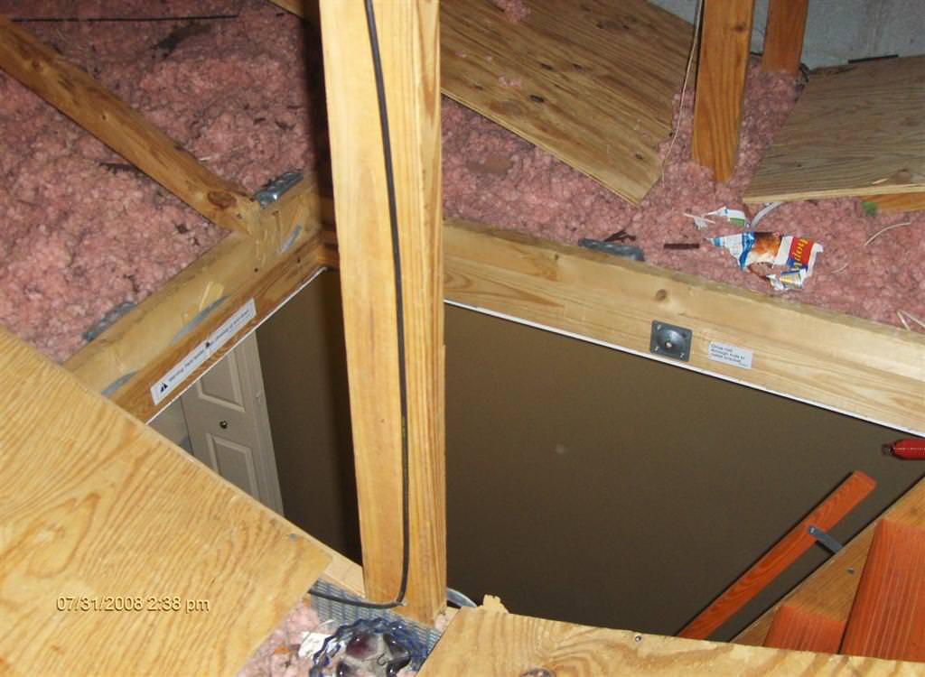

John Dirks Jr Posted August 1, 2008 Report Share Posted August 1, 2008 This truss was cut to make a hole for the pull down stairs. how often do you all find this? Image Insert: 125.42 KB Image Insert: 116.44 KB Quote Link to comment Share on other sites More sharing options...
AHI in AR Posted August 1, 2008 Report Share Posted August 1, 2008 Hi John-- How often it's found isn't the issue. Improper truss mods aren't uncommon. In fact, dumb things are done every day somewhere in the country. As you know, what you have pictured is wrong. Every member of an engineered truss is designed to function under either tension or compression. They have a job to do and they can't do that job if they aren't there. You've got at least 3 web sections that have been altered, if not completely removed. NO modifications should be made in the field. There are stairs designed to fit between the trusses; there is no reason to cut trusses to install a stair designed for a stick-framed home. Even if no horrible effects have resulted yet, you should call for an engineer's review. Go by his recommendations. My experience says that he'll say (effectively) to rebuild the truss exactly as originally designed and replace the stair with a narrower one designed to fit between the trusses. Quote Link to comment Share on other sites More sharing options...
Bain Posted August 1, 2008 Report Share Posted August 1, 2008 All the time. You need to tell your client to have it reinforced, but in real time, it probably won't cause any problems. Unless, of course, the lower chord was damaged along with the web member. I can't be sure from the photo. Quote Link to comment Share on other sites More sharing options...
John Dirks Jr Posted August 1, 2008 Author Report Share Posted August 1, 2008 Originally posted by Bain All the time. You need to tell your client to have it reinforced, but in real time, it probably won't cause any problems. Unless, of course, the lower chord was damaged along with the web member. I can't be sure from the photo. The lower chord for the cut truss would have run right through the hole there. I would say it is compromised. I wrote it up. I was just wondering how often it happens. Quote Link to comment Share on other sites More sharing options...
Bain Posted August 1, 2008 Report Share Posted August 1, 2008 I was typing the same time Kevin was. Did they slice the lower chord, too, John? If so, ditto to what Kevin said. Quote Link to comment Share on other sites More sharing options...
John Dirks Jr Posted August 1, 2008 Author Report Share Posted August 1, 2008 Also, do you see the broken spring on the pull down stair? That sucker snapped apart as I pulld the stair down. Quote Link to comment Share on other sites More sharing options...
msteger Posted August 1, 2008 Report Share Posted August 1, 2008 Ditto to what you guys said. Any mods to trusses should be approved by the manufacturer or structural engineer. Was that pulldown ladder in a garage or somewhere else in the home? Pulldown ladders with wooden covers don't belong in garages (attached) due to fire wall reasons. Quote Link to comment Share on other sites More sharing options...
