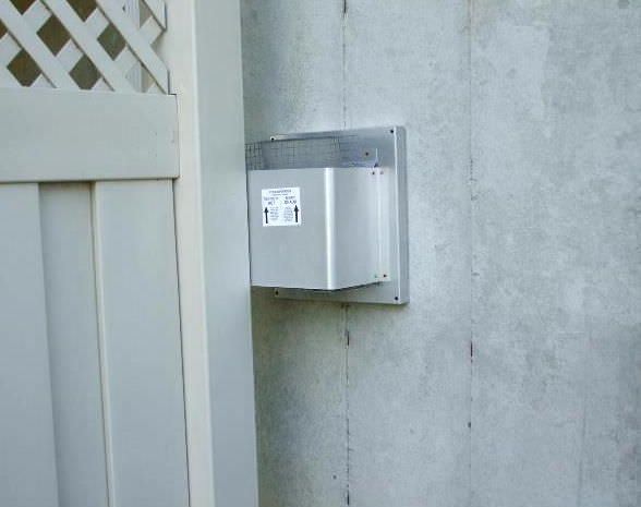

msteger Posted September 15, 2008 Report Share Posted September 15, 2008 What is the minimum required clearance for metal vents for gas log fireplaces? One I ran into this morning was just about touching a vinyl fence. I seem to recall 12" minimum, but is that right? See photo below. Thanks. Image Insert: 26.82 KB Quote Link to comment Share on other sites More sharing options...
Brandon Whitmore Posted September 15, 2008 Report Share Posted September 15, 2008 I think that the fence is too close (pure speculation), but you need to rely on the manfacturer's installation instructions. Quote Link to comment Share on other sites More sharing options...
msteger Posted September 15, 2008 Author Report Share Posted September 15, 2008 Good point, Brandon. I also mentioned that to my client since it was evident that the basement was finished by the home owner, and I had no idea if the gas fireplace was installed by the home owner or a qualified professional. From other things I found in the basement, I suspected the home owner is probably a DYI or HGTV watching person who doesn't know how to properly do things. hi. For CYA reasons, I recommended having the unit thoroughly inspected by a qualified fireplace professional for proper operation and installation. The pilot was not lit, so I couldn't even turn the fireplace on. No idea if the vinyl fence was installed before or after the fireplace install. Either way, common sense didn't win in this one. Quote Link to comment Share on other sites More sharing options...
Brandon Whitmore Posted September 15, 2008 Report Share Posted September 15, 2008 Matt, Whenever I see something strange like that, I will write down the model #, etc. for the unit and look up the installation instructions at home. That is, unless the instructions happen to be tucked in beneath the unit. Question for all....... How many of you will/ will not light a pilot on a gas lot unit? Quote Link to comment Share on other sites More sharing options...
Bain Posted September 15, 2008 Report Share Posted September 15, 2008 Most manufacturers require an 8" horizontal clearance. The link below is for a Heat 'n' Glow fireplace. http://content.hearthnhome.com/download ... 02_900.pdf Quote Link to comment Share on other sites More sharing options...

SonOfSwamp Posted September 15, 2008 Report Share Posted September 15, 2008 Originally posted by msteger For CYA reasons, I recommended having the unit thoroughly inspected by a qualified fireplace professional for proper operation and installation. The pilot was not lit, so I couldn't even turn the fireplace on. Pardon my jumping in, but why not get the data (mfr., SN, etc.) off the vent and/or FP and call the manufacturer? Or maybe Google the data? That would get your customer first-hand info from the manufacturer, and it would save him from the "qualified fireplace professional," who may charge a couple hundred bucks, and not know more about that FP than the family cat. Worse, the qualified pro might be the seller or RE agent's lackey. Best I recall, there's a data plate on those vents. BTW, best I know, passing the buck doesn't really C your A. In a worst-case scenario, it gets an HI sitting in the witness chair, waiting for the plaintiff's expert to explain that the best course of action would have to been to get info from the mfr. WJid="blue"> Quote Link to comment Share on other sites More sharing options...
Bain Posted September 16, 2008 Report Share Posted September 16, 2008 Yep to Walter. Around here, the folks who install and service pre-fab fireplaces work for the companies that sell the things. Their expertise is typically derived from three-day certification courses. I have a Verizon Wireless card built into my Dell computer, and Google information on the job all the time. I also have a large file of .pdfs--many of which I cribbed from TIJ--on my computer that I can access if I'm uncertain about a particular detail. I haven't had tons of luck phoning manufacturers. The person who answers the phone is normally clueless, and getting someone in-the-know on the line can take forever. Quote Link to comment Share on other sites More sharing options...
Tom Raymond Posted September 16, 2008 Report Share Posted September 16, 2008 I haven't had tons of luck phoning manufacturers. The person who answers the phone is normally clueless, and getting someone in-the-know on the line can take forever. I feel your pain. I call on several manufactureres regularly for my day job, and my go to Gal at one of them just retired. She knew more than the rest of the customer service department combined. The fact that everything looks DIY'ed is probably a good thing, it will be a lot easier to move the fence post if the homeowner failed to fill it with the requesite concrete and rebar. http://www.certainteed.com/NR/rdonlyres ... /0/201.pdf Quote Link to comment Share on other sites More sharing options...

msteger Posted September 21, 2008 Author Report Share Posted September 21, 2008 I've called the local code guy 3 times in charge of that township regarding another issue found during the home inspection and he's never called me back. Makes it a little tough when trying to verify what the AHJ allows. Quote Link to comment Share on other sites More sharing options...
SonOfSwamp Posted September 21, 2008 Report Share Posted September 21, 2008 Originally posted by msteger I've called the local code guy 3 times in charge of that township regarding another issue found during the home inspection and he's never called me back. Makes it a little tough when trying to verify what the AHJ allows. Forget the local muni. Go straight to the horse's mouth, and cite the code yourself. It's public domain. IMHO, the HI has to be smarter than the AHJ. That's easy to do. WJid="blue"> Quote Link to comment Share on other sites More sharing options...
msteger Posted September 22, 2008 Author Report Share Posted September 22, 2008 The issue is that I haven't determined what IRC requires for this type of fireplace. Quote Link to comment Share on other sites More sharing options...
