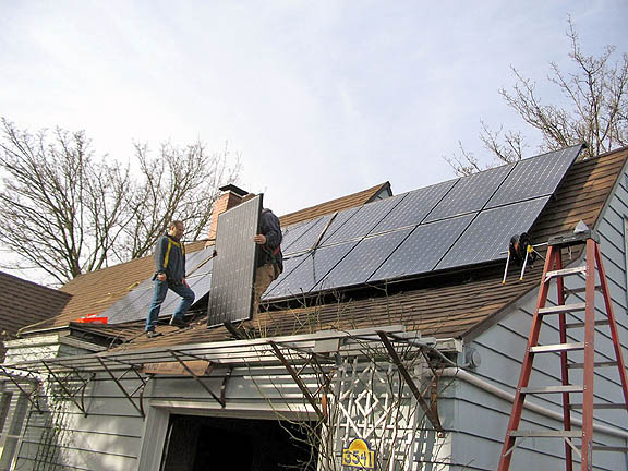

Ken Meyer Posted September 20, 2008 Report Share Posted September 20, 2008 We have a Decra roof on our house, installed in 2002. In early 2007 we had a solar array installed, and the installers had no problems other than wearing out a lot of drill bits going through the roof to install the rack, and wearing out their shoes from the granules. The roof covering did not distort from all their walking on it, and I've been up on parts of it as well, you can feel a little flex, but it does not distort from walking on it. I clean the gutters regularly and have never seen any granules. It is made to last. Image Insert: 102.15 KB Quote Link to comment Share on other sites More sharing options...
Brian G Posted September 21, 2008 Report Share Posted September 21, 2008 I'm sure the shingles are nice, but I'm lusting after your solar array. I have a big, steep roof with both southern and western exposures. [] Supposedly solar panels will be dropping by as much as 45% in the next few years. I hope so. [:-thumbu] Brian G. Slow Down the Damned Meter [:-crazy] Quote Link to comment Share on other sites More sharing options...

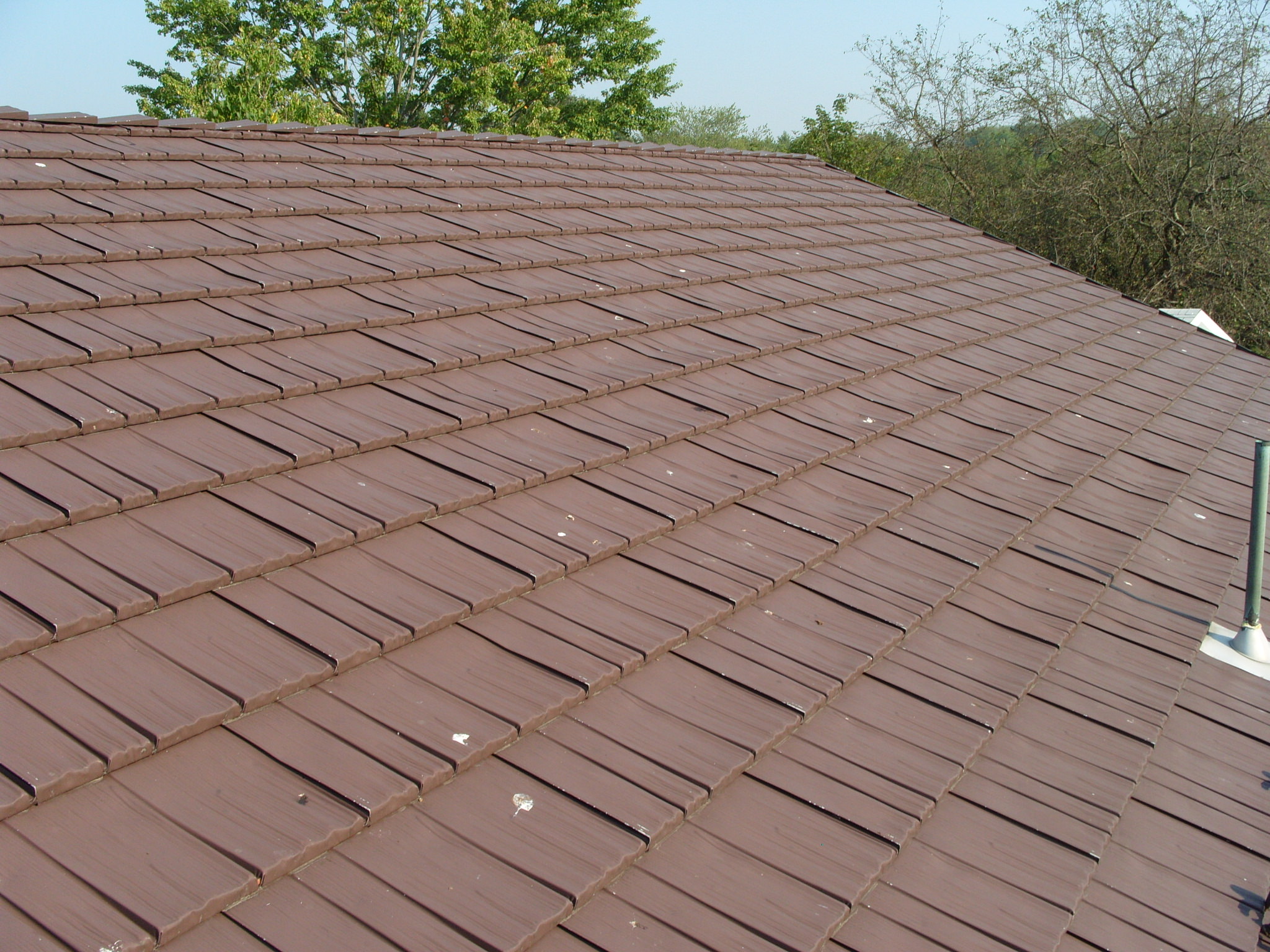

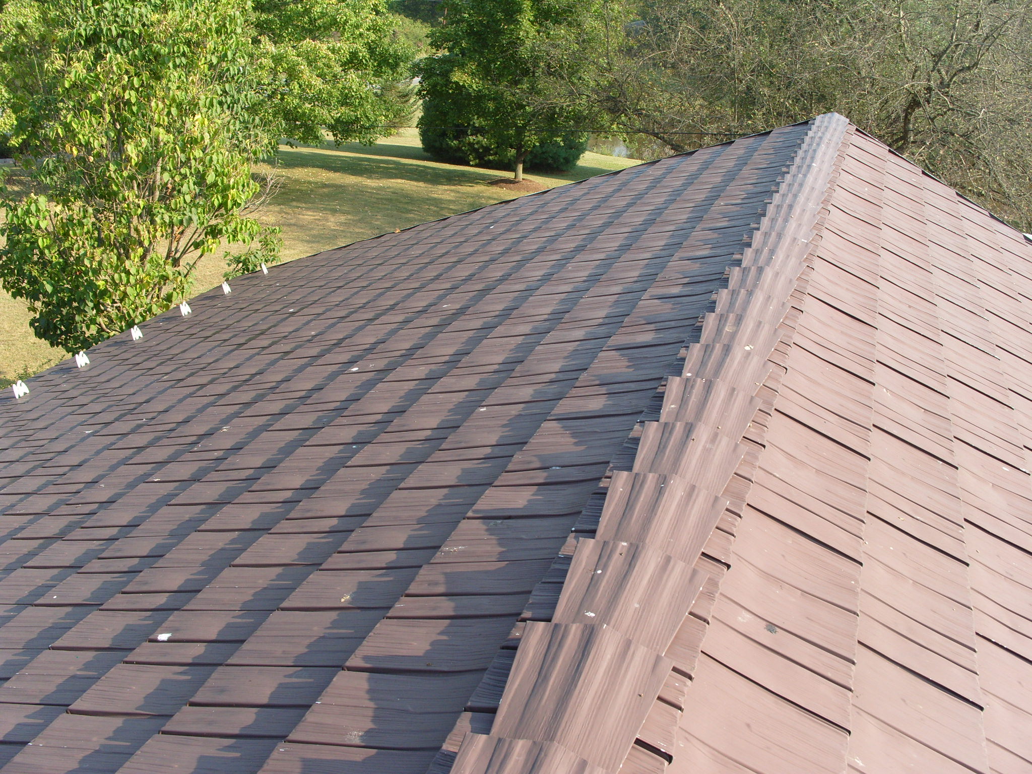

elgato Posted November 19, 2008 Report Share Posted November 19, 2008 Did your roofing look like this? I found only gable vents, and called out "poor and inadequate" ventilation. Download Attachment: Robbins 036.jpg 1701.58 KB Download Attachment: Robbins 033.jpg 1729.93 KB Quote Link to comment Share on other sites More sharing options...
hausdok Posted November 19, 2008 Report Share Posted November 19, 2008 Hi, I hope that you called it out based on an attic issue 'cuz that type of metal roof cover is installed over battens and has lots of airspace beneath the surface for ventilation. Go here, ask an expert, check out the guide and get yourself a free subscription to Metal Roofing Mag. ONE TEAM - ONE FIGHT!!! Mike Quote Link to comment Share on other sites More sharing options...
