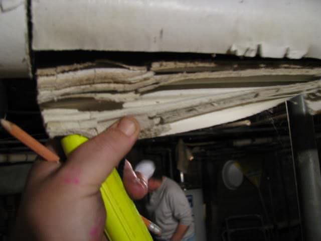

travismoshier Posted October 15, 2008 Report Share Posted October 15, 2008 I know to find out if something is asbestos it should be tested, but can anyone identify this material? It was on the distribution pipes from the boiler. Sorry the pictures are not as clear as I like. Image Insert: 39.89 KB Image Insert: 33.23 KB Quote Link to comment Share on other sites More sharing options...
hausdok Posted October 15, 2008 Report Share Posted October 15, 2008 Probably ACM OT - OF!!! M. Quote Link to comment Share on other sites More sharing options...
SonOfSwamp Posted October 15, 2008 Report Share Posted October 15, 2008 Eyeballs say asbestos. Microscope probably says the same. Due diligence would require testing, or at least a stern warning. WJ Quote Link to comment Share on other sites More sharing options...
Jim Katen Posted October 15, 2008 Report Share Posted October 15, 2008 Originally posted by travismoshier I know to find out if something is asbestos it should be tested, but can anyone identify this material? It was on the distribution pipes from the boiler. Sorry the pictures are not as clear as I like. I don't know what that can be other than asbestos aircell insulation. - Jim Katen, Oregon Quote Link to comment Share on other sites More sharing options...

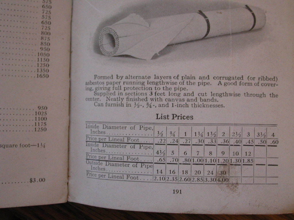

Kyle Kubs Posted October 15, 2008 Report Share Posted October 15, 2008 Originally posted by travismoshier I know to find out if something is asbestos it should be tested, but can anyone identify this material? It was on the distribution pipes from the boiler. Sorry the pictures are not as clear as I like. Image Insert: 39.89 KB Image Insert: 33.23 KB From a Cir. 1920's American Radiator Co. catalog I have... Image Insert: 187.53 KB Image Insert: 186.75 KB What the pictures show is what I grew (sp?) up with and am used to seeing around here, a canvas wrap. Yours I'm sure is just a local incarnation, different manufacturer. If this doesn't help, take a pinch between your cheek and gum and see if it tastes like Asbestos[^] For Liability reasons. I am kidding... No, really, I am. Quote Link to comment Share on other sites More sharing options...
Les Posted October 15, 2008 Report Share Posted October 15, 2008 Likely asbestos containing. We have had materials like that tested many times and usually it does contain asbestos. We have had several samples not contain asbestos. Our experience leads us to recommend testing, if they want. There is a common protocol for testing that some labs don't seem to follow. Some visual clues are the method of fastening, brittleness of wrap, gauze vs open weave cloth, paper wrap, color, configuration of substrate, labels, rust on fasteners, configuration of transition and connection fittings, etc. These clues only give you a basis for an opinion. If you want to really know, have it tested by a lab. I had my ego shattered in late 1980's when I insisted a similiar material was asbestos containing. There are always exceptions to any "rule". I have learned that there are thousands of regional differences in this business. Follow Bill K's lead and read old books. Of course you could Google it and think you know. Quote Link to comment Share on other sites More sharing options...
travismoshier Posted October 15, 2008 Author Report Share Posted October 15, 2008 Image Insert: 186.75 KB What the pictures show is what I grew (sp?) up with and am used to seeing around here, a canvas wrap. Yours I'm sure is just a local incarnation, different manufacturer. If this doesn't help, take a pinch between your cheek and gum and see if it tastes like Asbestos[^] For Liability reasons. I am kidding... No, really, I am. I did taste it. It does taste like asbestos, with a hint of oaky flavor.[:-bigeyes That catalog picture is great. It looks exactly like it! Thanksid="blue"> Quote Link to comment Share on other sites More sharing options...
Kyle Kubs Posted October 15, 2008 Report Share Posted October 15, 2008 Originally posted by Les Likely asbestos containing. We have had materials like that tested many times and usually it does contain asbestos. We have had several samples not contain asbestos. Our experience leads us to recommend testing, if they want. There is a common protocol for testing that some labs don't seem to follow. Some visual clues are the method of fastening, brittleness of wrap, gauze vs open weave cloth, paper wrap, color, configuration of substrate, labels, rust on fasteners, configuration of transition and connection fittings, etc. These clues only give you a basis for an opinion. If you want to really know, have it tested by a lab. I had my ego shattered in late 1980's when I insisted a similiar material was asbestos containing. There are always exceptions to any "rule". I have learned that there are thousands of regional differences in this business. Follow Bill K's lead and read old books. Of course you could Google it and think you know. Les, In instances where the material tested as non Asbestos, what material/materials was it? Quote Link to comment Share on other sites More sharing options...

Les Posted October 17, 2008 Report Share Posted October 17, 2008 Lab(s) reported it as a Plaster of Paris type product; limestone base. Seems there were several regional gypsum mines that sold a byproduct to paper companies who in turn used it with their scrap to produce "plaster" impregnated material. Think Henry Ford and his shipping crates used for floor boards in the Model T. I recall US Gypsum marketing an asbestos free product circa 1940's. I will peruse my old publications for an example of an ad. Most of the old fart inspectors, myself included, would bet on ACM but would not report it as such. It is kinda like the lead base paint issue. Too many experts. Thread drift! This reminds me of the crack house in Lansing that a couple of kids explored during their lunch break and ripped the Honeywell T-stat off the wall. The local police, fire department, health department, school board, reporters and parents closed off the entire block and entire school (including kids and teachers) because of the mercury contamination potential. They never did recover all that mercury. But a bunch of kids did get a free shower and new clothes. Do you KNOW how much mercury was in that vial? Quote Link to comment Share on other sites More sharing options...

msteger Posted October 19, 2008 Report Share Posted October 19, 2008 ..and I probably wouldn't be playing with that wrapping (like the hand in that top picture onto the little guy's head). I would also report that material in the photo as "suspected of containing asbestos". The only real way to know is have it tested. Quote Link to comment Share on other sites More sharing options...
