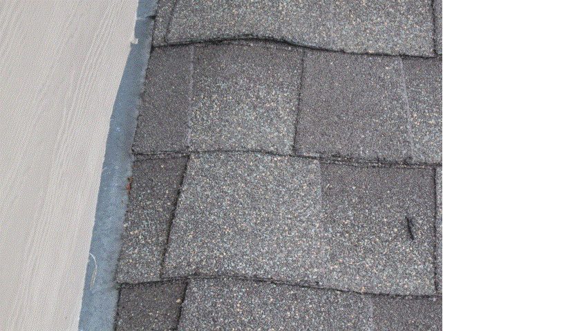

buster_houston Posted November 14, 2012 Report Share Posted November 14, 2012 Will try to post some pictures from the inspection report tonight provided that this site will easily let me do it and the inspector is ok with it.. Quote Link to comment Share on other sites More sharing options...
buster_houston Posted November 15, 2012 Report Share Posted November 15, 2012 Will try to post some pictures from the inspection report tonight provided that this site will easily let me do it and the inspector is ok with it.. Here are some pictures (hopefully) Click to Enlarge 122.59 KB Click to Enlarge 99.77 KB Click to Enlarge 133.73 KB Quote Link to comment Share on other sites More sharing options...
buster_houston Posted November 15, 2012 Report Share Posted November 15, 2012 And here's one more pic: Click to Enlarge 139.96 KB Quote Link to comment Share on other sites More sharing options...
Tom Raymond Posted November 15, 2012 Report Share Posted November 15, 2012 Click to Enlarge 133.73?KB This is exactly why this is a bad idea. Proper detailing is what makes these junctions work. Throw that out and everything else gets improvised. They even botched the lazy valley detail. FTR, I don't dislike that valley method, but for crying out loud how hard is it to cut the angle correctly? If this level of finish is acceptable, what on earth are they allowed to cover up? Quote Link to comment Share on other sites More sharing options...
Marc Posted November 15, 2012 Report Share Posted November 15, 2012 Yeah, that's a crappy install, shingles and flashing both. You say this builder has a good reputation? Not in my book. Again, I doubt it'll leak though hurricane winds will rip those shingles beginning with the ones over the j-flashing at the eaves. Marc Quote Link to comment Share on other sites More sharing options...

Jim Katen Posted November 16, 2012 Report Share Posted November 16, 2012 Well the realtor says the builder says that the builder will fix the flashing presumably before close. So all of this is helping me decide what to do. Thanks! Despite the highly amusing photos that you posted, I still say that it's not worth repairing until it's time to replace the shingles. In fact, I'll bet six Heath Bars that, if the builder does try to fix it, he'll screw it up worse than it is now and make it more likely to leak. Quote Link to comment Share on other sites More sharing options...
AHI in AR Posted November 16, 2012 Report Share Posted November 16, 2012 Honestly, what concerns me most about those photos from Buster is the condition you can easily see in the second photo where the flashing stops well short of the fascia and the drip cap. There will be way too much water draining where it shouldn't at that joint. Quote Link to comment Share on other sites More sharing options...

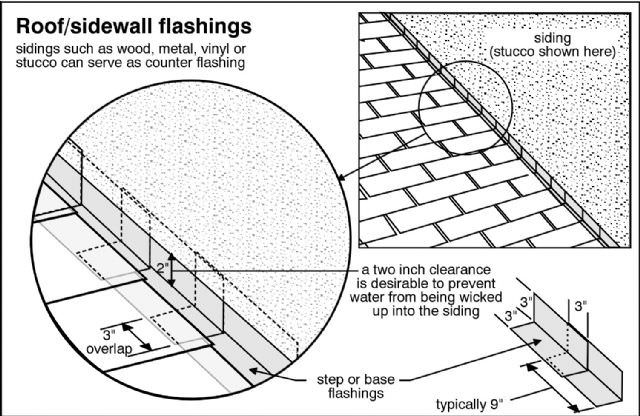

Phillip Posted November 17, 2012 Report Share Posted November 17, 2012 The reason rake flashing is is because the siding will have to be removed to take the step flashing out when the roof is replaced. With rake flashing you do not have to take the flashing off when the shingles are replaced. If you are going to have the flashing changed to step flashing, installed a counter flashing that goes under the siding so the step flashing can be removed with have to remove the siding. Quote Link to comment Share on other sites More sharing options...
buster_houston Posted November 17, 2012 Report Share Posted November 17, 2012 Thanks Philip! I'll see if the contractor will be willing to do that. I will talk to him on Monday morning to see if we can come to an agreement... I wonder why J flashing has become so prevalent... Is it because the majority of roofers nowadays only know and employ J flashing? It sounds like step flashing installation is more involved and complex, requiring interleaving layers of flashing with shingles.. Has step flashing become a dying art? Quote Link to comment Share on other sites More sharing options...
Marc Posted November 17, 2012 Report Share Posted November 17, 2012 What if you just use the vapor barrier/siding for counter-flashing, leave the lower part of the step flashing exposed for two inches and avoid putting siding nails through it? Click to Enlarge 76.18?KB You'll need some angled blocking between the studs to provide a nail base for the tapered sections of siding. Jeff, step flashing is a lot more trouble than J flashing. Unless the buyer is diligent, lots of corners are cut on a house to save the builder money. Marc Quote Link to comment Share on other sites More sharing options...

buster_houston Posted November 20, 2012 Report Share Posted November 20, 2012 Well, the builder won't replace the J channel with step flashing, he will only perform minor repairs to the roof flashing - such as repairing the flashing in the picture with the valley. One concern that came up with the shingles directly over the lip of the J channel flashing is the possibility of the shingles breaking in the Houston heat as they expand and contract. Are there any minor changes that can be made to keep this from happening? Thanks! Jeff Quote Link to comment Share on other sites More sharing options...
