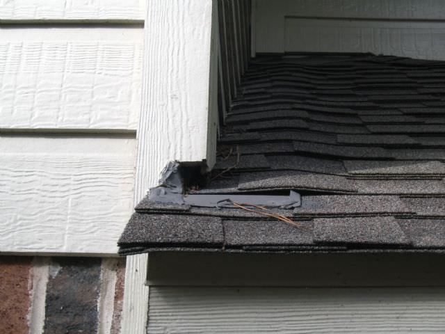

old Marine Posted November 30, 2008 Report Share Posted November 30, 2008 This is a common problem faced by inspectors in the Houston TX area. I have been calling improperly installed flashing along side walls and chimney's etc for longer than I want to remember. The IRC as well as shingle manufactures, siding manufactures as well as national trade origanizations all require step flashing along side walls with composite type shingles. In the Houston TX area the Houston Builders asso as well as city inspection departments allow the use of J type flashing. The worst of the problem is that many inspectors in this area also either do not know it is wrong or just look the other way. I am posting this with the hopes that more inspectors will become aware of this incorrect method of installing flashing and start calling it that way. Quote Link to comment Share on other sites More sharing options...

old Marine Posted November 30, 2008 Author Report Share Posted November 30, 2008 Originally posted by caryseidner Do you have a pic of the "J type" flashing? Download Attachment: IMG_4494.JPG 896.22 KB Quote Link to comment Share on other sites More sharing options...
old Marine Posted November 30, 2008 Author Report Share Posted November 30, 2008 Attached is a photo taken and kept in my flashing hall of shame! This home is less then 2 years old approximately $800,000.00 this was the side wall flashing Download Attachment: IMG_1747.JPG 1555.64 KB Quote Link to comment Share on other sites More sharing options...

qhinspect Posted November 30, 2008 Report Share Posted November 30, 2008 I'm not sure if anyone has written this already but the roof shingles have to lay flat. This so called J type flashing does not accomplish that. So I would write it up as wrong and that correction is needed to ensure proper performance. I would always call this out and if anyone question it, I would tell them my professional opinion and move on. Glad they don't do that around here. Quote Link to comment Share on other sites More sharing options...

buster_houston Posted November 11, 2012 Report Share Posted November 11, 2012 I have a contract on a builder inventory house in the Houston area with a builder with a good reputation. The H.I. came out yesterday and flagged the J-flashing. I was lucky that the H.I. did this. I turned the inspection report over to the builder and realtor. After reading this, I think I'm inclined to insist that the builder replace the J flashing with step flashing on the junction between the side wall of the upstairs room (1.5) and the roof. Don't know what the builder's going to do. If they refuse, maybe I should walk away from the house. I'm wondering what steps they would need to take to fix it and how much it would cost to get an independent contractor to fix it if the builder refuses to fix it. Also, builders have warranties, and I'm wondering whether the warranty would take care of this. Many thanks!! Quote Link to comment Share on other sites More sharing options...
Marc Posted November 11, 2012 Report Share Posted November 11, 2012 The most difficult part of the repair is removing the siding, then re-installing it after the step flashing is in place. That's a lot of trouble. Next to you in south Louisiana, I see step flashing on no more than one newly constructed home out of twenty. Don't recall ever seeing issues with it unless the roofer nailed his shingles through it. If new-construction in your area is anything like here, there's likely to be other issues far more significant than just this 'J flashing'. If there's a host of other significant or perhaps major issues along with the J flashing, walk away if you can. If not, you might find after walking that the best house is behind you, especially if you hire a crack inspector. Marc Quote Link to comment Share on other sites More sharing options...
Jim Katen Posted November 11, 2012 Report Share Posted November 11, 2012 I have a contract on a builder inventory house in the Houston area with a builder with a good reputation. The H.I. came out yesterday and flagged the J-flashing. I was lucky that the H.I. did this. I turned the inspection report over to the builder and realtor. After reading this, I think I'm inclined to insist that the builder replace the J flashing with step flashing on the junction between the side wall of the upstairs room (1.5) and the roof. Don't know what the builder's going to do. If they refuse, maybe I should walk away from the house. I'm wondering what steps they would need to take to fix it and how much it would cost to get an independent contractor to fix it if the builder refuses to fix it. Also, builders have warranties, and I'm wondering whether the warranty would take care of this. I think you'd be a dope to walk away from a house because of this single issue. If it were me, I'd wait for it to leak before I'd invest a dime in repairing it. The J-flashing technique isn't ideal, but it's not terrible either. Thank your home inspector, buy the house, and enjoy your life. Quote Link to comment Share on other sites More sharing options...

David Meiland Posted November 12, 2012 Report Share Posted November 12, 2012 Seems like the correct repair is going to involve removing and replacing the siding, lapping the WRB over the flashing, etc. If the roofer gets sent out the to do the whole thing... look out. I have seen roofers try to loosen siding, jam the flashing up under it, then pound the siding back down. What are the chances of that working right? Quote Link to comment Share on other sites More sharing options...

Jim Katen Posted November 14, 2012 Report Share Posted November 14, 2012 One other related question.. I believe the siding the J flashing is under is Hardy plank. Is it possible to remove the Hardy plank to install the new step flashing, and then re-attach the same Hardy plank? A guy at work indicated that you cannot re-attach Hardy plank. Is this true? If so, it maybe seems like too much trouble to replace the J-flashing. It's possible to remove and reattach hardiplank, but it's a pain in the butt and probably cheaper and easier to just toss the old stuff and replace it with new. This is one of those times when trying to fix something that isn't broken will yield a mess. If it's not leaking, just let it run its course. You can install proper flashing when the roof needs to be replaced down the road. Quote Link to comment Share on other sites More sharing options...
Mike Lamb Posted November 14, 2012 Report Share Posted November 14, 2012 The caulking alone cries, "I am an idiot!" That said, if there is no step flashing (you are so sure?), this J flashing will surely leak in severe wind driven rains. You may never notice. Quote Link to comment Share on other sites More sharing options...
Jim Katen Posted November 14, 2012 Report Share Posted November 14, 2012 The caulking alone cries, "I am an idiot!" That said, if there is no step flashing (you are so sure?), this J flashing will surely leak in severe wind driven rains. You may never notice. Mike, are you looking at Old Marine's first picture or his second one. The second picture is not J-flashing, it's just stupid flashing. The J-flashing in the first picture isn't ideal, but it works ok and isn't particularly susceptible to wind-driven rain. Quote Link to comment Share on other sites More sharing options...
Marc Posted November 14, 2012 Report Share Posted November 14, 2012 That said, if there is no step flashing (you are so sure?), this J flashing will surely leak in severe wind driven rains. You may never notice. I haven't known it to...and I live in a 110 mph hurricane wind zone. Marc Quote Link to comment Share on other sites More sharing options...
