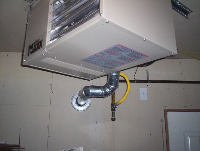

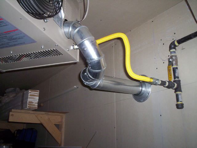

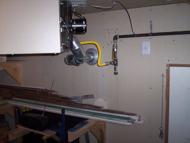

tcfinishing Posted January 26, 2009 Report Share Posted January 26, 2009 I have a Mr. Heater MHU45 unit heater for my garage. Ceiling hieght is 8'-7". The heater is mounted 2" from ceiling. The sofit on the exterior drops 10" below ceilng hieght. I installed the venting with 3- 3" 26GSG 90's, 1- 3"x12" GSG single wall, 3" wall thimble and 1- 3' B1 vent with a vent termination cap. The venting drops at the 90's 6" to get it below the exterior sofit with requiered clearence. I"m told because of the drop 90's this won't pass code. Do you have any solutions to this problem? Note: If I lower the furnace to allow for direct venting the unit will be below the garage door header opening. Click to View 47.51 KB Link to comment Share on other sites More sharing options...
Les Posted January 26, 2009 Report Share Posted January 26, 2009 Craig, That is one silly looking flue configuration. No, I can't think of any quick fix, given your specs. I have always had a bit of a problem with garage heaters, as they generally are installed by skilled homeowners. I would be sure what ever you come up with is safe and I'd be sure the gypsum board is sealed (taped). Link to comment Share on other sites More sharing options...

energy star Posted January 26, 2009 Report Share Posted January 26, 2009 Don't run that heater. You must go up through the roof in that application. Link to comment Share on other sites More sharing options...

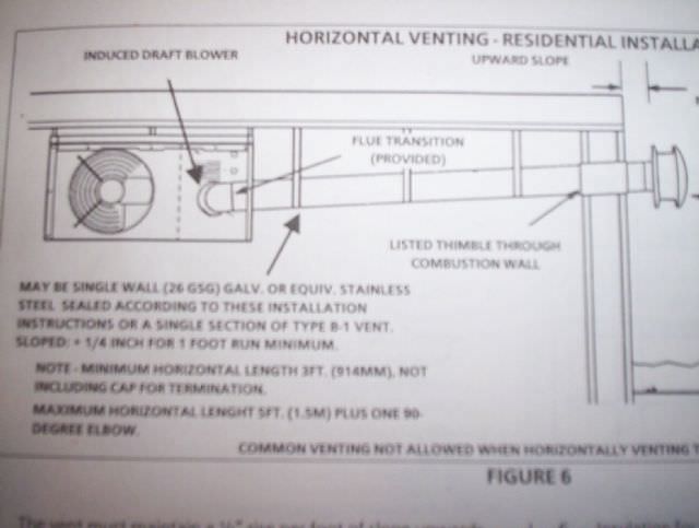

tcfinishing Posted January 26, 2009 Author Report Share Posted January 26, 2009 The spec say I'm allowed to horizontal vent with one 90 deg. and a max of 5 feet of pipe. Click to View 32.75 KB Link to comment Share on other sites More sharing options...
energy star Posted January 26, 2009 Report Share Posted January 26, 2009 I know. But that run must be level from the termination point of the flue on the unit. It may also flow up hill, but never down. So many things can and will go wrong. For one, the heat exchanger will be operating at a higher temp it was designed to. Link to comment Share on other sites More sharing options...

Jim Katen Posted January 26, 2009 Report Share Posted January 26, 2009 Originally posted by tcfinishing What if I change the 90's to Z-flex? No. The vent will still be going downhill. It can only go uphill. Vent it through the roof. - Jim Katen, Oregon Link to comment Share on other sites More sharing options...

tcfinishing Posted January 26, 2009 Author Report Share Posted January 26, 2009 Its an attached garage with bedrooms above the garage. I dont have the option of a vertical venting system. This is why I bought this model of furnace. Link to comment Share on other sites More sharing options...
energy star Posted January 26, 2009 Report Share Posted January 26, 2009 Your only option is to lower the unit. Looks like about 8-10 inches. Link to comment Share on other sites More sharing options...

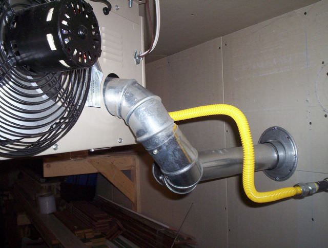

StevenT Posted January 27, 2009 Report Share Posted January 27, 2009 Originally posted by tcfinishing Note: If I lower the furnace to allow for direct venting the unit will be below the garage door header opening. Click to View 47.51 KB If you are worried about it being below the header, I get the feeling that you installed it in the front of the garage... near the door. Can you install it lower towards the rear of the garage? If it turns out that there is no way to vent it safely, use an electric heater, or if you have hot water heat, get a hot water space heater. There are also wall mounted heaters that can be installed lower. Whatever you do, the way it is now, is NG. Link to comment Share on other sites More sharing options...

hausdok Posted January 27, 2009 Report Share Posted January 27, 2009 Originally posted by Bain Sorry, Mike. I've been feeling just the slightest bit craaazy all day. Click to View 21.58 KB © Universal Press Syndicate Cute, there are a few new "home inspectors" running around the Seattle area right now that must have climbed out of one of those. I also thought it might have been easier to install that heater at the back of the garage instead of by the overhead door opening. OT - OF!!! M. Link to comment Share on other sites More sharing options...

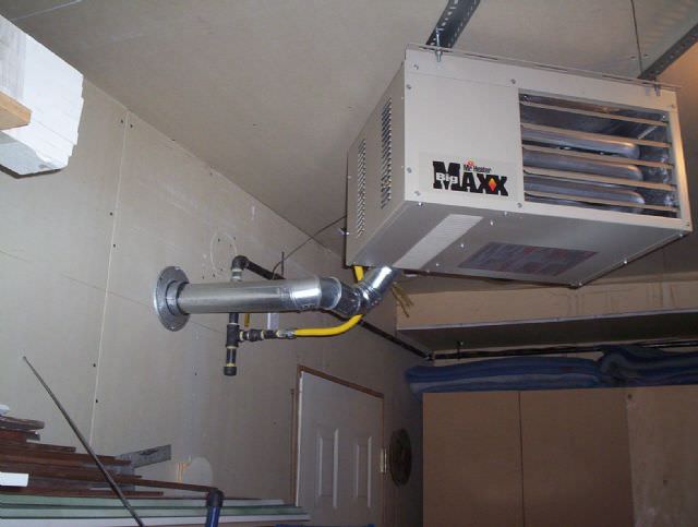

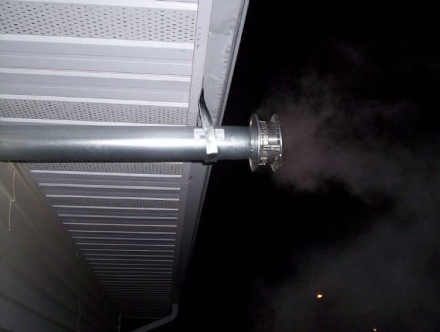

Terence McCann Posted January 27, 2009 Report Share Posted January 27, 2009 Is the heater rated for sidewall venting? Probably should be a gas shut off valve on the line. At least in this neck of the woods we see drip legs as well. Not a great idea to lay the gas line on the flu. Is the flue the same style recommended by the manufacture? Have the proper clearances been observed? He has found out you can't drop a flue like that. Is the flue close to any windows where it terminates outside? Is the flex gas line run in an area by a work bench? Can it be inadvertently struck by something and break? This is where a gas valve comes in handy. Hard piped would be good too but flex is easier to install. Perhaps he can run a power ventor assist for sidewall venting if the manufacture approves. Does he know how to power wire it and run it into the control circuit? We now find out there are bedrooms above the installation. Etc. My point in this is that we can't see everything at the job site looking at one picture on a computer screen. Heating equipment, when installed incorrectly, is dangerous. A professional carries all this knowledge with him when he looks at your home. He knows what can be done and more importantly what can't be done. No one is being mean spirited when we recommend calling a professional. We know the dangers of equipment that is incorrectly installed and we don't want to see Mr. or Mrs. DIY getting hurt. Link to comment Share on other sites More sharing options...
tcfinishing Posted January 27, 2009 Author Report Share Posted January 27, 2009 I have decided that lowering the unit heater is my best option. This will allow the venting to run up and out as recommended by the manufacturer (1/4" / ft).The unit will hang below what code requires so I will weld a protective shroud to protect the unit. the unit heater is mounted in the back of the garage. the out side flue cap is about 15 ft away from the closest window. Click to View 40.05 KB Click to View 34.55 KB Click to View 37.45 KB Click to View 35.51 KB Click to View 31.67 KB Link to comment Share on other sites More sharing options...
