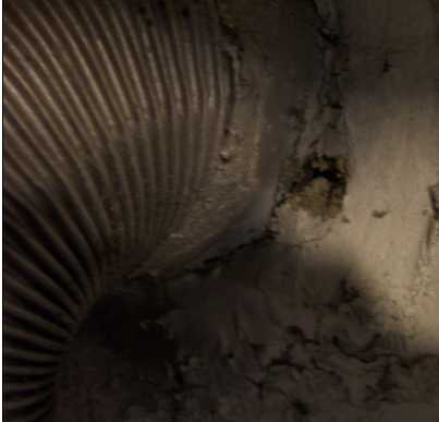

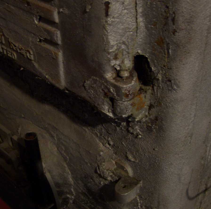

robster Posted February 2, 2009 Report Share Posted February 2, 2009 Does anyone recognize the cement patching on this old boiler. It must be at least 40 years old and I am wondering if it may contain asbestos cement? One picture shows patching around a hinge and where the motor meets the boiler. The other is where the flue meets up with the chimney. Click to View 50.86 KB Click to View 11.55 KB Quote Link to comment Share on other sites More sharing options...

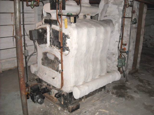

Bill Kibbel Posted February 2, 2009 Report Share Posted February 2, 2009 Click to View 69.88 KB It's very likely that it contain asbestos fibers. Maybe someone thought the silver spray paint would hide it. Maybe someone should have painted the boiler I inspected on Friday. Click to View 47.1 KB Quote Link to comment Share on other sites More sharing options...
robster Posted February 2, 2009 Author Report Share Posted February 2, 2009 ok thanks. I am asking because the boiler is to be removed and replaced with a gas unit, and I want to find out if this poses any risk Quote Link to comment Share on other sites More sharing options...
robster Posted February 2, 2009 Author Report Share Posted February 2, 2009 as far as the furnace that you inspected the other day, the bright side, if one may say that, is that you don't have to wonder too much if it may contain asbestos! Quote Link to comment Share on other sites More sharing options...
Scottpat Posted February 2, 2009 Report Share Posted February 2, 2009 Originally posted by robster ok thanks. I am asking because the boiler is to be removed and replaced with a gas unit, and I want to find out if this poses any risk The only way to be 100% sure is to have it tested. Take some scrapings to a lab that test for asbestos and you will know for sure. Or if you need a special license in Canada or in Quebec to do that, have it done by an appropriate person. Quote Link to comment Share on other sites More sharing options...
kurt Posted February 2, 2009 Report Share Posted February 2, 2009 If you polled every available source, you'd find the complete range of opinions, from "it's fine", to "run for your lives, it's gonna eat your babies!". Have it tested because you should (I suppose), but it's asbestos. Quote Link to comment Share on other sites More sharing options...

robster Posted February 4, 2009 Author Report Share Posted February 4, 2009 Update: The cement-like material where the flue (vent) joins to the cement chimney tested out at 75-90% chrysotile asbestos. In fact it is more of a fibrous-plaster type 'crumbly' mix just below the painted surface and it seems to be more on the friable side, imho ( ie: when you touch it it falls apart). I don't think that this should be touched unless proper precautions are taken. What exactly would those precautions be? When the adjacent furnace was removed last week it was a mess. The furnace itself was demolished and the large steel plates were dragged out the door. It appeared to me that any material removed in that case may have been placed in a garbage bag but I don't think that it had been wetted down. Quote Link to comment Share on other sites More sharing options...

robster Posted February 4, 2009 Author Report Share Posted February 4, 2009 Maybe more than that. The lab described it as a fibrous material. Now that I've had another look, it's actually a more fibrous insulation material covered by a thin coat of a plaster like substance. So from the outside it just looks like cement, but that is just the covering. In some places where the coating is thin, if you press on it it will give. How much exactly is hard to tell, at the time they probably did a good job and stuffed it really well:) Quote Link to comment Share on other sites More sharing options...
