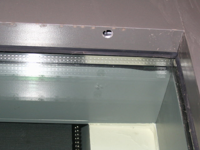

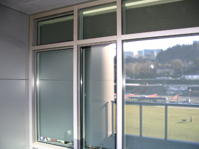

SWagar Posted February 21, 2009 Report Share Posted February 21, 2009 Yesterday I inspected a 2008 condo in a highrise. The potential buyer and current resident complained to me that every morning during the heating season there is major amounts on condensation on the all of the fixed and operational window sills. She said that there are actual puddles and there are drips from the horizontal metal window frames. There is enough water to soak a medium size towel. Se said it was more pronounced in the bedroom but that it happens in all rooms. I did not see the problem, by the time I started the inspection the water had been dryed. She also said it happens in other units but not too many units on her side of the building are occupied yet. From the inside, the windows appeared to be installed properly. I could not feel any drafts nor were there any broken window seals. I know metal framed windows may have some condensation but even if I take her description and cut it in half, that would still be way too much. From the exterior deck I noticed this feature on every window. There were at least two holes in each horizontal metal mmber. At first I assumed they were weep holes. But these were 1/2 to 5/8 in diameter, which seems excessive for weep holes. My thought is they may have been needed for installation and are now allowing air to circulate through the window frames keeping them cold. The constantly cold frames in contact with the warm interior air is producing condesation continually. I could see into a couple of the frames at the holes, they are hollow and uninsulated. Any thoughts? Click to Enlarge 85.5 KB Click to Enlarge 84.36 KB Click to Enlarge 68.73 KB Quote Link to comment Share on other sites More sharing options...

Scottpat Posted February 21, 2009 Report Share Posted February 21, 2009 Those look more like commercial windows. I have seen drain/weep holes like the ones in your picture but on commercial buildings. To try and figure out what is going on you would need to also look at what else could be causing excess humidity in the house. Was the RH high? Knowing the dew point and RH inside the home will help. I would be looking at the type of heating system in the home. Also the number of occupants can have a major impact on how much moisture is in the home. My bet is with the metal framed windows. With this type of window it is common for the frame to get cold and allow for moisture condense on their frames. Not much can be done with the window to stop this, but by increasing the air circulation and reducing the humidity inside the home it could help. Quote Link to comment Share on other sites More sharing options...
SWagar Posted February 22, 2009 Author Report Share Posted February 22, 2009 Thanks for the input. I agree that these are commercial windows the condo unit is in a 30+ floor high-rise tower. I spoke with my client about the use of their exhaust fans, her response indicated that they (2 occupants in 2000 square feet) used them during and after showering. I do not believe that there was an air exchanger installed, at least there were no visible signs of one. The HVAC system was a water sourced heat pump. I mentioned to them that the HVAC ducts, located on the walls at the ceiling, are blowing directly toward the windows. This may be compounding the problem. Not that they could do much about that. My clients said that this same thing happens in other units as well. A owner one floor below actually keeps towels on the window sills to soak up the water. This leads me to believe that the condensation is not caused only by their behaviors but rather something more systemic. Quote Link to comment Share on other sites More sharing options...

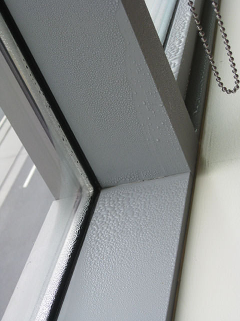

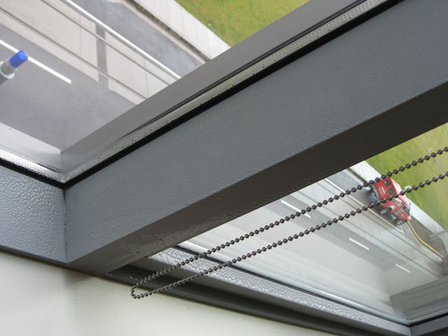

SWagar Posted February 28, 2009 Author Report Share Posted February 28, 2009 I just thought I'd post these as a follow up to my original post. Like I said, I did not see the condensation on the windows. I asked the client to take photos of the condensation. The overnight temperature has not been as cold as it was before my Inspection. I imagine there is more with a 10 degree outdoor temp. decrease. Click to Enlarge 77.22 KB Click to Enlarge 57.05 KB Click to Enlarge 71.87 KB Quote Link to comment Share on other sites More sharing options...
Tom Raymond Posted February 28, 2009 Report Share Posted February 28, 2009 This is just a guess, but I'll bet the builder used cheaper window frames that are not thermally improved. Even with the air exchangers functioning there will be massive amounts of condensation. Tom Quote Link to comment Share on other sites More sharing options...
