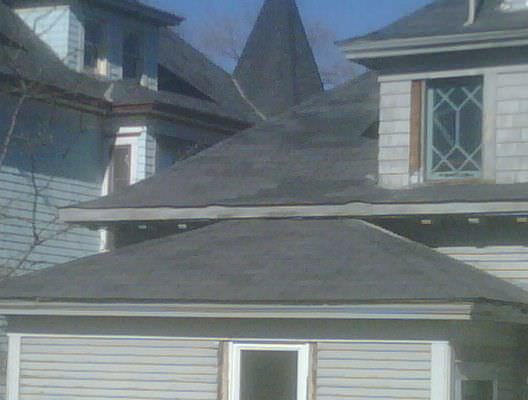

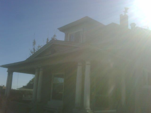

My home:
Is circa 1900, 2 story, the upstairs has some dormer windows, it's the 3 tab asphalt shingles, about 2500 square feet size home. The roof is very steep.
The chimneys need repointing and are missing some bricks that I have. There is a evaporative cooler. The gutters are garbage, need replacing. I believe the roof under decking is all good, it's 3/4 inch solid wood and the gapping is 1/4 inch and less.

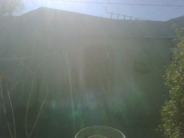

The garage:

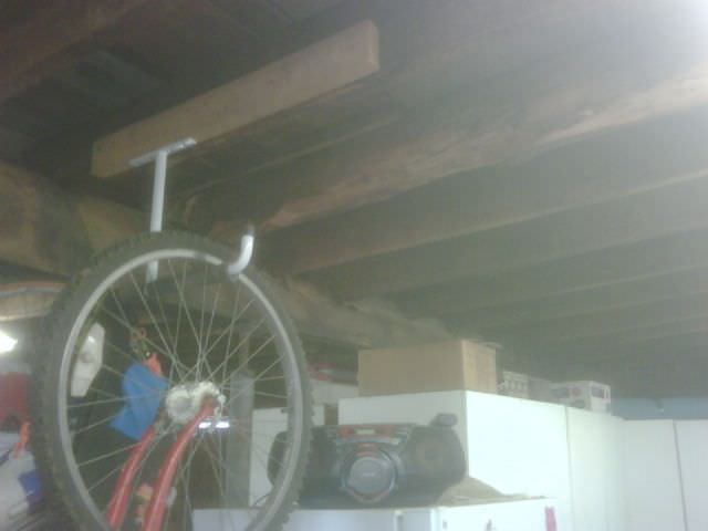

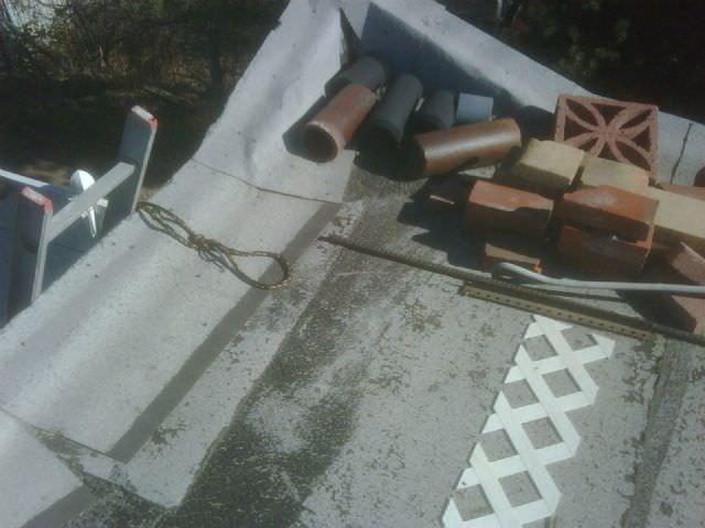

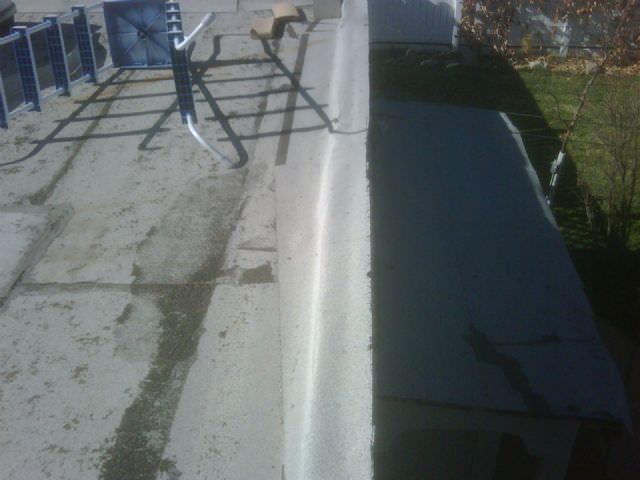

The detached garage is a flat roof, with a slight pitch to the center so the water runs down the center out the back in the alley, there is no gutter. It's basically the size of a 2 car garage, but it's a single garage with a work shop area.
The roof is rolled asphalt and the walls are stucco, the ceiling joists are 8 inch, 16 inch on center and there is a large center beam. The exterior walls are taller than the flat roof, in an art deco fashion where the corners are the tallest (maybe 15" inches taller). The interior walls are unfinished.
Some of the roof sheet decking is bad and the exterior walls top may be too.
Garage Q's
1. Insulation, I really think thick insulation sheeting should be applied under the roofing, I've seen this done on a flat business roof, any tips?
2. I want to be able to talk on the roof as a patio with the addition of stairs on the outside of the garage, what type of roofing is best considering price and longevity?
3. Should I install a wood deck maybe with perimeter hand rails over the new roofing if using as a patio?
4. Is there an exterior edge flashing I should insist on?
5. Is there a roof coating that should be applied to the new roof to extend it's life?
6. Is there a better way to channel the roof valley I should insist on?
7. Is there any underlayment sheeting I should insist on?
Thank-you for any advice.

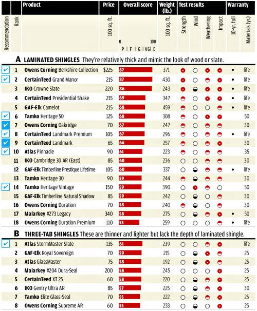

I've been to consumer reports and they found roof price does not dictate quality in their tests. They highly recommend laminated shingles Owens Corning Oakridge or CertainTeed Landmark for their low price and long wear and strength.
They did not discuss flat roofs though.
I like Consumer Reports, but for certain products, their opinions are way, way off base. They often fail to take regional concerns into consideration. Roofing manufacturers, for instance, formulate their products differently for different parts of the country. Colo Springs has a very, shall we say, peculiar climate. Stuff that works well at CR's White Plains lab might not do so well in your area where you've got killer UV levels, dry, dry air, and wild temperature swings. (BTW, I put Oakridge shingles on my own kitchen & bunkhouse roofs, but only because I got them as part of a barter arrangement. They're working fine, but they wouldn't have been my first choice.)
When you find a roofer who you trust, ask him which shingles, in his experience, are the best value in your area.

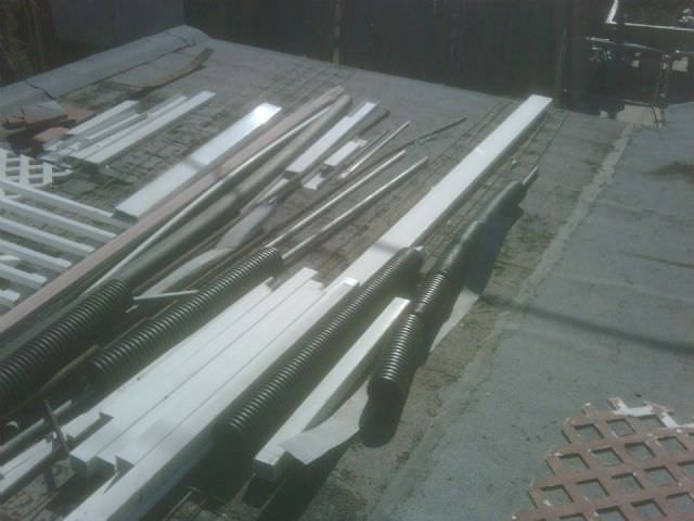

The garage:
Garage Q's
No need to use insulation unless you're trying to correct a poor pitch. If the existing garage roof deck pitches properly and doesn't allow water to pond, there's no reason to add insulation. (Unless you're planning to heat the garage?)
You can view a presentation that I did for the Oregon Association of Home Inspectors on Waterproof Decks here: http://www.oahi.org/waterproofdecks.pdf
If you're going to use the garage roof as a deck, you'll probably need to beef up the joists and you'll certainly need to install guardrails. I'd also encourage you to get a permit. To do this properly will be expensive.
The parapet should really be capped by metal coping with either standing seams or flatlock seams. Don't let them just overlap the metal. The coping shouldn't have any screws driven through its top edge, only through the sides. For a really nice job, they should use cleats on the outside and screws only on the inside vertical edges.
I normally don't like to see roofing run up the interior side of the parapets, but it might be the best way on these little bitty ones.
Depends on what you choose. If you go with mod bit, either torch down or cold process, I'd encourage you to use a granule-coated product. That will work better than any field-applied coating. If you do a traditional built-up roof, use gravel ballast. If you go with EPDM, I have no idea. I see very little of that. PVC or TPO are other choices. They don't need any coating.
What roof valley? Does the garage have a valley?
Depends on what you use. The product will dictate the installation.
Oh, and get all that crap off the roof. Don't use your rooftop as a storage shed.
- Jim Katen, Oregon

You sure I shouldn't rely much on Consumer Reports (I've attached their rating info below)?

Garage
I think I do need to have the roofers put insulation boards down on the garage flat roof because in my area the government recommends R50 in the attic and if I insulate the 8 inch roof joists too, I'll still be short the R50.
And I'm always so amazed at how just a thin styrofoam cup keeps coffee's heat contained.
I see for instance Home Depot has 2 inch R13 aluminum sided insulation boards. I wonder if another more ridged board may be needed on top of that to make sure walking on the roof does not dent the underlying R13 insulation boards..
I do plan on finishing and heating the garage in the future and it's hot in the summer too so this is the opportunity to insulate, I'll take it.
I did watch your waterproof decks presentation, very good, a bit over my head but I get the picture that a full time walkable roof is expensive, and complicated for waterproofing.
The garage has 2 x 8 inch roof beams 12' long on 16" center. I thought they'd be strong enough for a deck.
I guess it'll probably be either the mod bit or built-up roof on the garage. I don't know the cost difference and other pros and cons. I do and don't like the idea of loose gravel ballast on top. I imagine it keeps the sun off therefore many times extending the roof's life...hmm couldn't it go on top of either roof types?
Yes the garage has a center valley I guess you'd call it. It's where the outside of the roof slopes down to the center and also towards the alley-back of the garage. The water then drains off the center backside of the garage and into the alley. The garage's center beam is lower than the walls. Old design I guess.
Sorry for using the garage for a storage shed. I'm working towards not having anything up there as I finish projects, but storage is short.
What's with the zombies Bill...? LOL
Damn, I wrote a book again. Sorry. I'll appreciate any reply and this should wrap up my roofing project.
I hope this discussion will help others in simular situations.
I'll donate $40 to your favorite charity if you let me know.
I was mesmurized at how some of the cheaper shingles outperformed ones four times the price.
As I said, I like Consumer Reports and I find their articles helpful about a lot of things. (BTW, I'm quoted on page 33 of that issue.) But I was disappointed in their shingle testing. They didn't mention the fact that nearly every manufacturer varies their product formulations by region. The stuff that they bought for their east coast testing facility is probably not the same stuff that you're going to buy in the high elevations of the Rockies, even if it carries the same brand name designation. I've also never been impressed by accelerated ageing tests. I simply don't believe that they bear very much relevance to actual ageing in the field. Also, where's Pabco in the lineup? They're a popular manufacturer and their products do very well in the west.
Finally, they don't mention what is and isn't statistically significant in their "overall score" column. For instance, I'm very familiar with CertainTeed’s Presidentials and with Owens Corning's Oakridges. Both are great shingles, but they're each in a different class, they're simply not comparable. Presidentials will still be performing well when Oakridges are landfill. Yet CR rates them "69" and "67" respectively. Something's not right with that.
I'm generally surprised how fragile shingles are and how they don't last longer than they do for all the work involved in reroofing. I guess they want us to keep paying for roofs milking us like cows. It really seems rediculous to me.
Well then install Presidentials or Grand Manors. You'll never have to install another roof again.
Will a roofer really know which shingles will last for many decades? I mean my imagination says that for the most part, without testing shingles like in a lab, the only other good test is time...and by then the shingle company no longer offers the same shingles.
Not really. Some companies have been making the same shingles for decades. Also, as a general rule, asphalt roofing shingles are getting better as the manufacturers learn what does and doesn't work. There were some real rough spots in the late '70s and '80s, when some radical changes in formulations had some disastrous consequences, but everyone learned from those times.
The manufacturers are just throwing together concoctions of material and coatings and layers, and maybe moreso much marketing and incentives.
I really don't know what I'm getting for by paying extra dollars per bundle from one company to another. I don't know where the sweet spot is and wonder if my roofer will being under the same influences.
Consumer Reports shows a good sweet spot with the Certainteed Landmark or Owens-Corning Oakridge.
Well, yes. But that's a sweet spot with regard to their tests, whatever those were. That's certainly a good beginning, but it doesn't necessarily translate to a sweet spot in the real world.
I make less than 40K a year and I'd like to retire instead of working all my life. I'm not one to skimp where it makes a difference but I don't want to throw money away where the difference is not worth it. From consumer reports it looks like Owens-Berkshire Collection $220 and Certainteed's-Grand Manor $215 - top shingles are very over priced for a bit more performance although their warranty goes to life instead of 30 years (not sure if many people will really benefit from the difference in warranty length).
Looking at their ratings (it shows there is not a very good correlation between price and quality), do you think there is any value to the ratings?

Garage
Don't use the stuff from HD. Your roofer will know where to get insulation boards made for roofs. Depending on what you use for a final roofing surface, you might need to use fiberglass panels over the foam boards. Also, if the pitch of the flat roof is questionable, tapered insulation boards can be a big help.
Borderline, depending on the species & grade. In reality, as long as you don't have a bunch of linebackers dancing the Macarena up there, it'll probably be fine.
Gravel works great, but it's heavy and it's not particularly well suited to walking on. If you go with a built-up roof, consider a granule-coated cap sheet. There are lots of other choices. Talk with your roofer. He'll have distinct preferences.

Consumer Reports "testing" on shingles was one of the stupidest and most misleading articles I've ever read in their publication. Yes, I read it and pay attention on some stuff, but when a company is charged with "testing" products and commodifying the information, context and usefulness gets lost. And, modern roofing design, materials, and methods need to be looked at as systems, not single components. One can take a cheap shingle on the right roof, detail the installation with specific other materials and components (IWS primarily), and have it outperform any of the mfg's. top brands. Consumer reports is only addressing a single aspect of the job.
So, a lot of this stuff goes to the bane of us all, marketing.
Honestly, I wouldn't pay any attention to about 90% of what they had to say in that article. Their world is not the real world; it's an artificially accelerated world, which means very little in my/our world.
Oh, and use granulated modified bitumen. Just do it. It's the stuff for small residential flats with all their little details.
