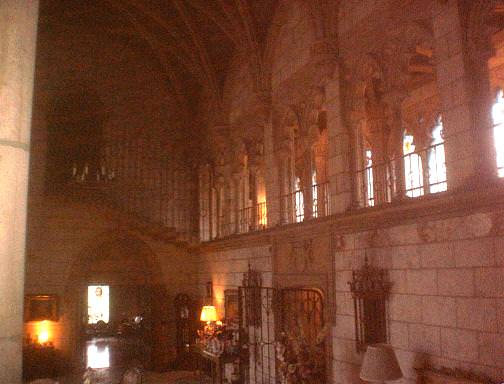

Bill Kibbel Posted September 26, 2004 Report Share Posted September 26, 2004 Jim, I agree with you and Steve but I rarely encounter it. I don't think it was common practice here until the twenties. Could it be possible that it had been applied after original construction? This is the youngest home I have inspected in recent memory. The "Hall" of a 1928, 25,000 sq. ft. residence FD820026.JPG 33.38 KB Quote Link to comment Share on other sites More sharing options...
